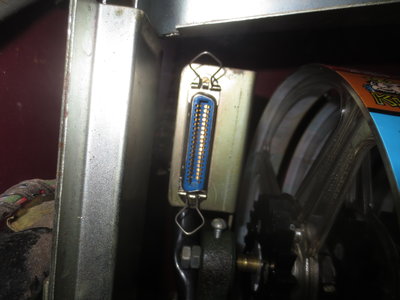

Hi Jim hope all is well, i have taken a photo here of the end that the cable i tested plugs in to. the plug is recessed into the machine cabinet how it comes out is anyones guess, lol i certainly dont know
Anyway here are the results of the pins that i tested, going from top to bottom
Pin 1 registers at 0.00
Pin 7 registers at 0.00
all other pins ok and dont move off 1 on the multimeter
I am hoping thats good news indicating that the fault lies somewhere on the other side of that connector, if i have to take that connector out to look at the wires how do i do that, lol sorry my inexperience shines through again

Oliver It looks like either 1 or 7 is where the problem lies. To take the plug off there should be at least two screws in the back holding it onto the mech. remove them making sure they go back exactly as they were taken off so as not to incur another short. Have you put the lights and sockets back together? Tracing the wires on the mech should be a lot easier than in the cabinet. Keep up the good work. Later Jim

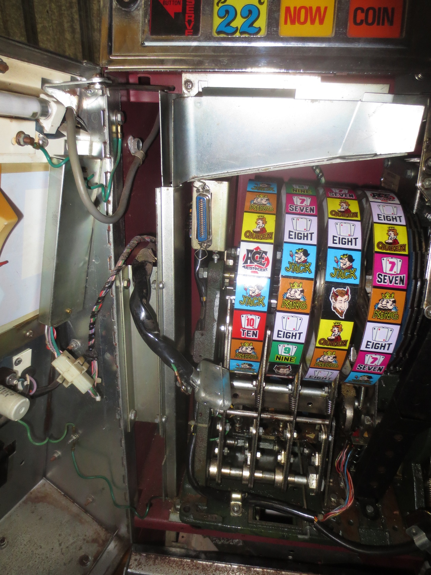

Well back to the machine, i took another pic seems from last time there are faults on both connectors and last time i also pushed the bottom gold contacts out and have to try fix that, well anyhow which cable should i start investigating and where do you think i should start with that, i could start with the cable in the mech, pull the whole mech out of the machine and start tracing faults there, or the cable in the cabinet any idea where to start, i am going to be very careful with what i do otherwise i just make things worse unfortunately, lol
