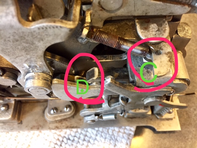

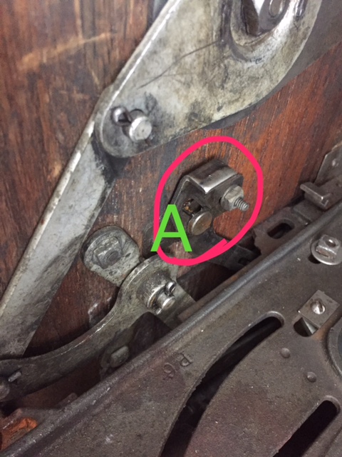

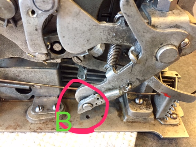

OK can't seem to get the mint vender to operate. I can set the trip lever "A" manually with the mech out of the cabinet.
The problem is cam lever "B" barely touches trip lever "A" but you can see a long wear mark on top of trip leaver "A". So how do I adjust cam lever "B" to rotate clockwise and forward. Do I back off lock nut and bolt "C" and move the pointed rod forward. If so how far can I go...looks like lots of cam thrust in this area!!!!

Thanks Watlingboy for your PM. You were correct....I moved the sub-base forward 3/16" and now the mint vender works as it was meant to be.
