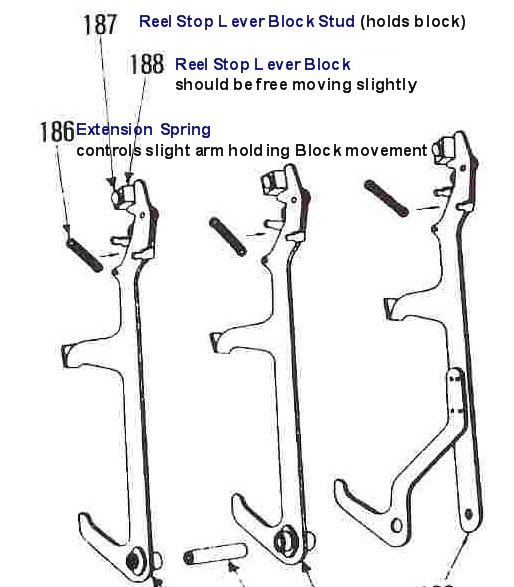

Postby MONTI » Sat Jul 27, 2019 12:56 pm
Shane!
Kind of hard from the angle of the photo and lack of clarity to see what you have there as a reel stop assembly but I believe what you should have is what is pictured below and if you do there should be slight movement of the stop block as it should pivot slightly controlled by the extension spring shown which if not would be causing the wear as view-able in the photo!
Sometimes these blocks get gummed up from dried grease and do not move!
If the reel stop lever is removed you should be able to clean it and rotate it as you mentioned!

Re: Reels bounce off brakes (Bursting Cherry)
Postby Shane » Sat Jul 27, 2019 1:35 pm
i think my reel stops are an older version than the ones in your picture. My Black Cherry reel stops are more similar to your pic - the blocks have a little bit of give to them creating a smoother, quieter stop.
My bursting cherry blocks are fixed - unless all three are really frozen. The blocks do not seem to have any give. See picture.
Shane
Shane
Posts: 116
Postby MONTI » Sat Jul 27, 2019 2:28 pm
Well in that case it should be able to rotate 180 degrees like you mentioned but to keep it fixed in that position if it is not tight when you rotate it you may have remove the arm and either press the rivet holding the block using the flat part of a vise, the anvil portion and a ball peen hammer striking the rivet straight on to the rivet or using the vise jaws to squeeze it a little tightening it up but make sure the angle to the star on the reel hub stop is flat to the block like the one in your picture to prevent bounce!
Sometime if you have the proper kind of vise grips with two rotating heads so they will press flatly and evenly you can do it in place!
The stop block that was worn was probably slightly off causing the wear!
The wear could have also been caused by the reel brake being so loose that the reel was spinning to fast when the stop block made contact!
Also, being a metal to metal contact point a little grease may help as well, on the stop block and on the star!
I think I got that all right, if not somebody jump in and correct me!
Postby Shane » Sat Jul 27, 2019 2:37 pm
Thank you, Monti. I will give that a try and let you know how it works...
Shane
Shane
Posts: 116
Postby Shane » Sun Jul 28, 2019 3:45 pm
i don't think that block was meant to move. I torqued on it pretty hard and it did not budge. I'm afraid I will damage it if I keep going. Going to look for a replacement lever.
