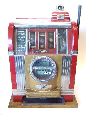

Here's some items from my WTF file which might be pertinent. According to Bueschel, the Play-Boy was nothing but a Commander without lemons and a sticker on the reel window advertising that fact. In "Lemons, Cherries and Bell-Fruit-Gum" he reprints an illustrated trade ad on page 157 which clearly shows the distinctive look of the "Knockout" reel window, top castings and monogrammed front casting, noting in a sidebar that KO's came in "No Lemon" models.
On the basis of this information, how would you identify these Caille slots?

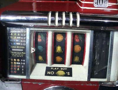

Postby marsonion » Wed Jan 18, 2012 11:17 am
Bueschel on Caille Play-Boys-- the cabinet in the picture is indistinguishable from a Commander. Only the "no-lemon" reels and window sticker would indicate it is anything but a Commander.

Thanks for the additional information, marsonion. From all appearances, my machine looks exactly like the one in the picture "knockout1" , complete with slanted coin entry "box" on top of casting, except mine is a 5 cent machine, and some of the trim chrome is different. (no upper full width chrome above the reels, and no full height side chrome on either side of the jackpot window).
The payout card is the same, as well as the paint around the reels. I do not have the "no lemons" sticker, though it does not have lemons on the reels. also, no chrome above the payout tray. Like you mention above, it looks like the grooves above the payout tray were painted over.
