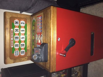

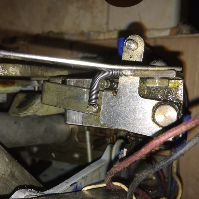

Hello
I have a mills jumbo parade that I have been tinkering which I am trying to find some info as to why it is stuck in free play mode when the plate on the back is labeled as a pay machine.I have noticed that there is just one spring that keeps the switch in free play mode instead of a spring that would help with bringing the switch back until a coin is dropped in and then release it to be played. I took the spring off and moved the switch over to the left and the machine could not be played but when you dropped a coin it there was a kicker that kicked the switch over to be played. I just need to figure out the spring situation and I noticed several places for springs to go on that switch. Any help would be appreciated in getting this thing back to pay only mode. I am also have some problems with coins being rejected to where you would get your payout. I would imagine it is just a matter of adjusting the mech in the chute area???????

Here is a pic of the machine......

Postby stephen » Tue Feb 10, 2015 4:36 am
Does anyone have pics of the mechanism?
