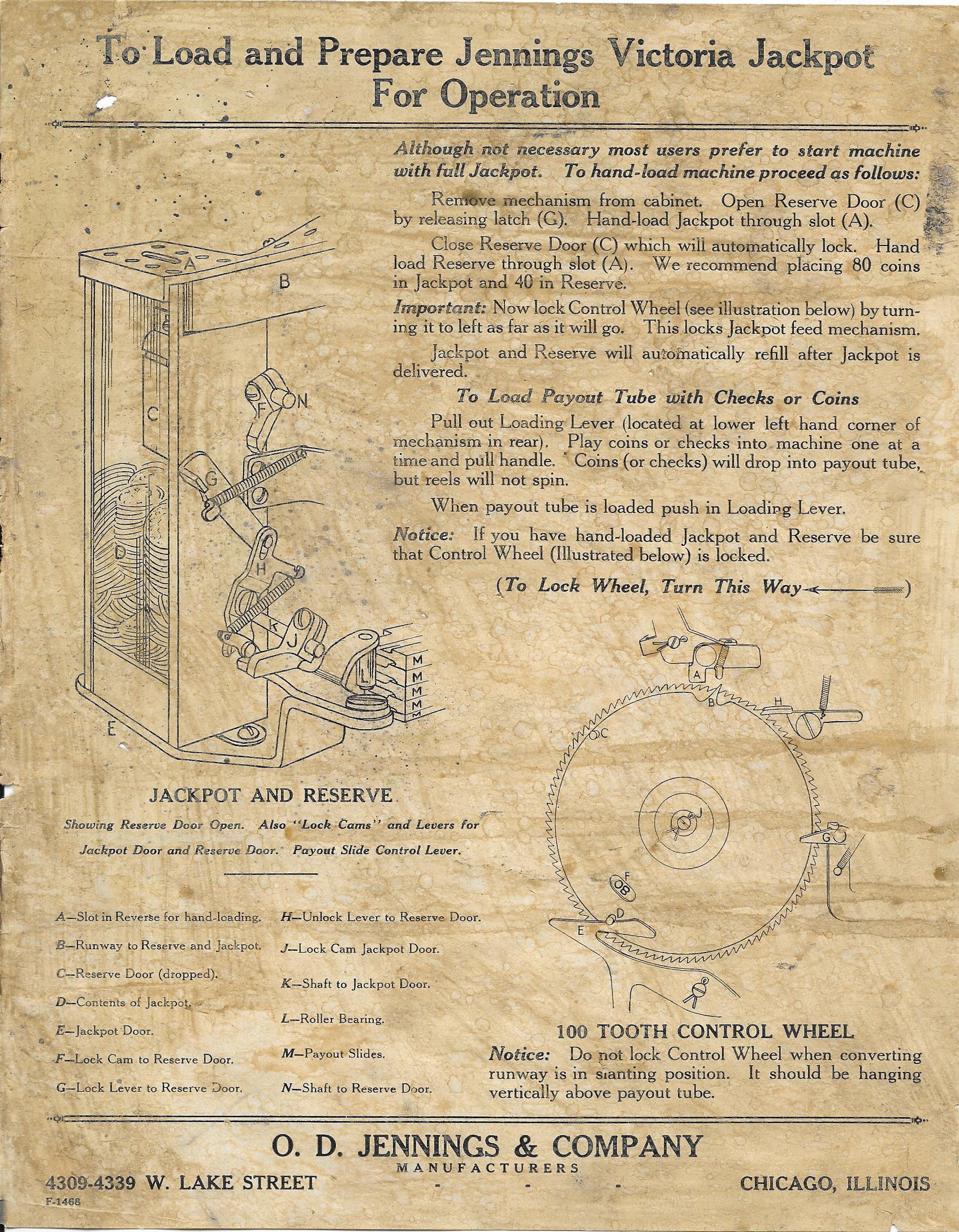

Postby JHSS-1944 » Sun Dec 11, 2016 11:20 pm
oldslotman , thanks for posting these on the forum. most have never seen this type of Jennings ,let alone the instruction paper. I send a copy of this ( #1347 ) to him a little bit ago & also a variation of the same = "F-1468. seen here. 1 of 2 originals pulled off the back door years ago.

Hey guys thanks for the backndoor sheets! I will take them in digital format to Staples or some
Place like that who can make high resolution copies for me. Anybody else have one of these I can ask
a few questions of on a few parts I cannot see a use for? :mrgreen:
