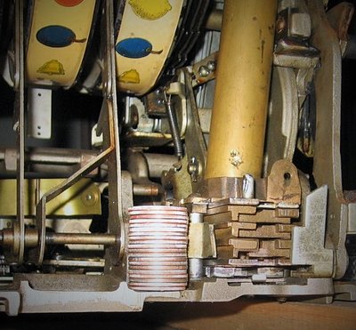

Those payout slides look kinda short for a fifty cent machine. Maybe a foreign coin conversion. Looks like a pretty short stack. Don't look to be 20 coins high.

oldslotman wrote:Those payout slides look kinda short for a fifty cent machine. Maybe a foreign coin conversion. Looks like a pretty short stack. Don't look to be 20 coins high.
. . . here's a close up of the slides. That's a stack of twenty half dollars to the left:

The part of the platform that you have the halves stacked, is lower than where the slides are. Also, don't forget
about the safety slide. Your best test, is to load up the tube & slides, and play the machine. Stop the clock, and
set each payout line. If you have a set of English penny slides, it will start to short the payouts after the 2 Cherry.

There appears to be a 1/4 inch shim on top of the payout slide posts. I believe the posts themselves should be the height of the 20 coins. Slides maybe correct though with that shim in there.

OldSlotMan / SlotDynasty -- thanks for pointing this out. Just tested . . . ALL payouts are correct!
Jackpot dumped twenty coins, and the top slide retracted as well (foto).
