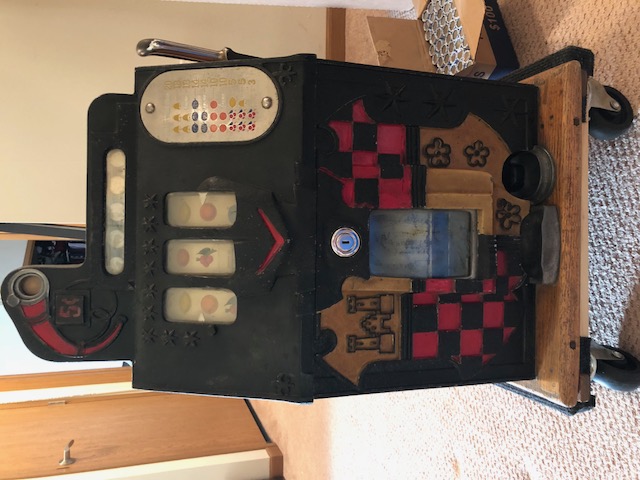

I purchased an old Mills Castle Front (black) with hand load jackpot. Everything checks out on it, in terms of being a true machine- (serial number on machine and wood base match, has the proper number of rails behind coin escalator, has pump, etc...) Ultimately, I'll end up having it restored at some point, but am trying to learn about it at this point.
At this point, what i'm confused about is the hand load jackpot- From what I understand, the lock cylinder on the front of the machine is to be removed and then I load coins (nickels) in this case, thru the tube, which will load the jackpot up. I ran 3 rolls of nickels through it tonight, to see how it played and paid out (paid out perfectly every time). On 2 or 3 occasions, after pulling the handle, while the reels were still in motion, the machine would deposit a nickel into the jackpot bin on the front of the machine.

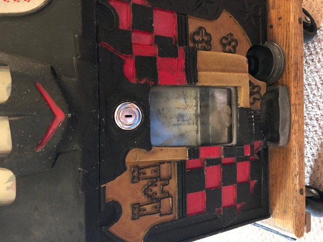

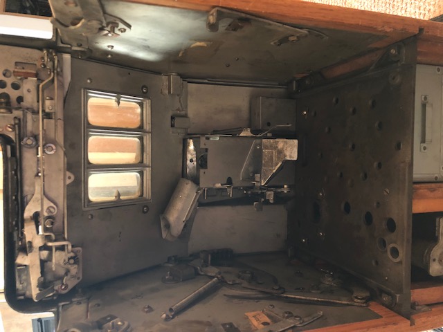

Hmmm well that is quite interesting. I’m going to venture a guess, and that’s you have a regular self loading jackpot with an option to load from the front if needed. Would make sense as operators would lose money if the jackpot wasn’t full. Could you post photos of the jackpot from the front and from the back(with mech removed)
I have never seen such a thing but it’s possible that someone made that happen, I don’t think this was ever a factory option but you never know.

Here are some pics of the machine.

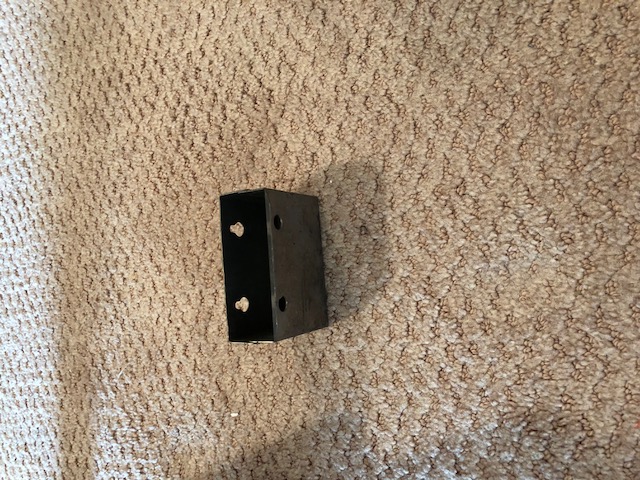

Upon removing the mechanism, I found to the right of the jackpot, a little silver box that appears to be detached from somewhere in the machine. Any idea what this may be or where it may go? The machine works perfectly and pays perfectly, so whatever it's purpose is, it doesn't seem to be interfering with the operation of the machine.
Thanks in advance!

That's the "slug cup" that mounts on a couple of screws on the top right of the inside of the cabinet (facing it from the rear).
I catches bent coins and slugs.

imyourcaptain is probably right, the operator put the self filling parts on the jackpot. Originally there would have been a plate separating the coins showing in the window and the diversion on the back of the jackpot to the cash box. There should not be a reserve jackpot and linkage on the jackpot. Mills put this machine out in the late 1930's, sometimes referred to as the last Castle Front. The main background was painted black with the checker board background being gold and the checkers painted red. I have restored several hand load Castle Fronts and presently restoring a nickel one at the present time.

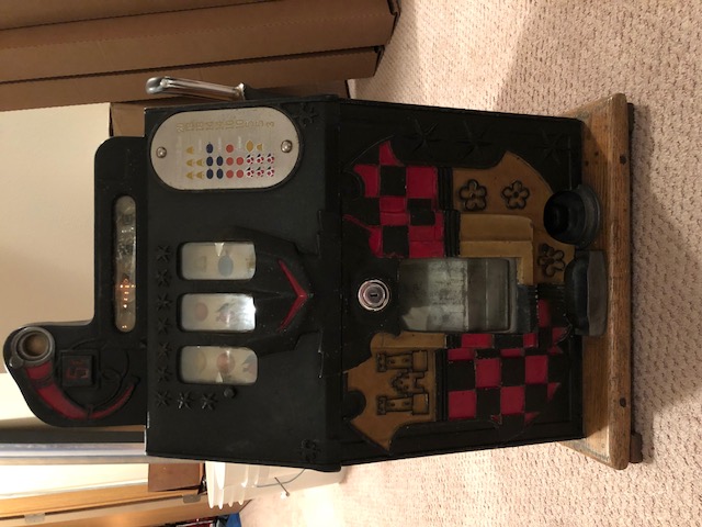

Looking at the pictures again I see the plate is in the jackpot and the reserve parts have been removed. Without seeing the top of the jackpot I can't tell what is happening, there should be a physical separation between the coins in the window and the inside back of the jackpot. Also I see the checker board background on your machine is painted white instead of gold, the machine obviously has been repainted.

My pictures aren't the best- the checkerboard is red and black squares, and the other two portions are painted gold.
Last night, when I was playing nickels through it, once it filled up the reserve that the small payouts are made from, it started to direct coins into the jackpot window, in the front of the machine. Then once that was about half full, I could hear coins going into the coin vault box in the bottom of the machine.
If the jackpot has been altered, I'm guessing that it wouldn't be too hard to restore it back to what it should be?

It sounds like everything is correct.
