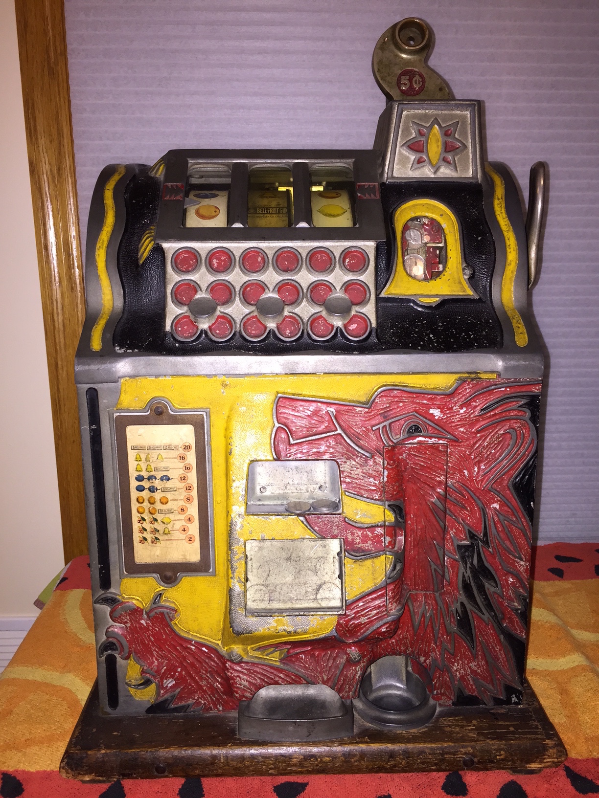

Re: A rookie's questions: comparing two Lion's Heads
Postby djvanyel » Sat May 09, 2015 6:54 pm
Nice machine. Thanks for the photo example of a completely unmolested one. I can see the small details where both of the example machines are close, but slightly different. I noticed your reward card has the symbols rather than the plain text. I guess there must have been two styles of reward card printed for this machine?

Postby YourBestBet » Sun May 10, 2015 9:03 am
The award card on my machine is original but most likely not to the machine. Here an example of a Mills Lion Head I found in the automatic age magazine:
