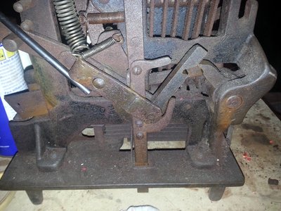

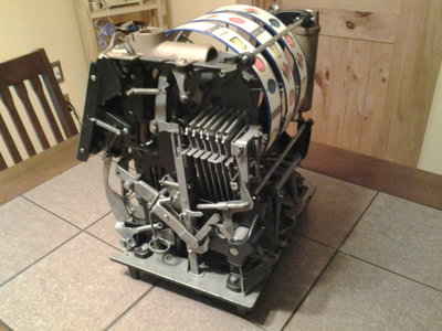

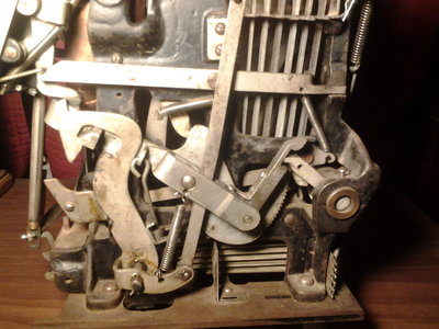

As far as your other issue with the kicker, these are pictures of one of mine, you can see in the fist picture the hook shape part right behind the plum on the third reel, that part engages the reel disks as the mech is cycled holding the reels from spinning, the kicker will now load up with the spring tension instead of just flopping forwards like yours is doing, as the operating fork snaps back that hook shaped part releases the disks and only then the kicker should move forwards sending the reels spinning.
Now there are several different stile mechs with different components that perform the job of holding the reel disks.
