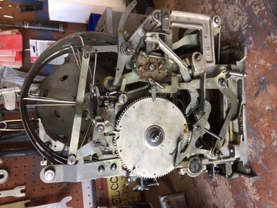

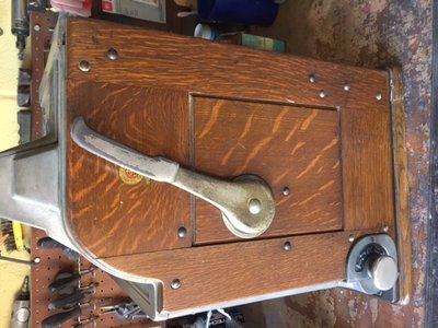

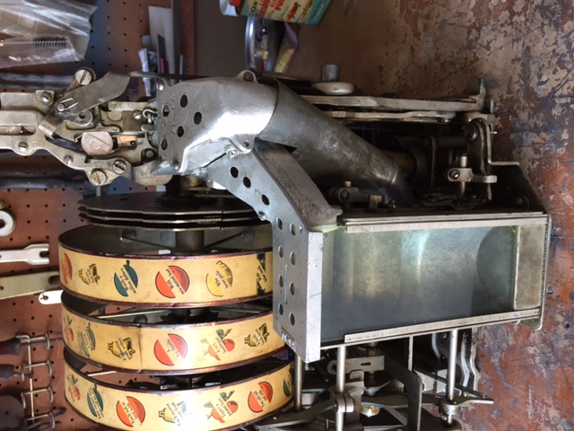

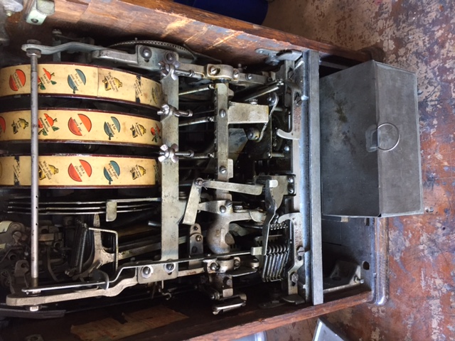

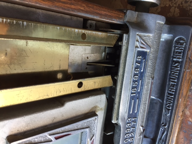

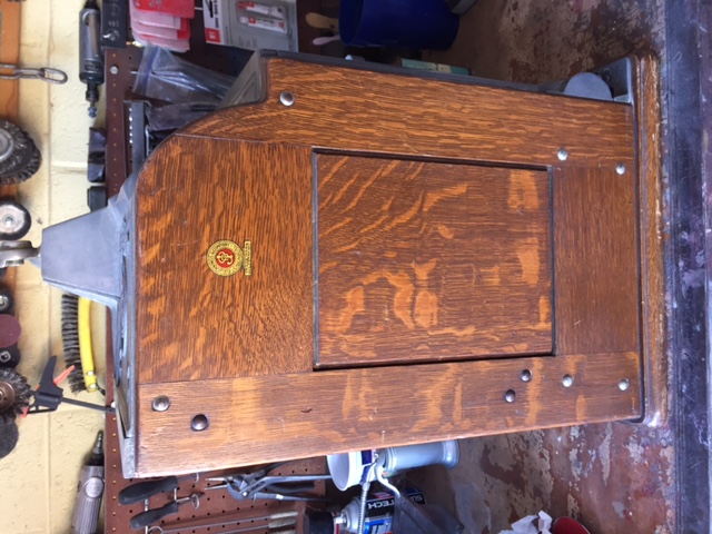

Got the email last evening and responded within a minute only because it was 15 minutes from my house. The sellers son in California posted this for his parents here in AZ. I emailed and spoke with hem and he put me in touch with his father and we set appointment up for today'. Don't know much about this model other than it is early 1930's maybe 1931 so any input would be great.

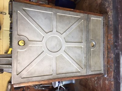

Jennings New Model Victoria in nickel denomination all original except for locks and from what I can see pretty much all there too. Un molested not refinished and all dirty and gummed up inside and jammed too boot! Coin jammed machines are usually an easy buy. One shoulder screw was loose, once I cleared the coins and tightened the screw it played and payed. Needs a thorough cleaning and lube but that's it! Santa came early.

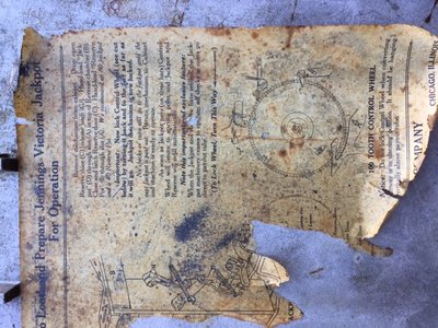

Please any info on this machine would be great once I saw that big gear on the right side of mechanism I almost had a stroke luckily the instructions were still semi intact on the back door.

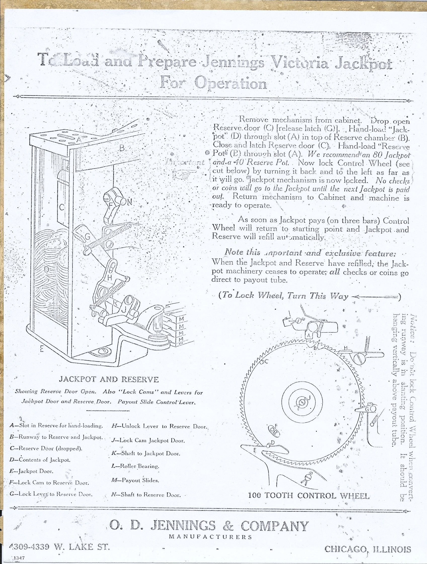

oldslotman , thanks for posting these on the forum. most have never seen this type of Jennings ,let alone the instruction paper. I send a copy of this ( #1347 ) to him a little bit ago & also a variation of the same = "F-1468. seen here. 1 of 2 originals pulled off the back door years ago.

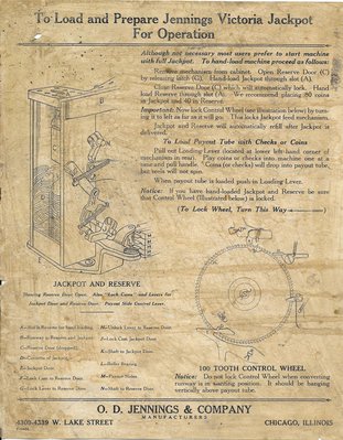

let me add the other one as IT is a little different than my other or what you posted. why the variations = ????

Hey guys thanks for the backndoor sheets! I will take them in digital format to Staples or some
Place like that who can make high resolution copies for me. Anybody else have one of these I can ask
a few questions of on a few parts I cannot see a use for? :mrgreen:
