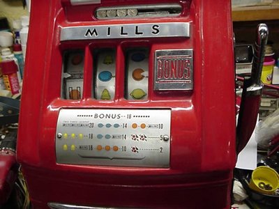

hello all- i'm picking up a "new to me" antique slot tomorrow- the previous owner (old guy who's owned it for a long long time) only knows that it's a mills bonus but no clue of the year or actual model.
i'm having a tough time finding an exact match- I've found plenty of 5 & 25 cent machines, but not many 10 cent- and the 10 cent slots I find don't match exactly.
the slot appears to be a legit antique (but please educate me if I'm wrong) the slot performs beautify. I'm assuming its been repainted because I can find anything on google this color.
he's also giving me the original users manual. was also wondering what a fair price to pay for it is? thanks in advance.

First off NACC, Welcome to the forum !
well , I guess if you had to pick a machine to start your collection / enjoyment ,a Mill BONUS is a very good choice.

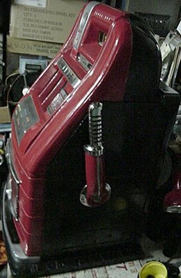

Correct, it's been repainted at some time. from the factory most (if not all) were Burgundy & Gold color combination (which is a great color match). may have been done by a casino after a bit of play on it, or a past "collector".
for "value" , better in the original colors but,it looks good , no need to "fit" it if you don't need too. first sold in 1947 (undated mills order blank form), for $230.00 (5 cent was $5.00 less,& 25 cent was $5.00 more). actually the price was for 25 machines or more. sold 47/ 48/ 49/ 1950 (at least).
I can't really give an estimate price. very popular machine to have,prices vary depending where you look,ect.
will re look at your photos to see IF any "odd" about it.

Nice Mills 10t Bonus, colors look great

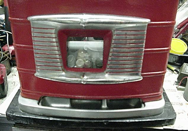

Normally you only see 5 coins in the escalator so I wonder if this is a converted roll away escalator.

The escalator really looks to be changed into a rollaway. Otherwise, the coins would have a space in between each coin or it is jammed.

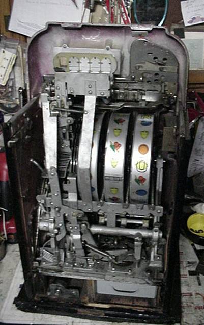

I take some pics tomorrow and post- I have several questions regarding the internals.

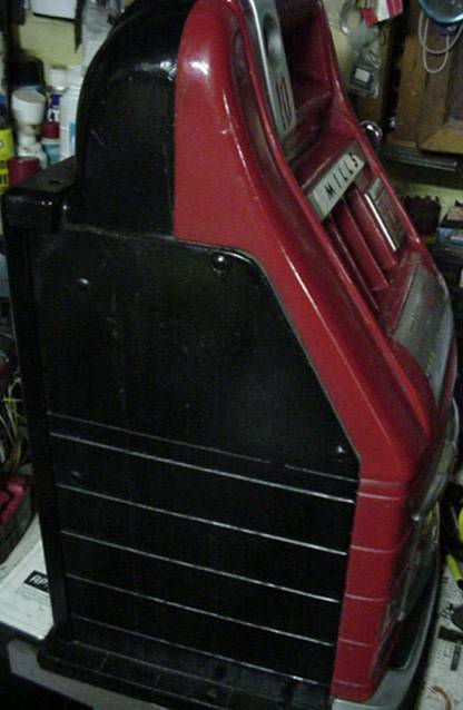

the left wood side (without the lever) is split from top to bottom. the metal side plate seems to be keeping it all good and tight.
I'd really like to strip the black paint (probably lead paint) off the wood and bring back the nice wood look to the exterior. maybe glue & clamp the split?

I didn't notice the "roll away conversion" on it. I should have ,2 of my 50 cent machines are like this. not sure if this is an issue with the thin 10 cent coins or not. no big deal to leave or replace the 2 pieces.

well it's up to you on the wood paint. yes wood glue & a few clamps will do.

I does appear you have a 'roll-away' escalator, as there are no separating travel fingers between the coins. The machine
would not have left the factory like this, and was most likely converted by an off-site operator, or sometimes the Casino
shops themselves. It is an easy fix, to get back to original. If you have rebuilt automatic transmissions, then this will be
a 'piece-of-cake'. So, it's time to hop off that "Can-Am", and get started on the "Bonus". :D
