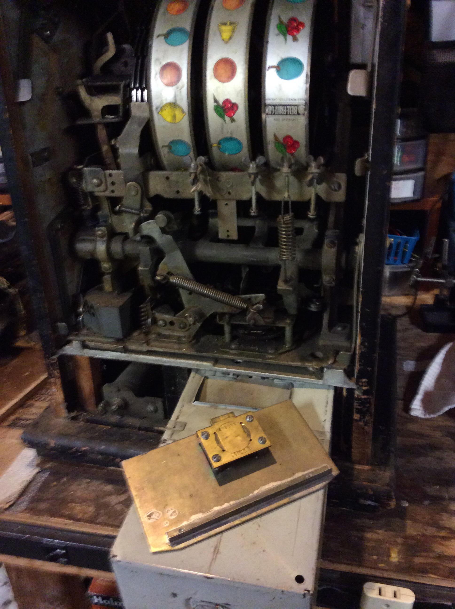

The machine's in a little worse shape than what was listed as "minor work" needed but overall it appears complete. I have one original Mills lock for the cash box lock but missing keys. I've already shipped the lock to Dave B to re-key. I'm also getting a new set of escalator springs and getting GREAT help from Monti. The back door lock was not only drilled out, but literally encircled and cut out! I have no idea why someone would do that. I installed a new lock and epoxied a big washer painted black to cover the huge-ass hole. Anyway... I'll probably post the "fix" stuff more in a different area but wanted to tell everyone my "fantastic for me" find.

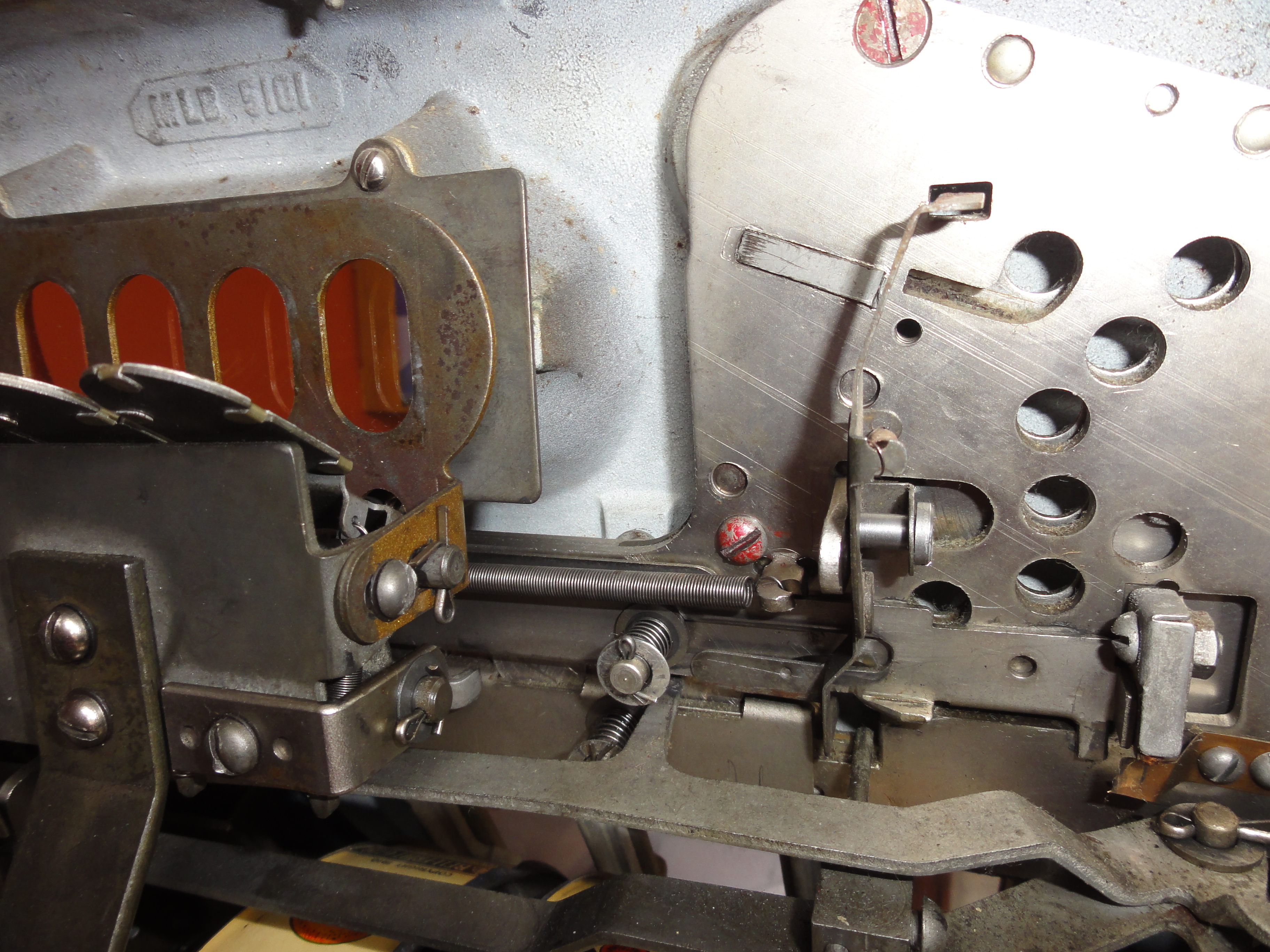

I'm slowly making progress on the machine. I sent my original Mills lock to Dave and now I have a nice "new" lock for the back. I put the replacement lock I bought for the cash box plate. The new escalator springs arrived and am now painstakingly installing them thanks to help from Monti. This is probably very easy for seasoned slot people, but all my existing springs were torqued and the diagrams from both Mills books I have are blurry to read the spring number and part number they attach to. I'll post some progress pictures soon.
UPDATE:

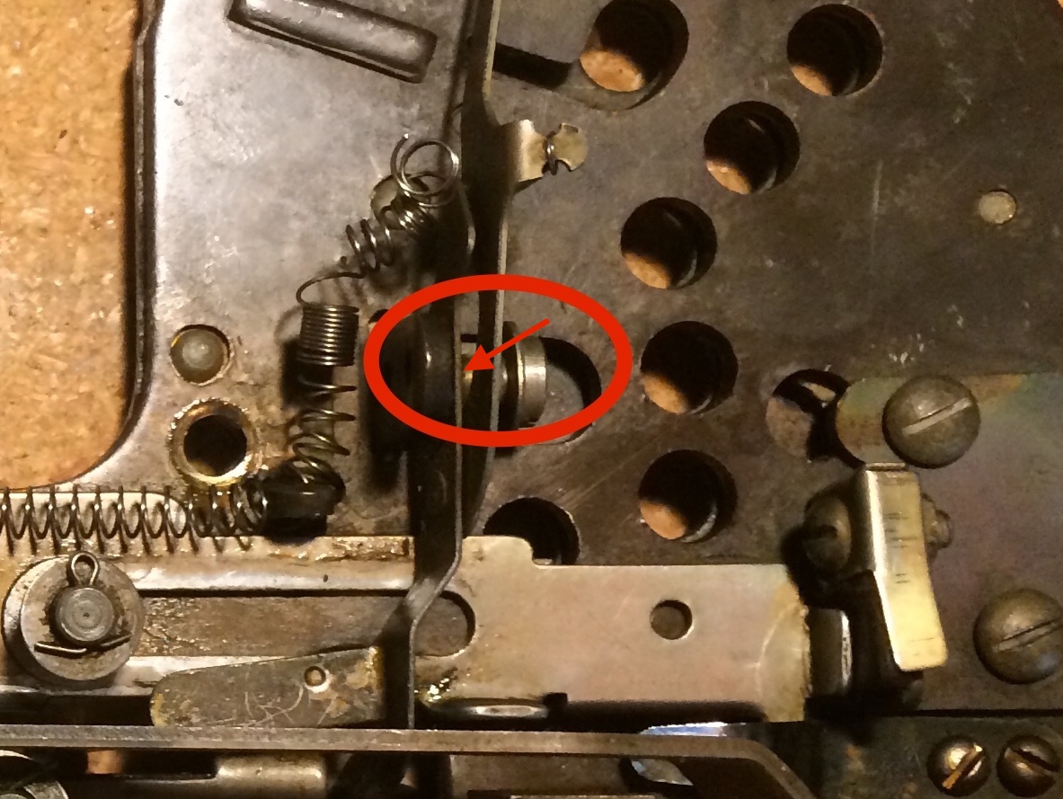

Springs are in! I have a few issues at first. I hadn't fully tightened a shoulder screw on the left (facing the back) and nickels jammed, then fell out upon removal of the escalator. :x
I tightened the shoulder bolt and was back in business after bending the anti cheat pin thingy (sorry for lack of better term). It wasn't getting pushed back out of the hole after each spin. Now it's fine. The machine seems to work, after at least 50 plays so far. The only thing is there seems to be too much space between another shoulder screw and that anti cheat pin. The MLB # is 2875, for that screw. Here's a shot of the area I'm talking about.

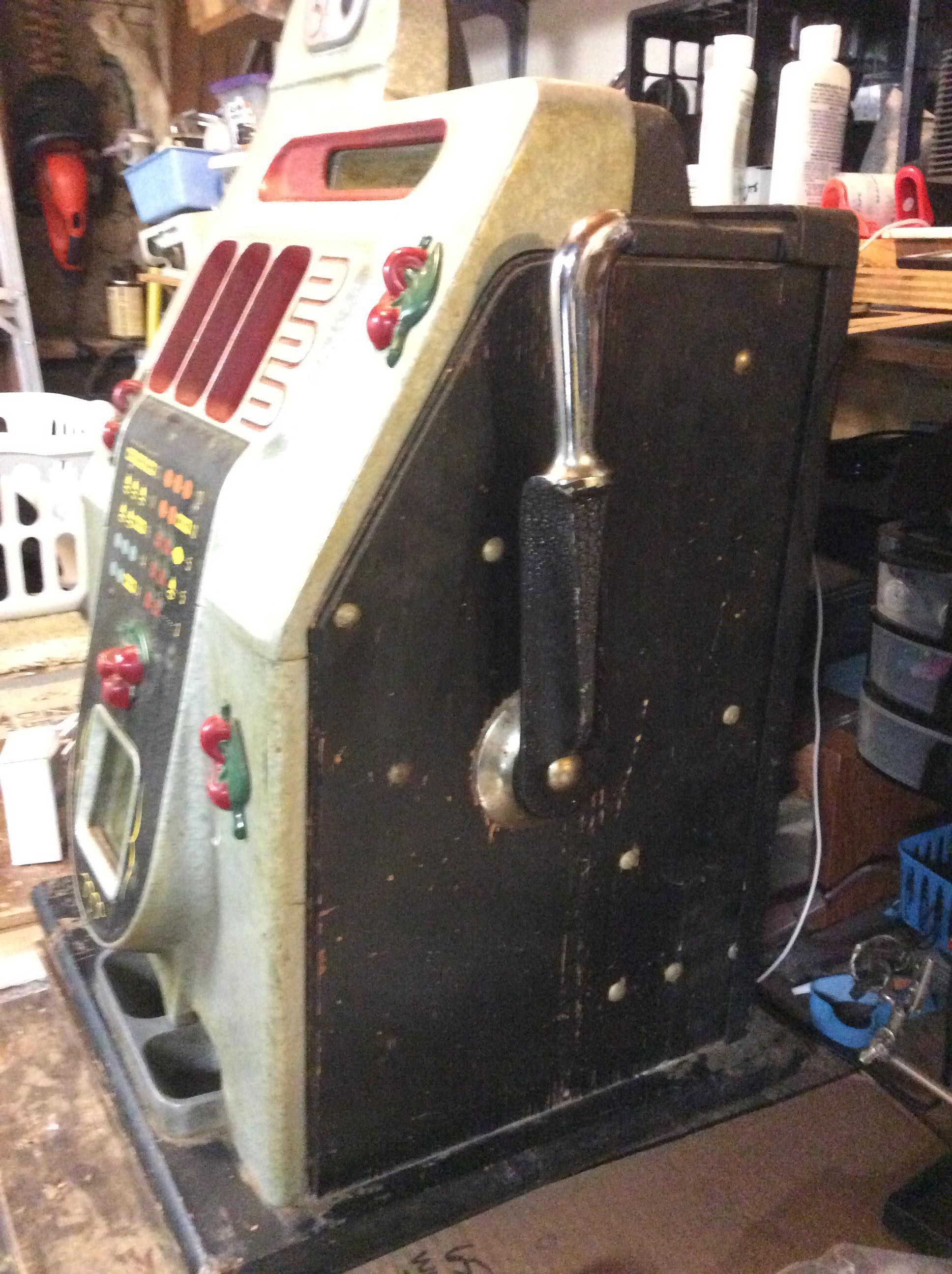

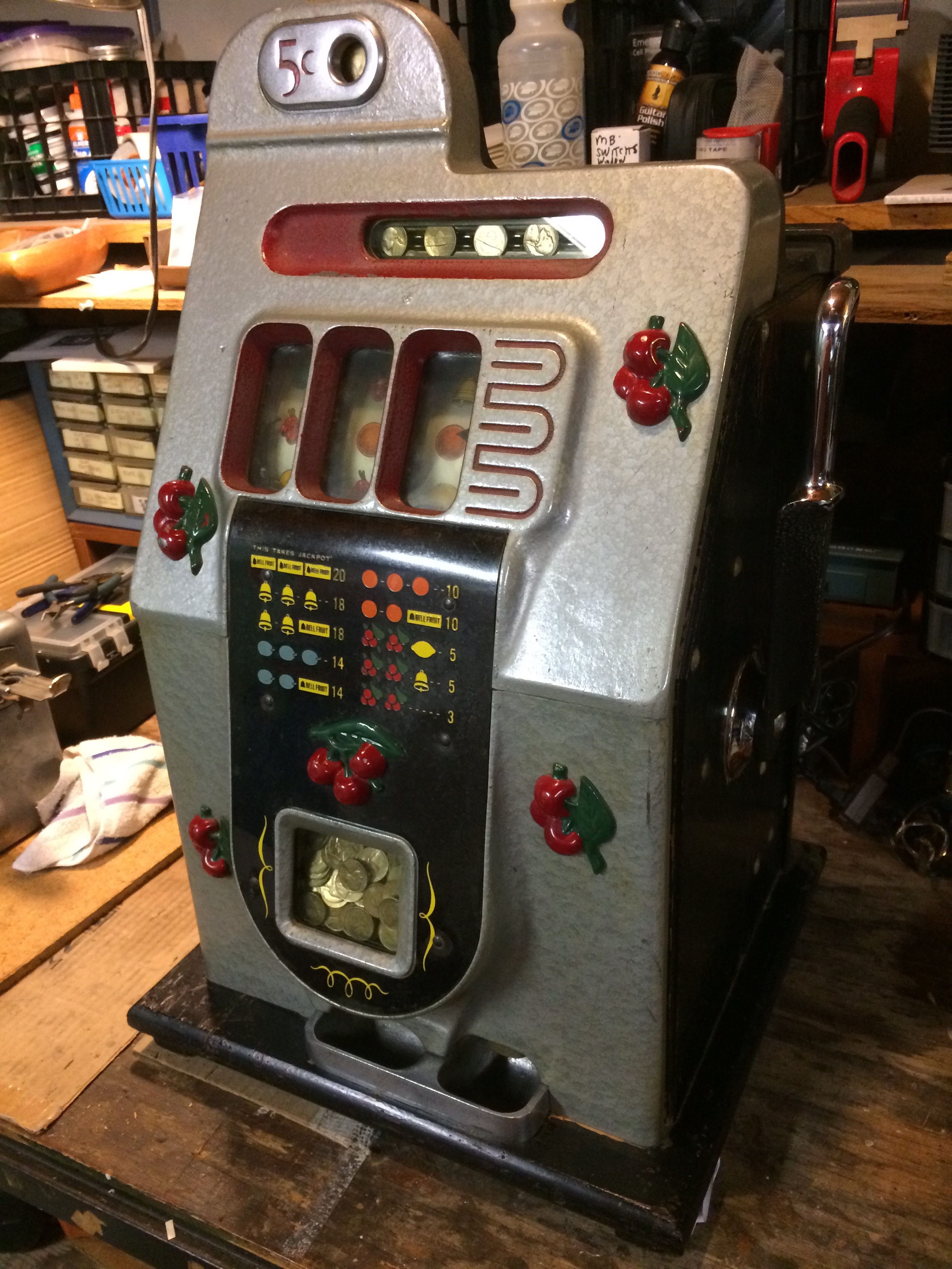

Postby shortrackskater » Fri Mar 09, 2018 10:48 am
Last night and the night before I did a basic "clean" of the machine. From what I can tell, I'm sure the outside wood on the cabinet was repainted since I can see areas were it was masked. The front looks like it was never touched. I used cleaner/wax for the front and it came out nice, considering the condition it was in. I cleaned the black sides and just did a spot touch up with magic marker. I'd actually rather keep this machine in "used looking" condition so I'm still deciding what to do with the rest. The base is chopped up a little! After what I've read on this forum - I'm 100% sure this machine is original although all the stickers are gone. I can see adhesive on the base of the mechanism under the reels though, where one sticker was. However I can't seem to find any serial numbers on the case.

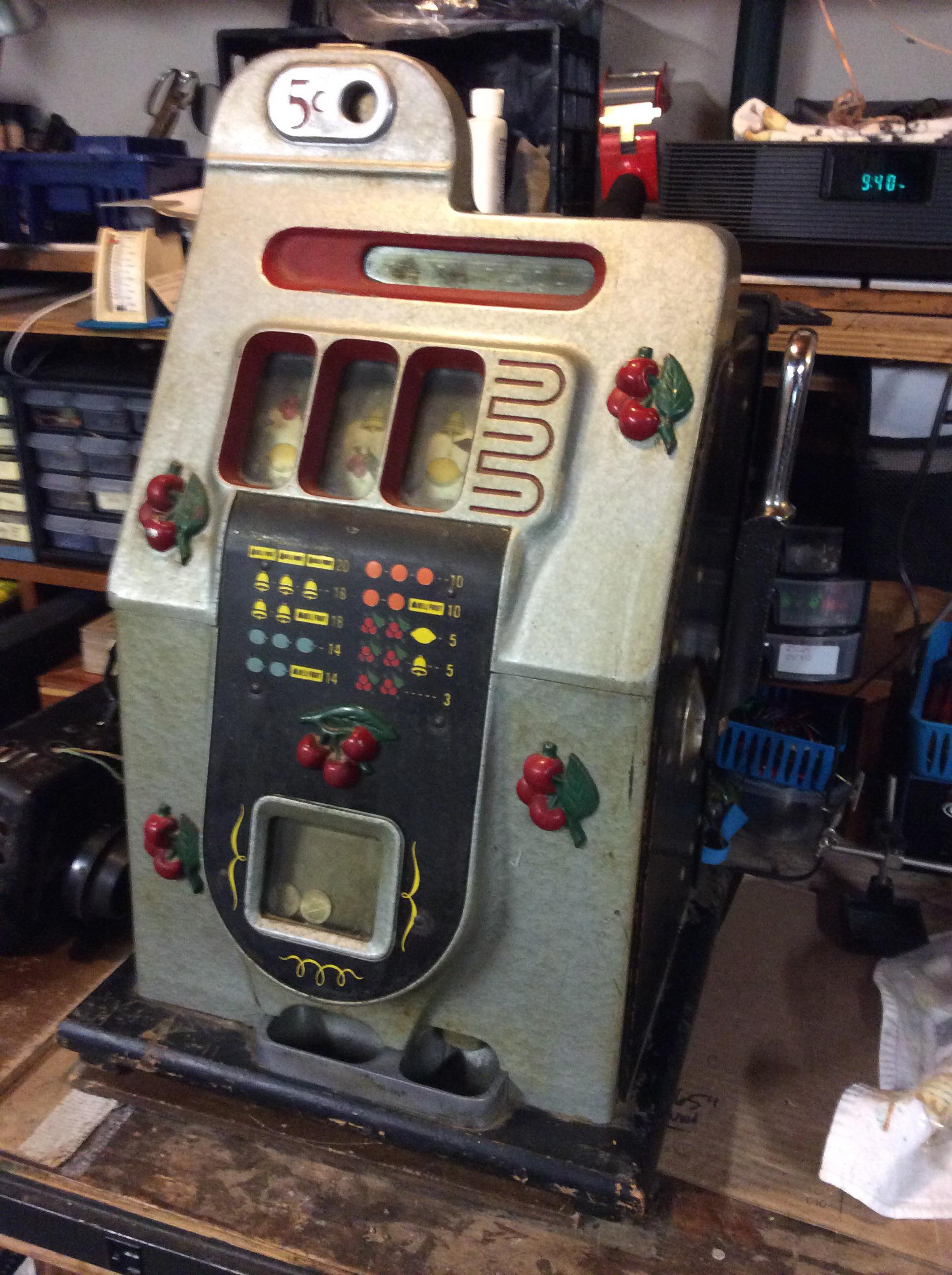

Still wondering about the space where the shoulder screw is on the "coin stopper" part. Here's a picture of the cleaned and polished-up machine.

Postby flipper77 » Fri Mar 09, 2018 12:40 pm
Machine looks nice - good work. The escalator picture that you posted shows your second coin detect/hold lever. These are normally missing as they eventually always cause a coin jam. Here is how these typically look. Flip.

Postby rtmccurdy » Fri Mar 09, 2018 1:04 pm
The serial number should be embossed into the center back of the wood base. Sometimes overzealous refinishing will make it hard to see or disappear all together. There would usually be a sticker with the serial number on the inside left on the steel plate that would match the number on the cabinet.

Postby shortrackskater » Sat Mar 10, 2018 5:10 pm
Thanks everyone for the replies.

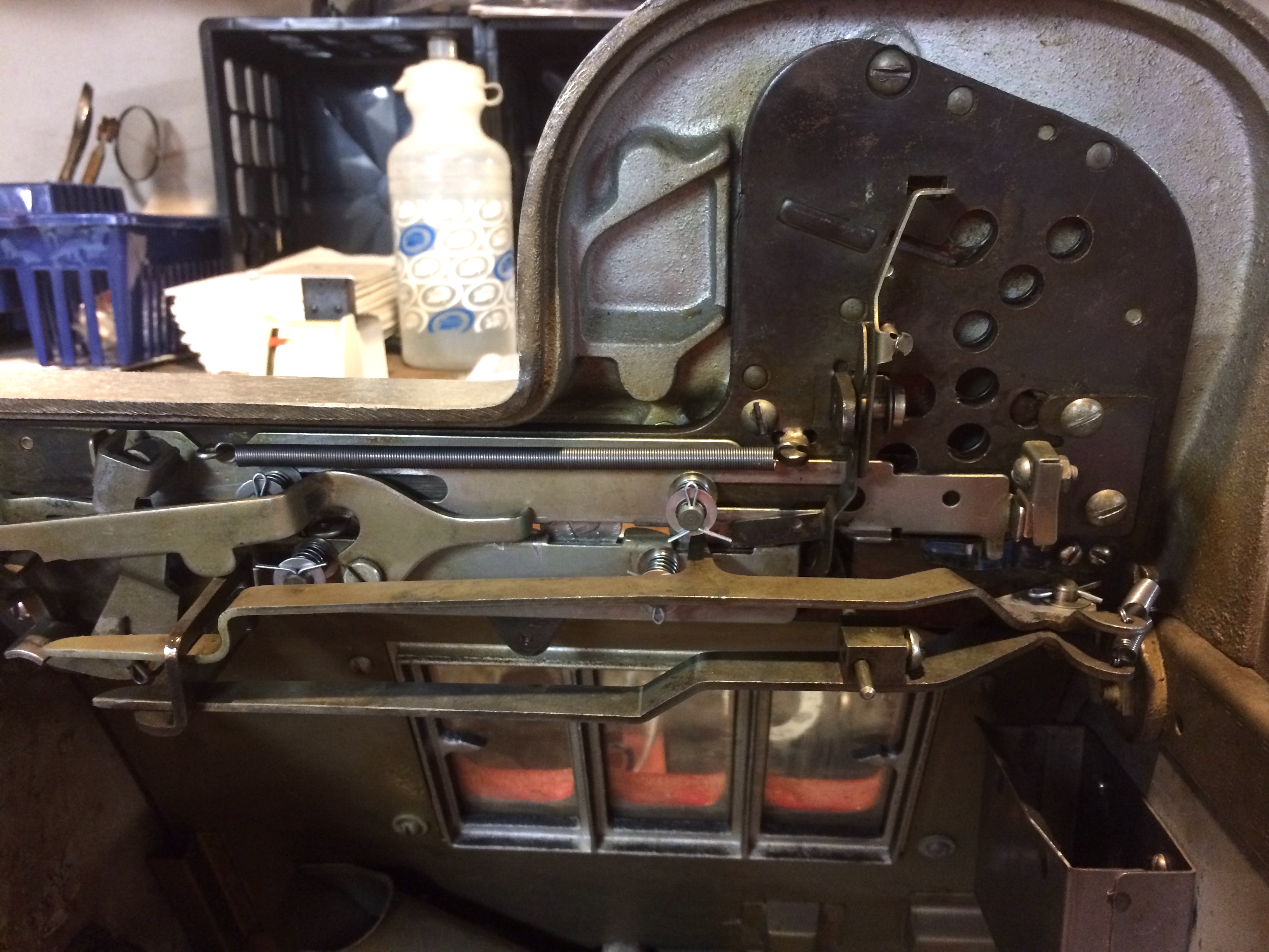

Here's a shot of my cleaned/re-springed escalator. I think it's correct. So far I've only had a couple jams and it happened after the start of the handle pull. I didn't force anything - just exposed the escalator and gently pressed the "offending" lever to the right and it returned. I dabbed some silicon spray just around that area and, so far, no jams about about 50 coins in.
I can't see any serial number. The very back is notched out. Hmmm I wonder if this was a "hot" machine??? The notch is about the size where a serial number would have gone unless there's supposed to be a notch in the wood! I have a feeling this sat a long long time, then someone got a hold of it and had no keys. I think I posted this earlier - the back door lock was encircled and cut out. Then apparently to remove the cash box door lock, they gouged out the wood until the door lifted out from the bottom! That's something I need to figure out how fix. I think I can find a small piece of oak and fabricate it in, somehow.

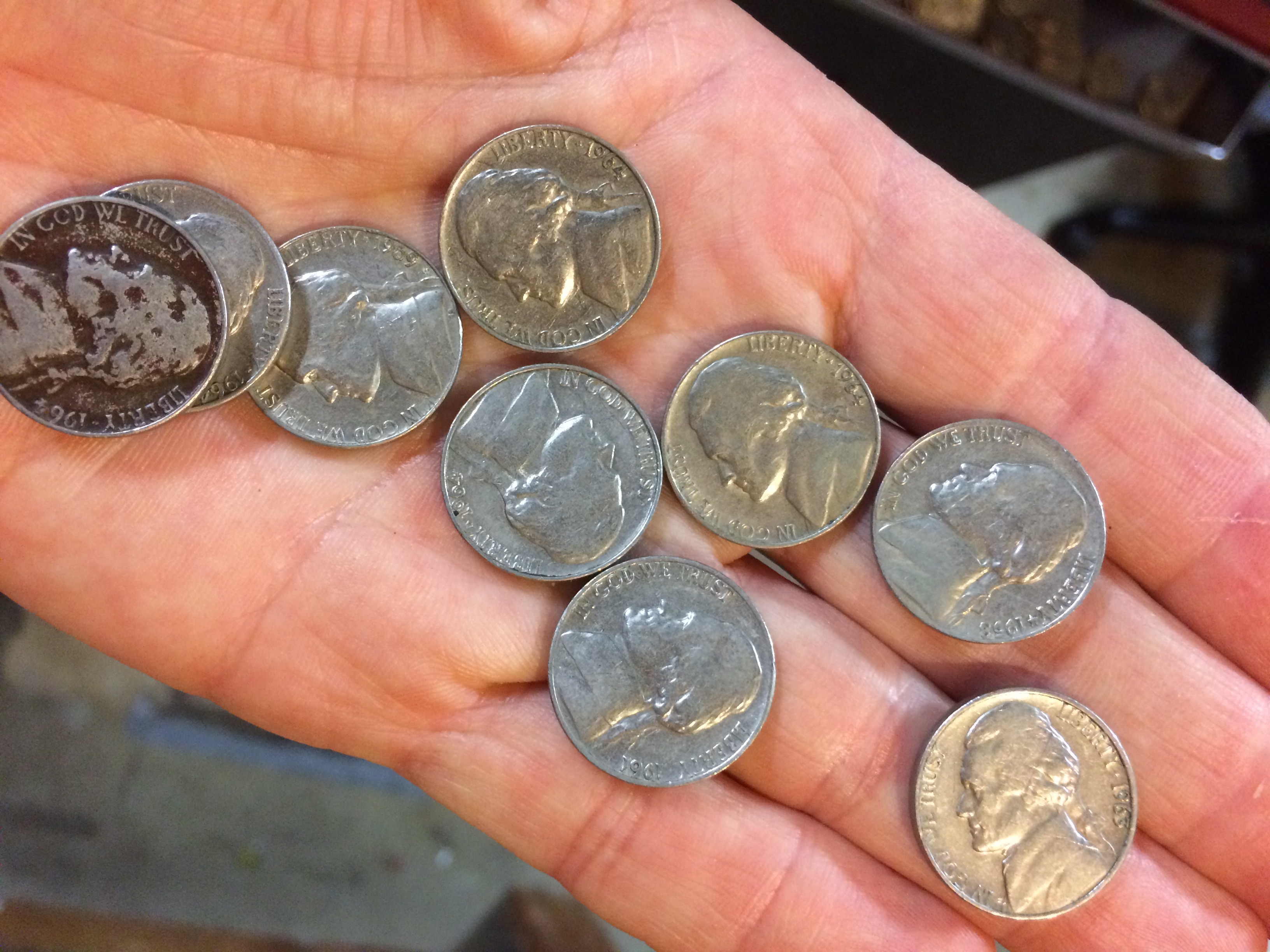

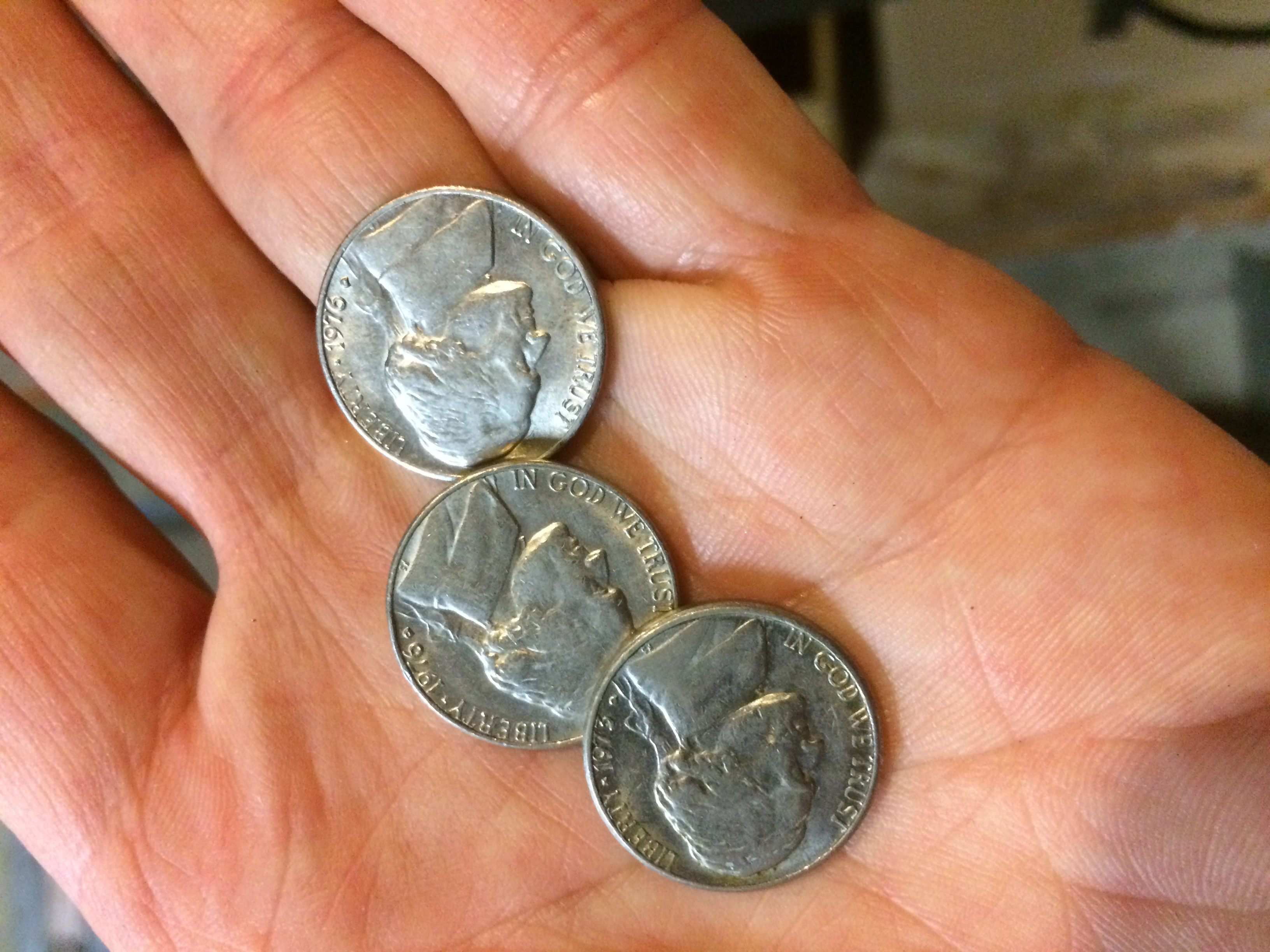

The other interesting thing is that, when I initially cycled the machine, the first 7 or so coins that paid out from the tube were all early 60's and late 50's. The next few were from the mid 70's. So it seems to confirm that it did sit quite some time. Plus there was heavier dirt on on side of the reels indicating that they didn't move a long time! It's interesting doing detective work on this.
