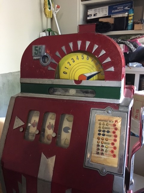

Rec'd a call today from someone wanting to sell a Mills slot machine. Looked at the pic and thought the worst. Futurity. Red and green? Mirror over the dial window = no futurity mech. Missing the key. Figure drill the lock and worth about $600 in parts. I bought it and got it home. Decided to break the mirror to see if I could undo the bonnet latches enough to push the lock/door open. Rec'd a nice surprise (see pic 2). Note that the award card is correct with a cover over the "10 consecutive misses pays 10". This could not have been a fun machine to play. Anyway, still haven't made it inside. The cabinet is painted red and the last base glue joint is loose, so may just go in that way since the cabinet needs total refinish anyway. I will update this after I get inside...

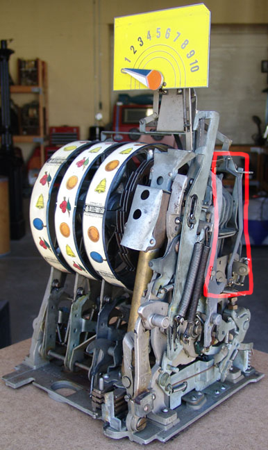

Postby gsx11r » Sat Jul 28, 2018 8:17 am
Hello Atac
Nice shoot !!
Well , some info about your machine.
Some goods , some bads .
The goods :
-You are Lucky , your Mech is nearly complet .
-It s the first version mechanism , hard to find.
-You have the optional link for reset the dial when you use a token with hole.(If you don t need it and that you want to sell it , let me know. =P~ ) .
This link was here when there are a side vendor.
The bad:

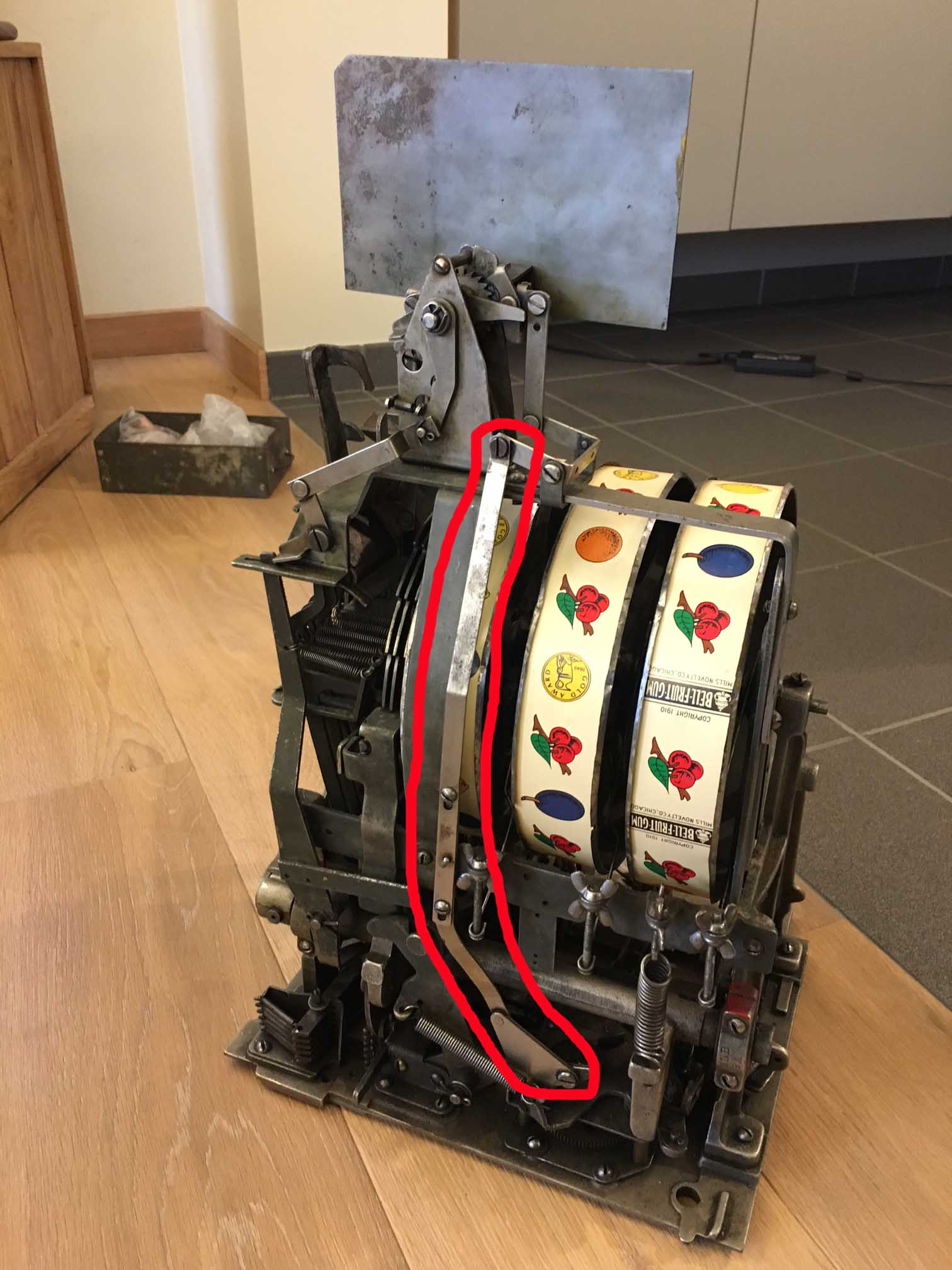

-Your mech is nearly complet , missing the link between the clock and the dial ! Arghh ! :evil:
-You don t have the side vendor , but maybe I make a mistake and you don t have the hole for this in the wood side .
Please , Post more photos of the Mech , I hope that you have all the système for the reel stop arm and othe special parts !
Stephane
The missing link :

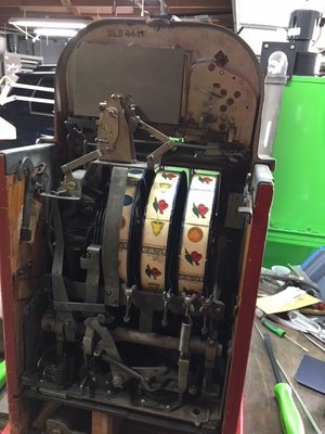

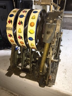

Thanks for the pics Stephane. The cabinet has the side vender hole cover. I don't think it ever had a side vender. As near as I can tell, exactly as you pointed out in your pic, the only thing missing is the jointed connecting lever from the lower clock to the dial to increment the dial each play, plus the spring to reset it on a payout. I don't want to sell that other lever, but maybe I can have one made when I'm getting the missing lever made. Let me know if you're interested in that and I'll get back to you when I tackle that. This is probably fairly common with a specialty mech like a futurity, but my casting/cabinet serial number and the label on the mech base match - 380088. Here's a pic of the front of the mech showing the shifting brakes and cam controlling the reel bundle shift. It's complete. Also things like the second coin reject is on the escalator--indicators that this machine wasn't molested too much (other than the hideous paint job-haha).
Also, the machine does not have the gold award strips, but as I've seen before, it has most of the gold award dispenser inside the cabinet, plus it has a gold award bundle, just not the push rod to dispense the token. The original strips are near perfect, so I'm a little conflicted whether to complete the gold award version when I restore it.

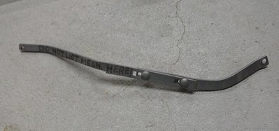

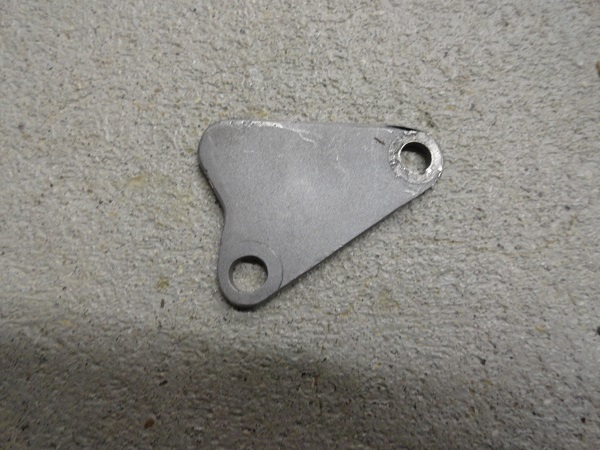

Postby gsx11r » Sat Jul 28, 2018 11:36 am
Hi Atac
here is the two parts that you need to make .hard job .(PM)
About the other link , if you make one , sure , I buy it !! 8)
