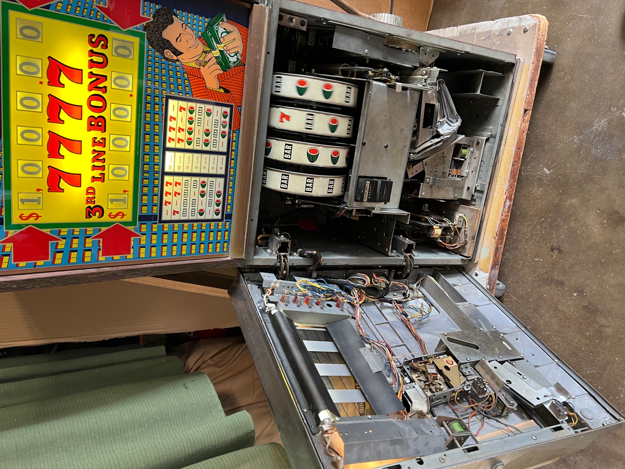

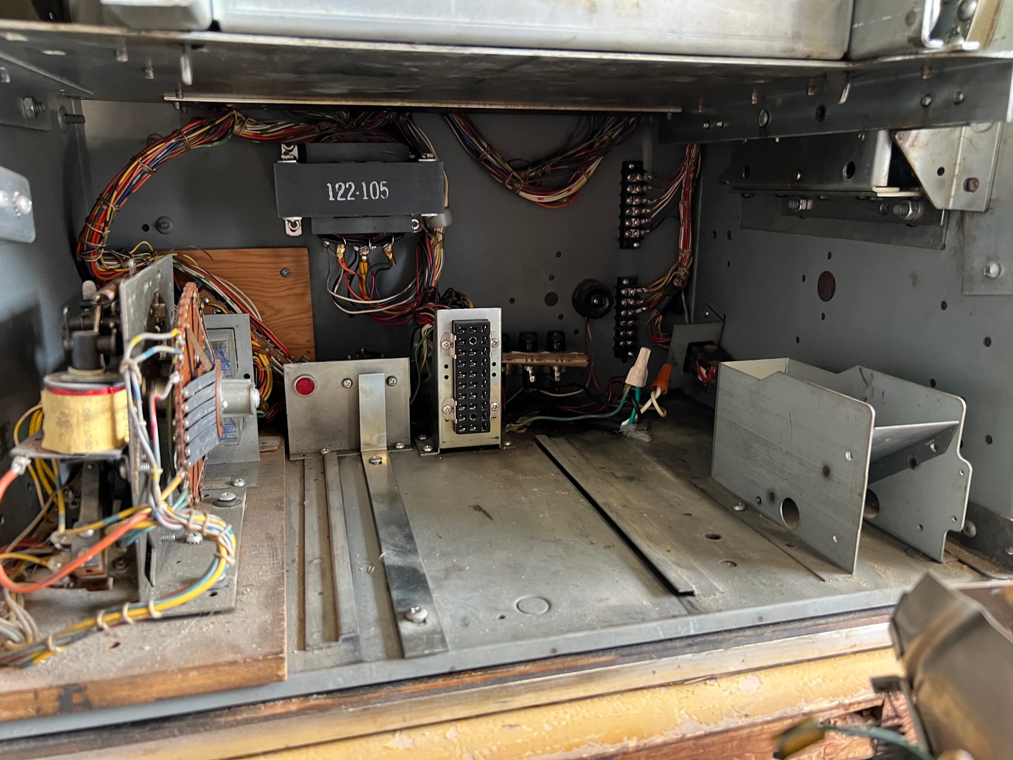

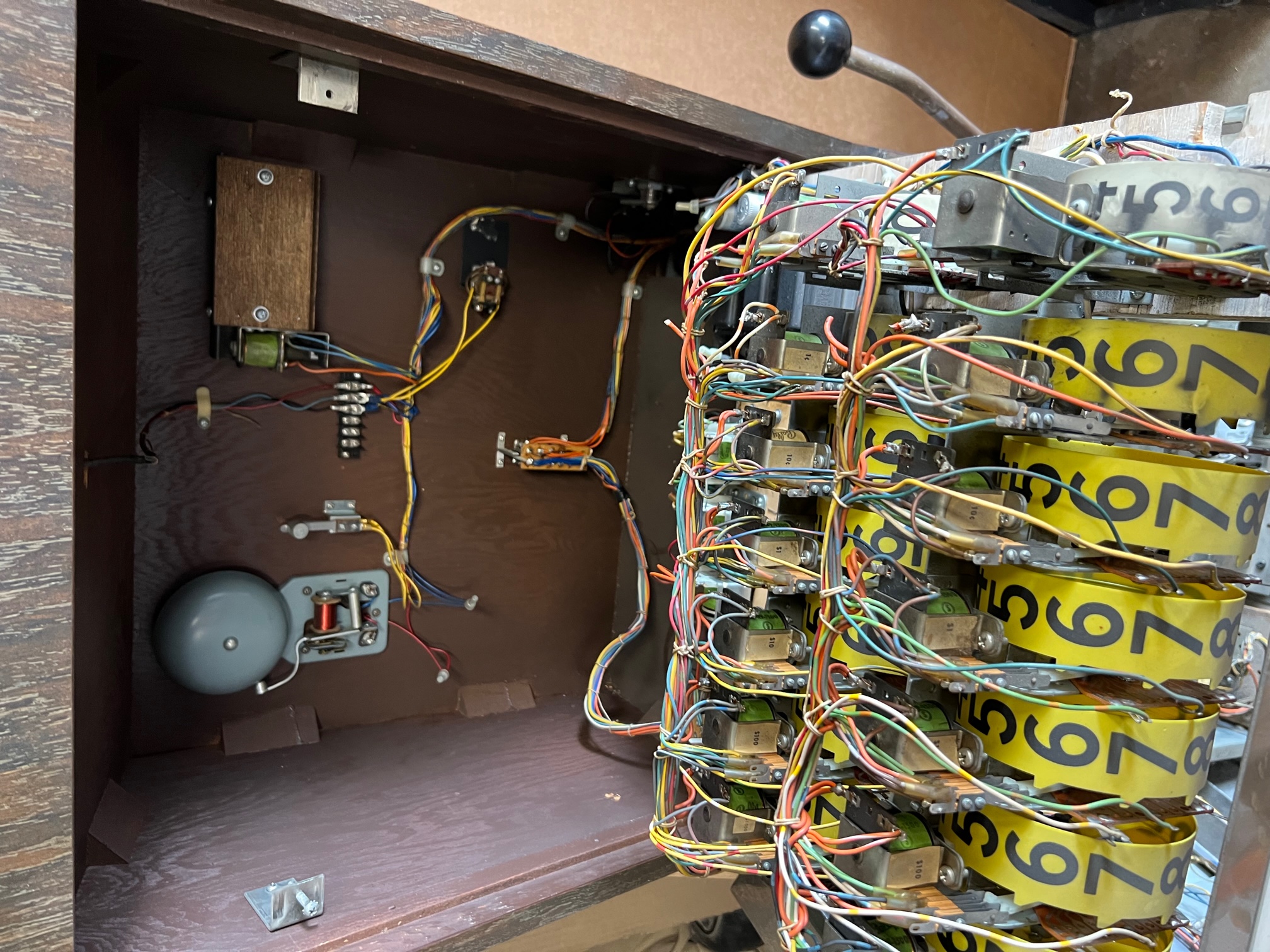

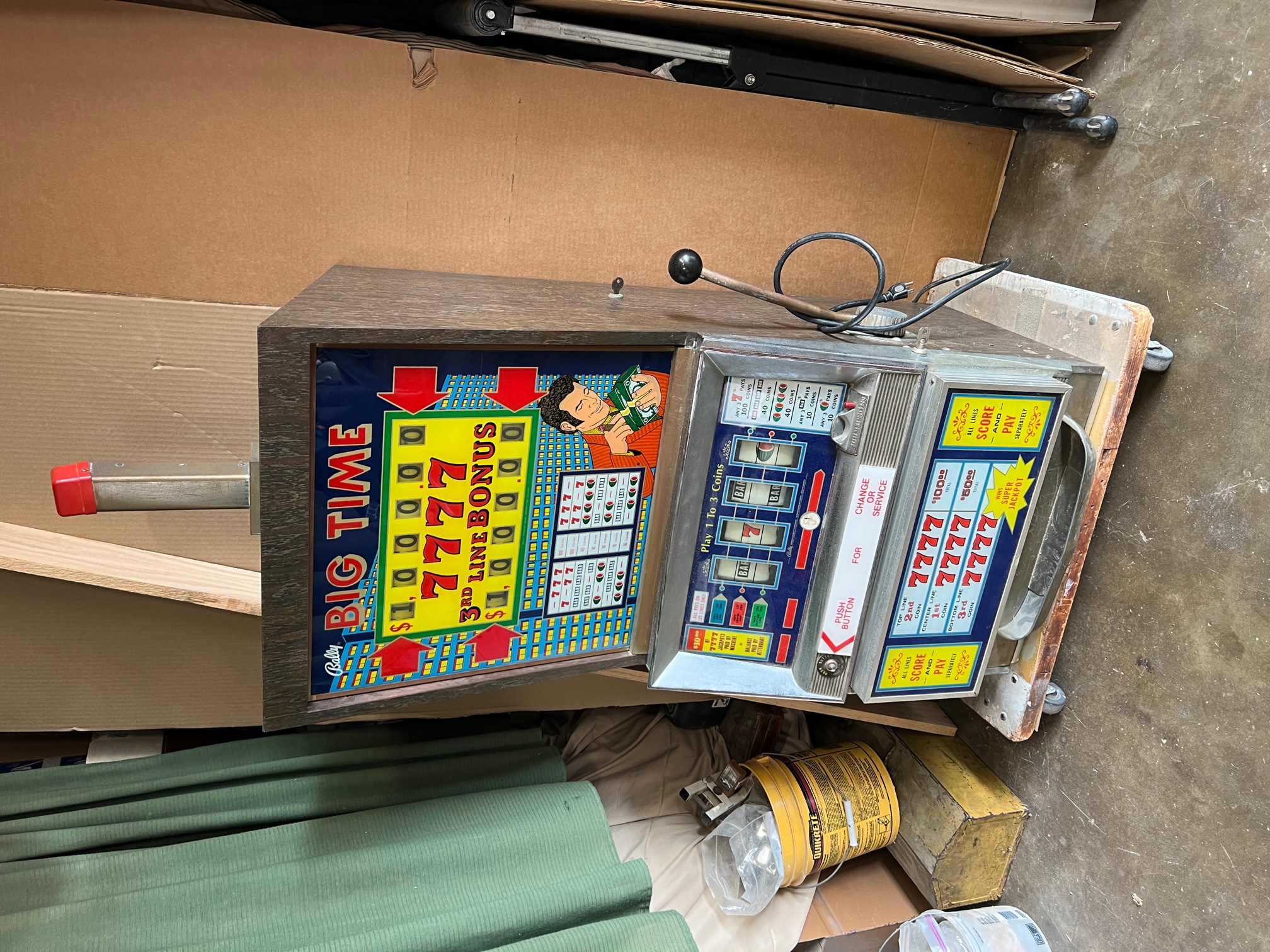

Hi folks, I am looking to sell my dad's slot machine for him that he acquired through trading labor. When we received it the 110v plug was trashed so I made a quick fix and thru some wire nuts on a new power cord. Works great except I cannot figure out how to get the machine to fully function. I am not sure if this is a quarter or nickel machine either. I checked the fuses and they are in working order, but I did not replace them.
I am attempting to find some information on this machine to see what it is worth. On the inside on the hopper it states that it is for $0.25 but on the front it shows 5c. The model number on the inside shows 1015 as well. If anyone has any information about it I would greatly appreciate it. He traded some labor for $500 so I am not sure what we are working with. I have only been able to find the $0.25 version online without the upper half of the machine. I am also look to find someone who has the knowledge to help me fix it as I am a mechanical engineer and feel that once someone can view the photos and video of the issue it would be simple to diagnose.

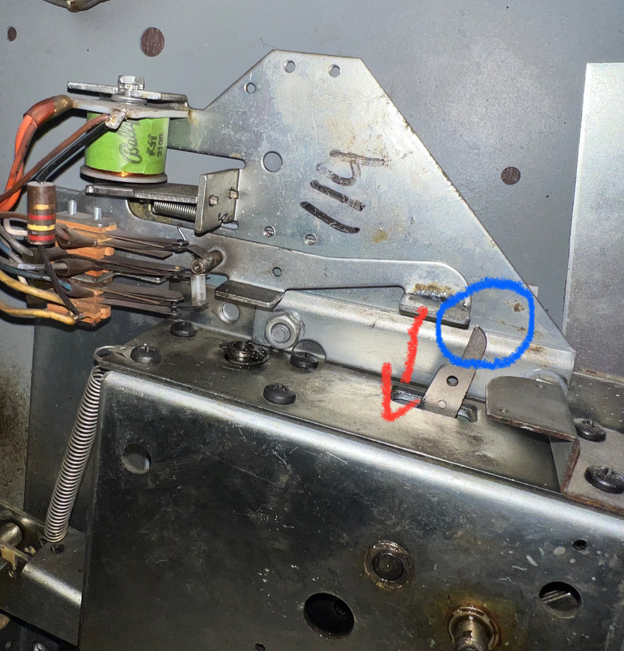

In this photo if I pull the blue lever to the right (towards front of machine) I can pull the external handle down and the wheels start spinning properly.

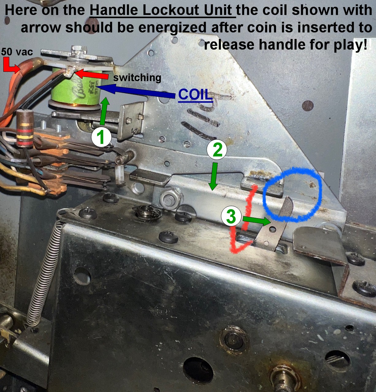

slangyeti90,
Your problem relating to the photo noted below could be various things as a coin entered should "trigger" the coil to allow the handle pull to start the game and not doing so could be a broken wire, cold solder joint, a beau plug pin not making contact, a leaf switch on the side of the reel mechanism, a proper reset issue on the hopper, Etc.
Contact me by my direct email and I can send you a diagnostic guide and further information in that way!
