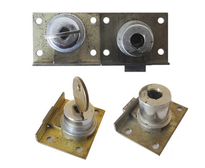

The shorter one with the lower set cylinder was used on Mills consoles on the lower back door. I don't think the roached out one is really proper for a poinsettia. Typically Yale locks would have been on a Poinsettia up until around 1930, then the proprietary Mills locks started showing up. I have some from the early 1930's--with the brass block riveted on as opposed to the chrome one you have that's peen'd into the lock base and was used on hightops. Check my posts for a picture of the other Mills lock--and PM me if you want to buy one of those--I'm in Denver so we can figure it out.

Found the picture of the early 30's Mills lock...
