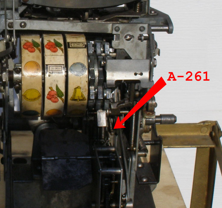

No idea what the letter prefixes signify; possibly to designate that these are part numbers rather than serial, or lot numbers?
Aside from A-20 (the reel stops) which are pretty clearly indicated in my copy of the Coin Slot Guide #19 on pg. 30 (in an illustration lifted from the second page of "Hail Columbia Bells," where it's a lot clearer), the images below are my best guesses at the parts you're asking about. I had one machine in which this dagger-like thingy which I'm calling the "Star Wheel Guide, A-90" was bent in such a way that it jammed the star wheels cockeyed to each other-- instead of nudging them into full-stop position if they landed between symbols, which would appear to be its proper function. I doubt you have this problem, but it's worth checking while making sure that the payout finger A-85 (which it follows behind during operation) is straight and functioning properly.
What I'm calling A-261 is a little sprung pawl which lies just to the right of the reel stop pivot roots. If this little pawl does not trip and reset towards the end of the cycle, your next pull of the handle will immediately jam on the reel stops, and hard. Watch its operation and you'll see what it's about.

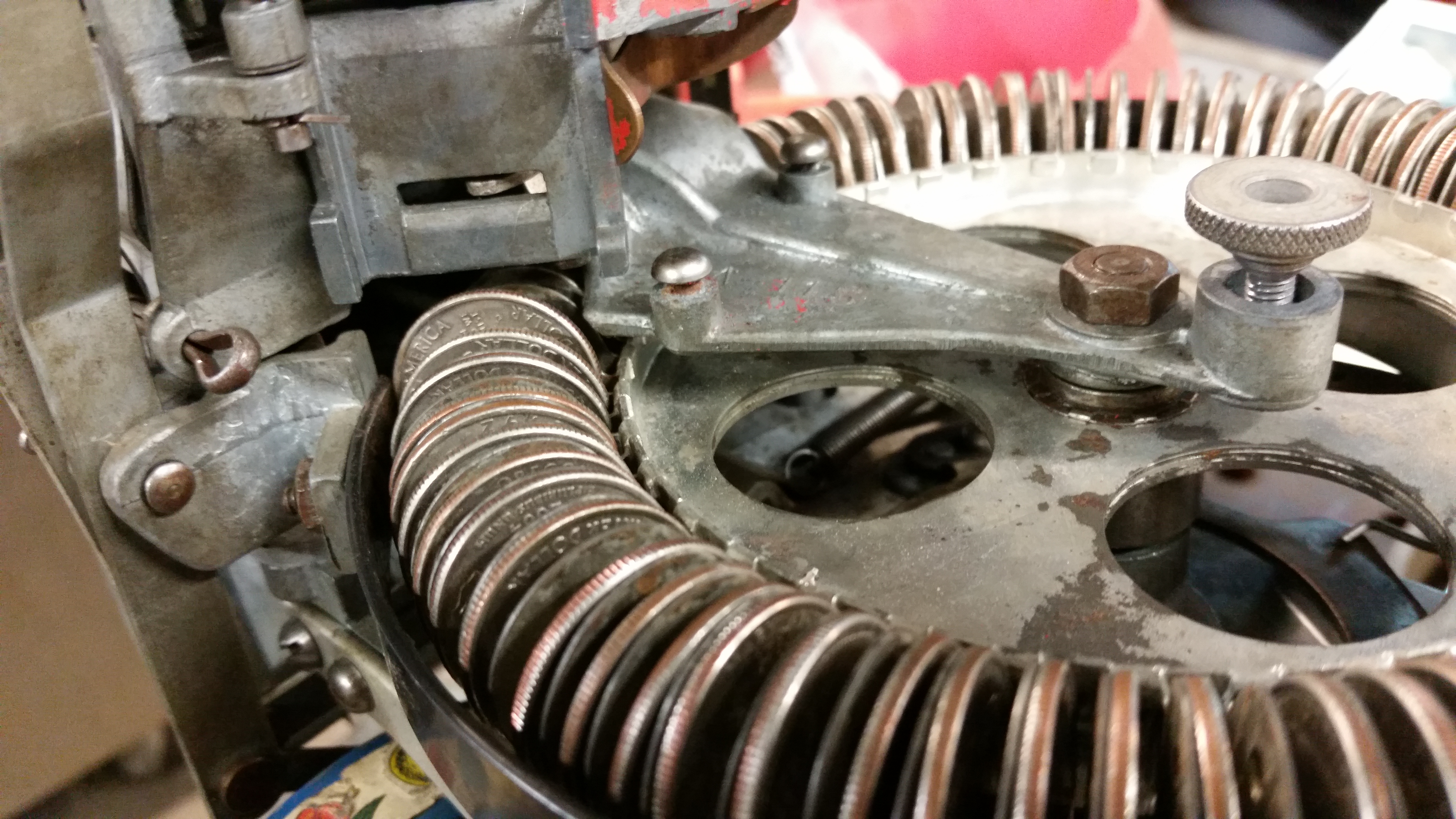

Thanks Marsonion. As I fiddled a little more with it, I noticed it was grabbing the newly dropped coin before the clock runs out. If you pull out the offending coin, the clock continues. I can't really see the mechanism below the magazine, but it is that under the high coin in the pictures.
