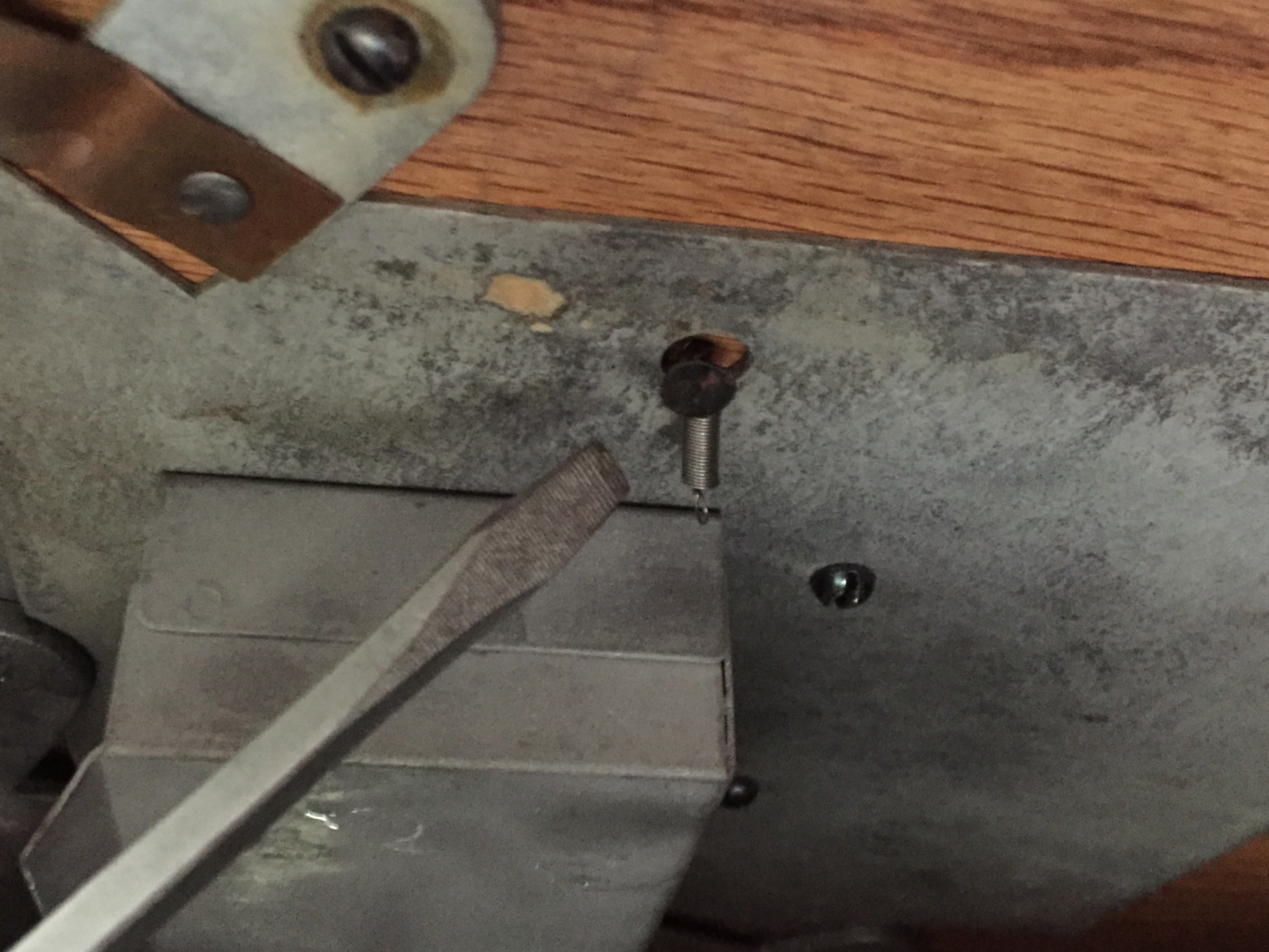

Almost ready to "close the case" on this project but have two unknown springs to nowhere. Can anyone offer their two
Cents worth and tell me what these are/were for or can they be removed? One
Is up top by coin box on right side of interior of case. Screwdriver pointing to it.
Second spring on interior of base way up front would be under jackpot but my fat hands probably can't
reach in there unless the metal base is removed first.
As always any and all help is appreciated.

Richard13 wrote:Almost ready to "close the case" on this project but have two unknown springs to nowhere. Can anyone offer their two
The one buy the coin box I have no idea and have never seen. The one on the bottom is for the fan stop lever and is not needed unless you have or install the fan stop lever

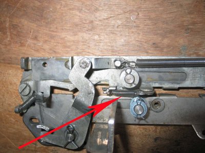

About the stop fan , easy ; it’s this .
stop fan.jpg (33.72 KiB) Viewed 4385 times

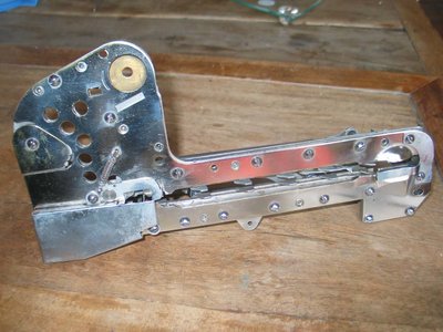

About the spring near the coin box ,it’s a spare part .
I think that you have all this parts inside your Front castle.
And think that you have this Escalator.
And the spring goes here! It’s for separate the coins and the token with a hole on the middle!
Please ,give more photos of your Front castle !!
