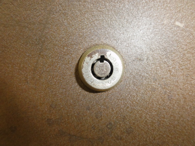

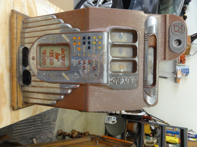

Picked up a decent quarter Buckley but owner had lost the back door key. This has the tubular lock/key like my late Jennings and Ballys. Any one familiar with these - can these be opened by a locksmith and can a new key be made? Looks like the original Buckley lock so hate to drill it out. Flip

Hello ;
first these types of locks are much easier to "break into......"
This will sound stupid..... but it may be opened with an ink pen. take a bic type ink pen, take the plastic filler piece off the back end , the use a razor blade and basically cut a cross into it = 1 slit across , 1 slit up and down. so what you have is 4 slits / 4 pieces of plastic. shove the hole pen into the lock & twist it back & forth ( clockwise / counter clock wise) for a bit till it turns. slit depth depends on the mushrooming of the pieces & depth of that lock area.
Then remove the lock , take to lock smith for a new key.
YES , this can work... & works often. this lock should have 8 or 6 pins in it but ,only a few of these pins really do anything.
check the internet for picking these locks.... Very good story on it , doing this method.
A major lock company who backs their locks with a $3,700.00 cash guarantee. had a guy continually opened their locks with a pen (on you tube no less). they had to buy back the locks & redesign a new one.
if you have the "right " type screw drive with removable tips for different screws or hex type head bolts , same method ,just use with out any tip in place. This is also seen in you tube videos , takes seconds to do.

Postby RameGoom » Sun May 08, 2016 7:58 pm
I use this style lock pick for all 7 pin barrel locks:
Takes about 10 seconds to open an Ace lock.

Postby RameGoom » Mon May 09, 2016 4:51 am
The part I use is a 7 pin, part number TPXA-7 made by Southord. I believe they're available on Amazon for somewhere around $60 or $70.
You set all the pins flush with the end, put a bit of tension on the O ring nut, insert it into the lock and wiggle it a few times. Somehow, the pins find the depth of the tumblers and within a few moments, the lock is open.
And, if you have a key cutting machine for these types of keys, you can use the tool as a key, and make a key for that lock from a blank. Pretty cool operation. They make an 8 pin model, so if you are into re-keying locks, it'd make sense to have both.
