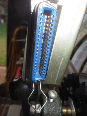

Well with the machine, i was testing the connector on the mech i pulled the mech out from the cabinet. this plug is the one that i was talking to you about me pushing the contacts out you can see them on the pic the ones that are missing, it still registers 2 shorts, 1 short at either end of the connector, i think it had those faults before i messed up the contacts. So i am not sure about this one, maybe those contacts i messed up are not needed i am not sure will see what you think, if it wasnt for soldering a new connector on i would go that way but that seems very difficult well for me anyhow

Hi Jim, well i have pulled the mech out now and just testing the connector, as you can see by the photo the plug tested shorts on the 1st pin and the last pin
also the connector which is missing the couple of the bottom contacts is this one, you can see in the photo pretty clearly

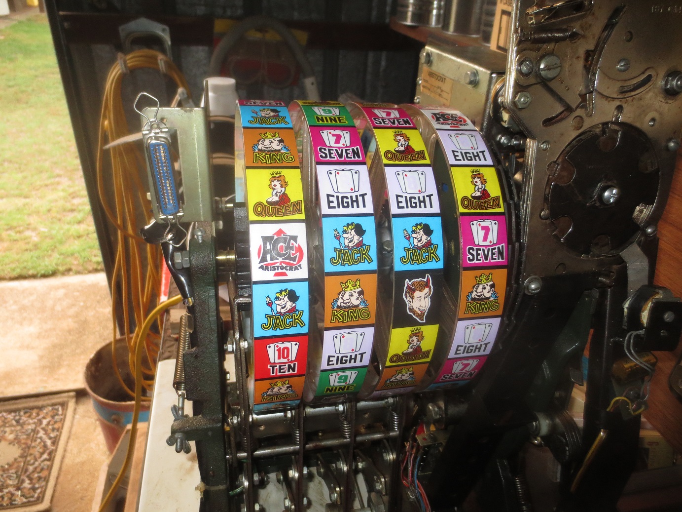

Well with the Mech i pulled it out and tested all of it. All tested fine on the Mech, well all except the cable as pictured above, the pins on the cable fault at either side, also tested the rear wires coming from the pin and they fault also.
So 2 faults all up in the connector (This is the cable i pushed the pins out by accident think you can see it in post above) so maybe there is the fault not to sure
