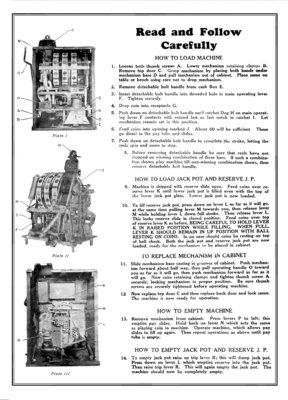

Can anybody explain how to empty the coin tube on a Caille silent sphinx. Mine has a bunch of pennies in it (its a dime machine) that I need to get out. Thanks

Attached is a patched-together graphic of the back-door paper from a Dough-Boy. The process for emptying the coin tube should be very similar for your Sphinx, except you can ignore the "lever N" part; just put a coin in the receiver at the upper right of the mech.

Turn the mech upside down and shake vigorously !
Just kidding ! Haha !
You may have to remove the coin tube from the mech , those pennies may not go into the slides

Postby marsonion » Tue Aug 02, 2016 7:57 pm
sam2002 wrote:Turn the mech upside down and shake vigorously !
I agree-- and there's only two or three screws to undo before you can pull that coin tube, and that's the way I do it anyway-- but I wasn't too thrilled at the prospect of trying to walk anybody through it cold... :(
