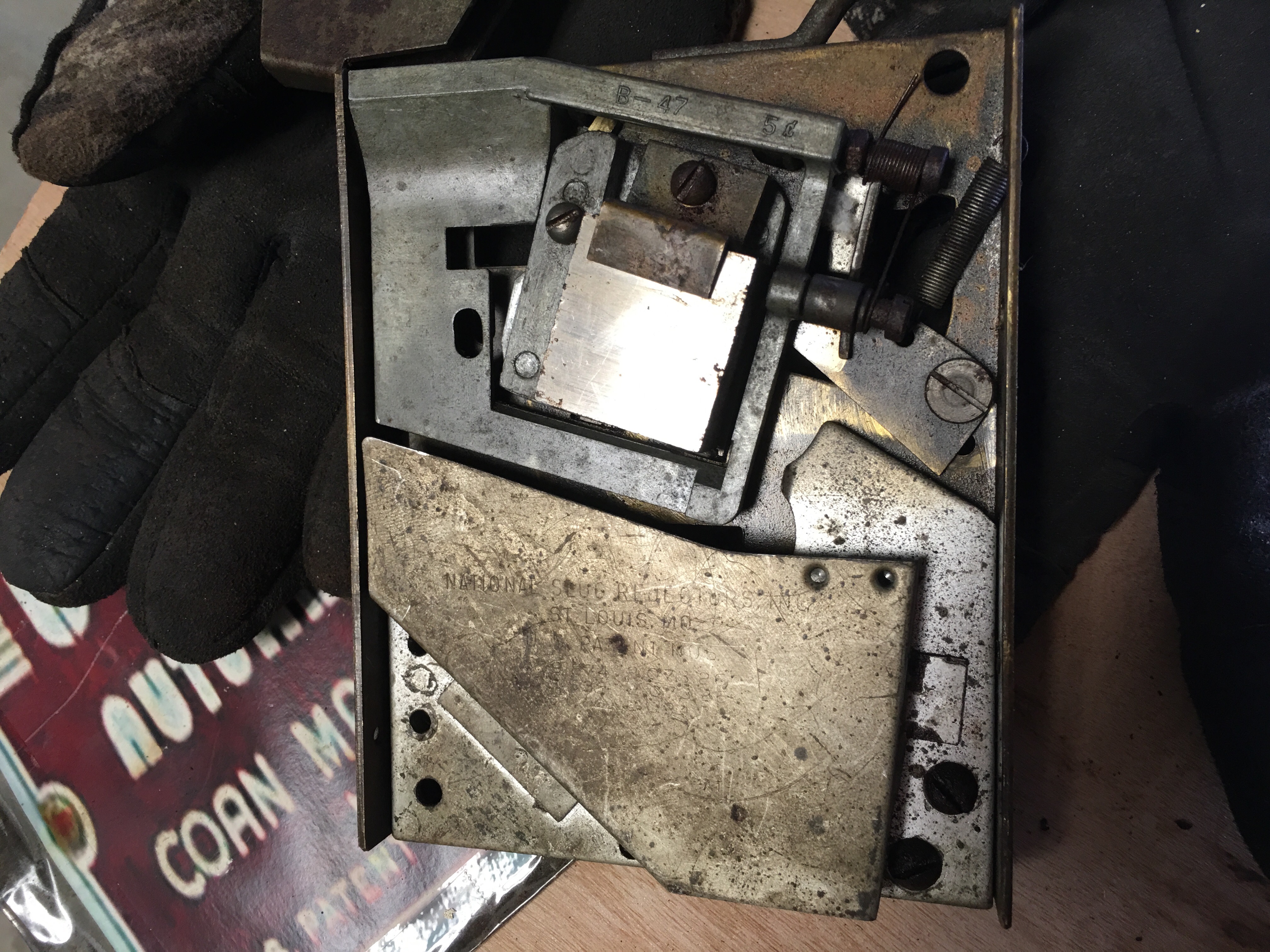

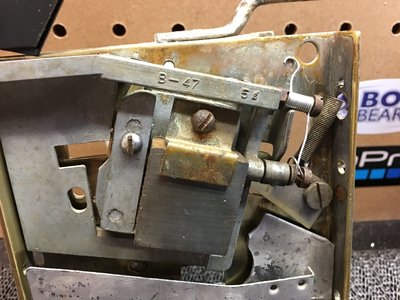

I have a 1940's National 5 cent slug rejector. Where can I buy springs ?

You may find what you need at the local Lowe's or Home Depot.
They actually have a decent selection of springs.
When they don't have it, I've been able to find good replacements at a local Mom & Pop hardware store (I think they are under the Ace Hardware umbrella),
which seems to concentrate on stocking specialty items not found at the big box stores.
Caution; Proper tension is as important (I'm sure you are already aware of this) as size/lenght, maybe more so.
If you've had no success locally, try mrslot1.com for springs.

If you inspect the mechanism and observe its operation, you'll see that the coin needs to be a certain weight in order for it to divert into the proper channel. A slightly lighter or heavier coin will cause that mechanism to route the coin to the reject channel. There's also a magnet that causes a steel "slug" to be diverted into the slug channel.
By blocking the reject path, you can position the coin path to always enter the proper channel using a stop pin or wire in the reject path to keep it on that track. And the counterweight will work with all coins, so blocking the wrong path keeps the coins in the right path. That said, any coin will always work and make it to the proper channel to run the machine.
You'll likely have a cup full of new nickels that will be the only coins going into your machine, so no worries about slugs, washers, etc. All the coins will be the same.
Keep the original parts with the machine, in the coin box, and no matter how you modify it, one can always restore it back to original. Keep notes and pics as well, just for posterity.
Just a few suggestions, but preventive measure of having to pull the mechanism out of the case to un-jam a coin would be a major plus.

After completely disassembling cleaning and polishing then making a torsion spring my coin mech is working perfectly
