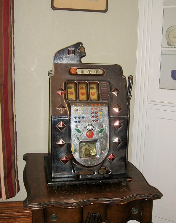

I am interested in hearing what folks use to clean slot machine mechanical parts. I am refurbishing (what appears to be) a Mills Chrome Bell/Diamond Front. I'd like to know what solvents (and methods) are recommended. Once cleaned, do the parts need to be 'treated' to prevent future rust? I combed through the "Repair / Restoration Questions" forum but found few suggestions. Any advice, gleaned from your own experiences, would be most helpful and greatly appreciated.
