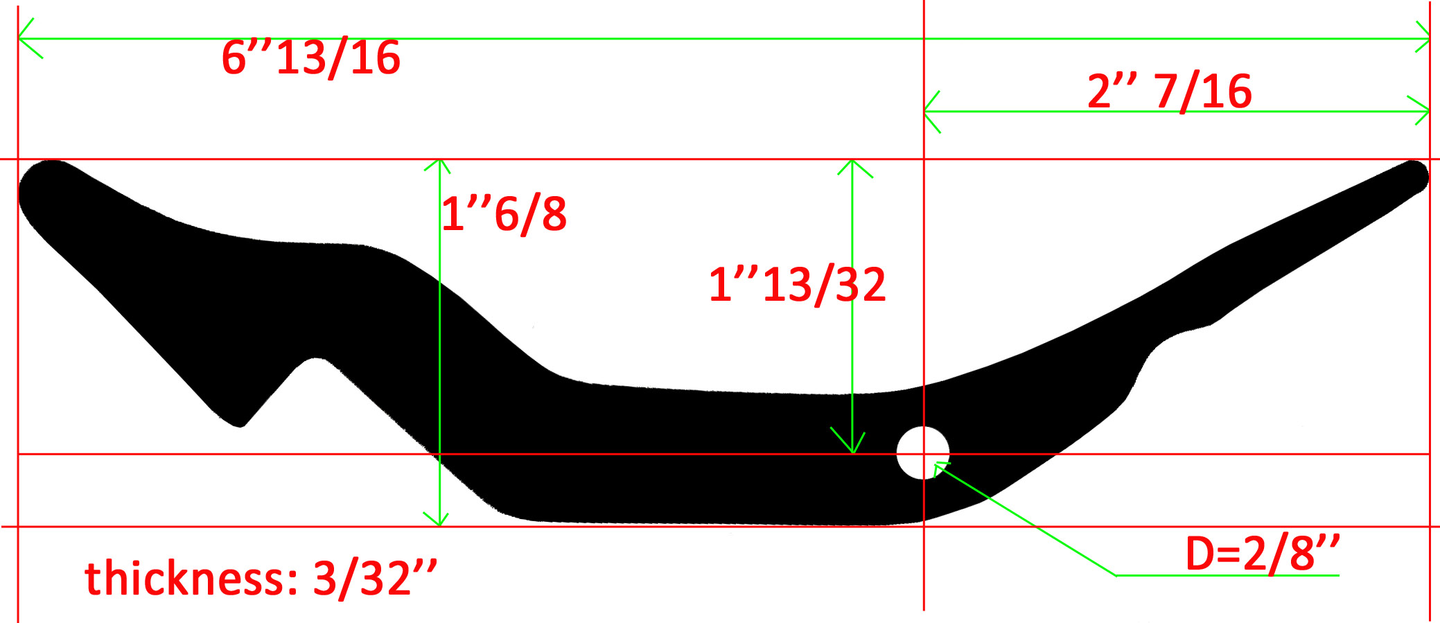

Hello all

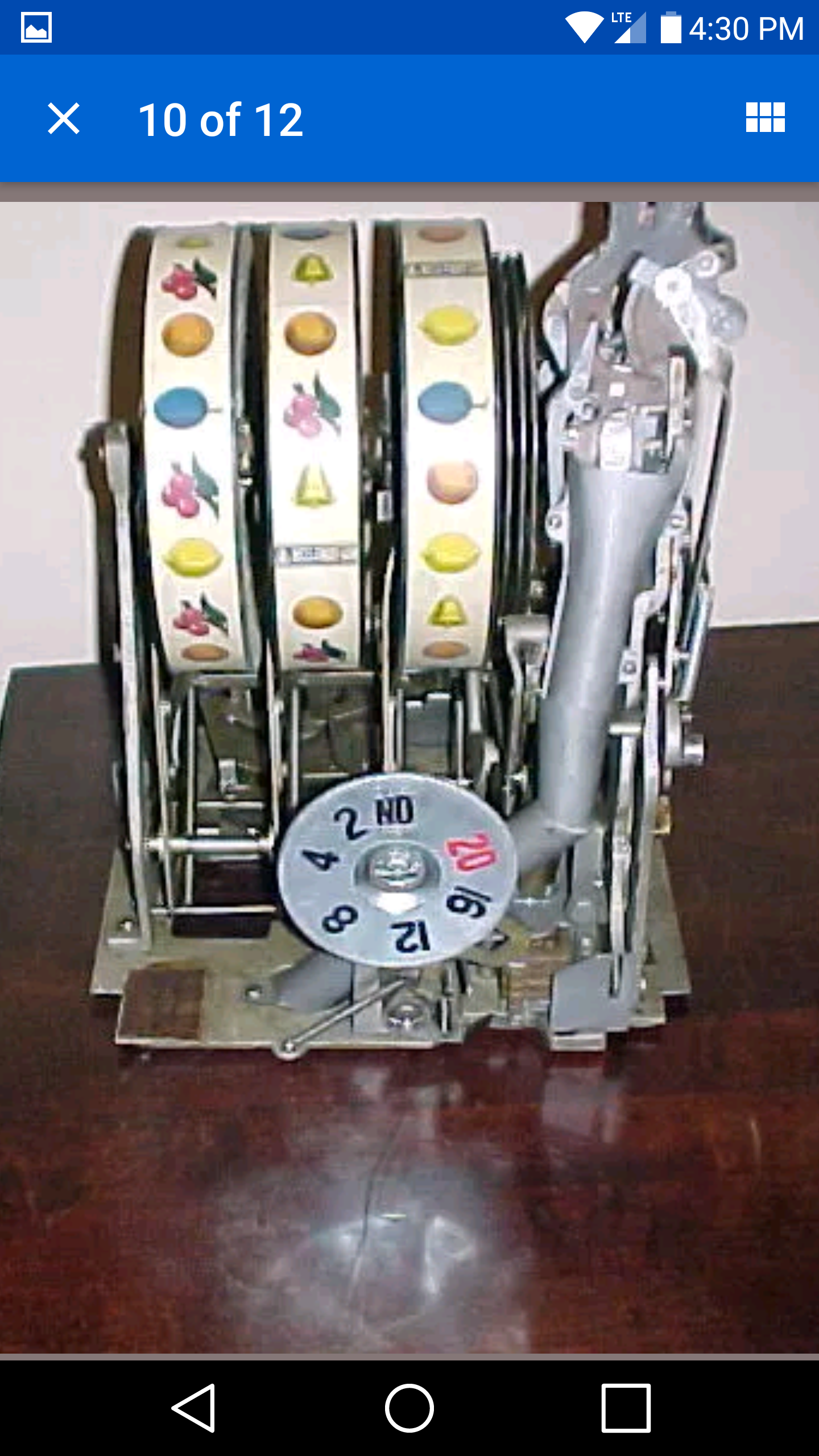

I have a Mills operator bell with the flat future pay mech (number displays from the front)
I need a picture of the lever that resets the future pay mech
the missing lever pushes the future pay lever down prior to the slides resetting forward for the next play
Need to know what it looks like and the mounting - i assume it mounts to the reel levers? - just cant find any pictures of the function
Thanks !

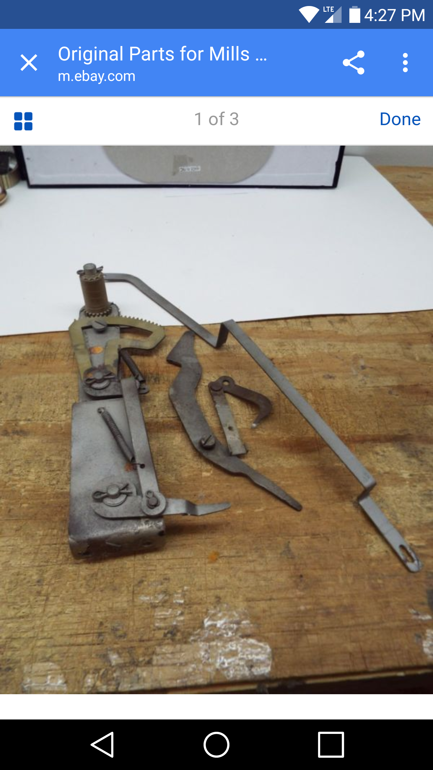

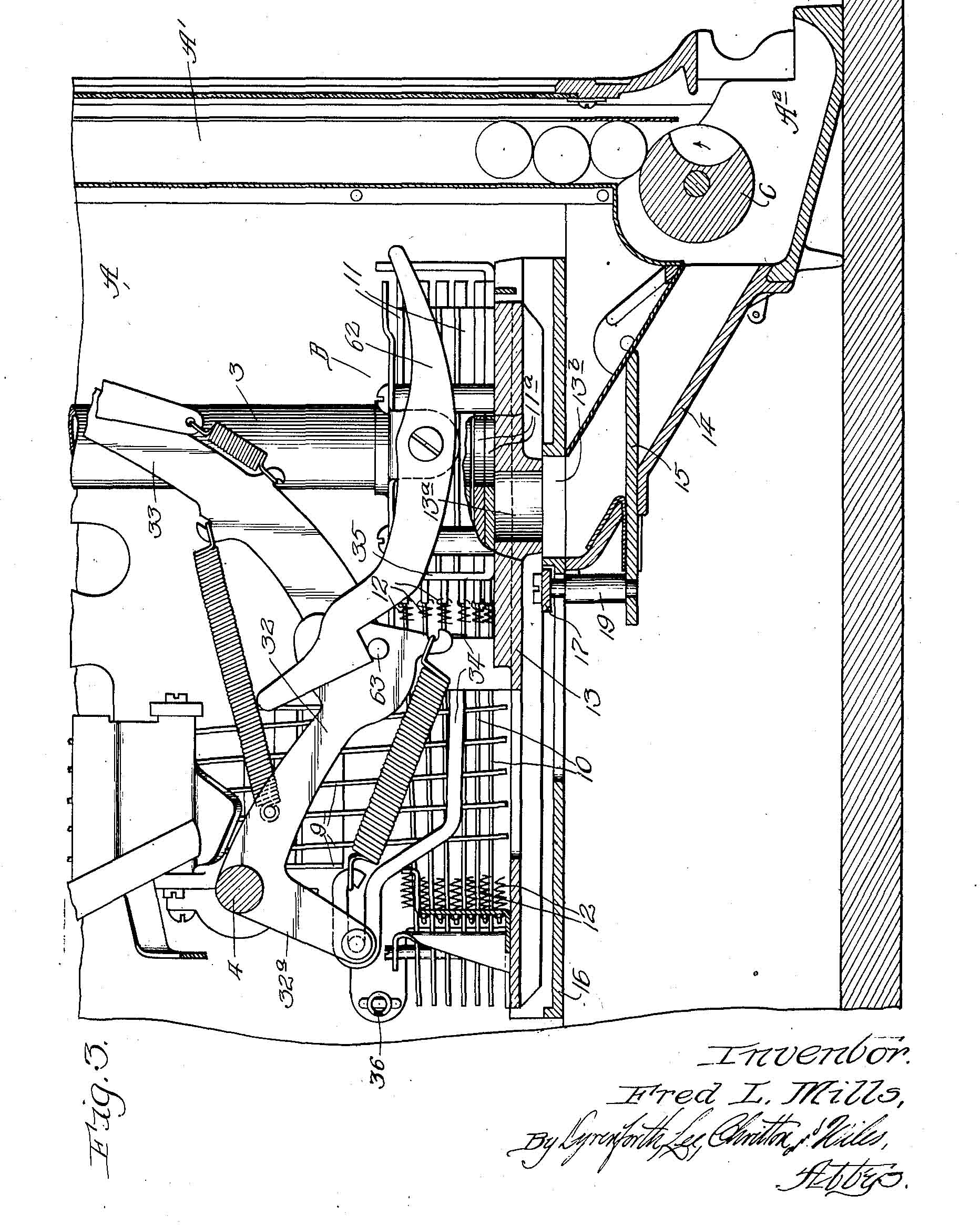

Postby briank » Sat Mar 11, 2017 3:36 pm
I found some pictures...unknown if any will help you.

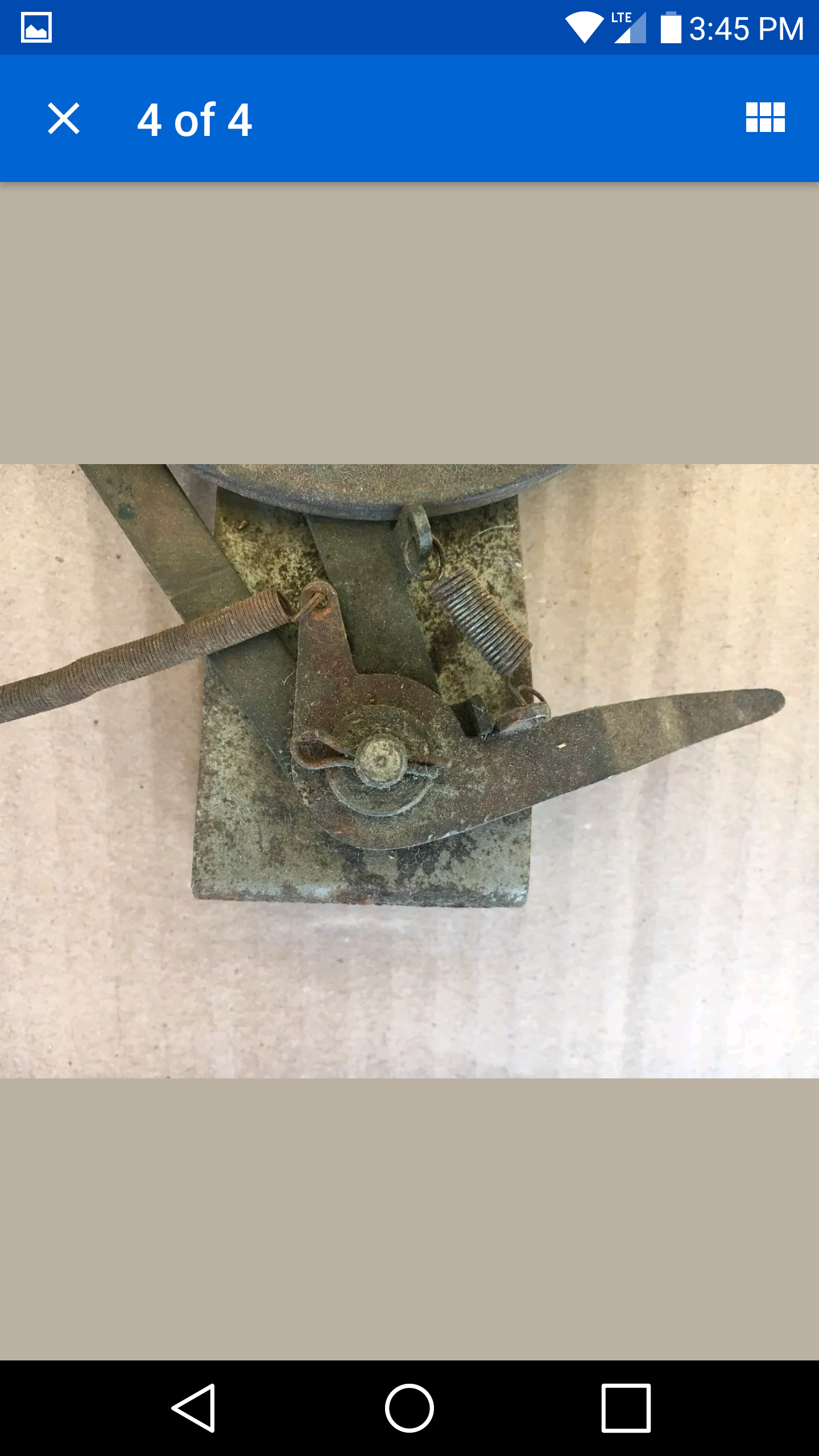

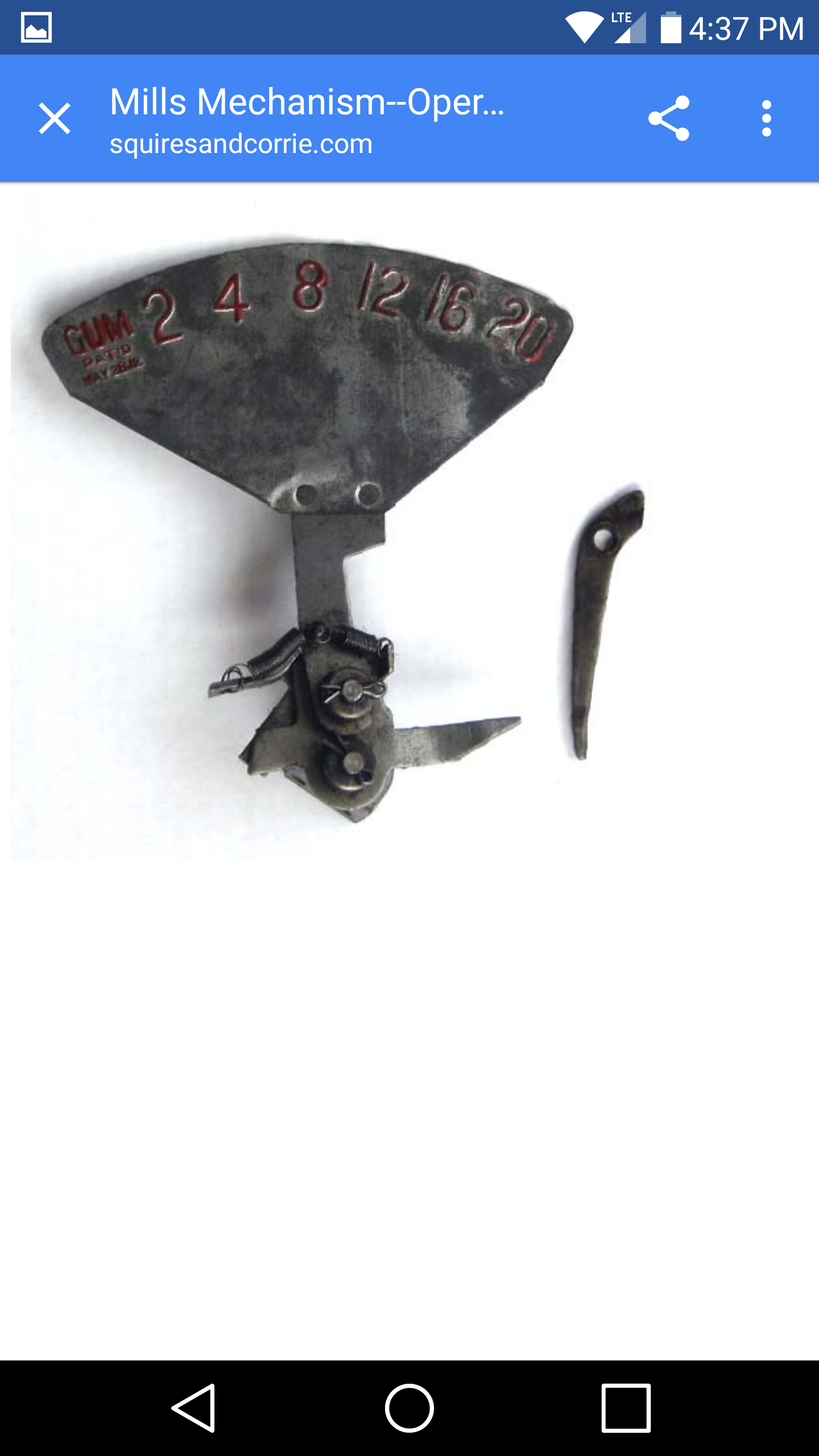

Re: mills operator bell future pay mech reset lever
Postby briank » Sat Mar 11, 2017 3:40 pm
Or is this yours? I may be barking up the wrong tree with these pics but if I am Im sure someone will chime in.

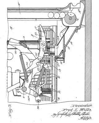

Postby briank » Sat Mar 11, 2017 3:41 pm

Postby gsx11r » Sun Mar 12, 2017 7:17 am
Hello
Here is all info that you need .
If you need more , let me know .
Stephane
Oups, D=2/8''; read : D=1/4'' , oopsss . :oops:

Postby captkid » Thu Mar 16, 2017 8:04 am
thanks for your drawing! - will make the part -
any chance you have a dimensional drawing of the bracket that bolts to the slide posts?
Jim
