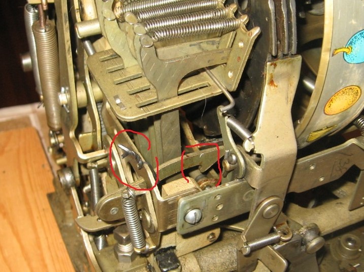

Bill, as I said, the hook was on the roller so tight that I had to remove the entire
anti-check payout assembly to free it. Then I reinstalled it and, at your suggestion,
secured the hooked lever in a permanent out-of-the-way position with a wire:
Mech functions correctly now!. Forced all payout combinations and they are dropping
coins properly. Fait accompli! NEXT step is to fix the escalator!
Thanks so much for your help. "The experts will fill you in with the rest..." -- that would be YOU, sir!

Glad it worked out.....but all my knowledge is from all the great members on this site. You won't need that wire if that lever is turned all the way to the back. What issue(s) do you have with your escalator. Pictures help a lot. I highly recommend picking up a book. I picked up two but one is more detailed than the other and highly recommended. When I get home I will send you the title.

In this case, I knew that it wasn't paying out because the payout fingers weren't penetrating the reel
disks. So then I had to determine what was preventing that. Once discovered, it's "Why is the 'anti-check payout hook'
holding back the 'payout pushback arm'?", and so forth . . .
