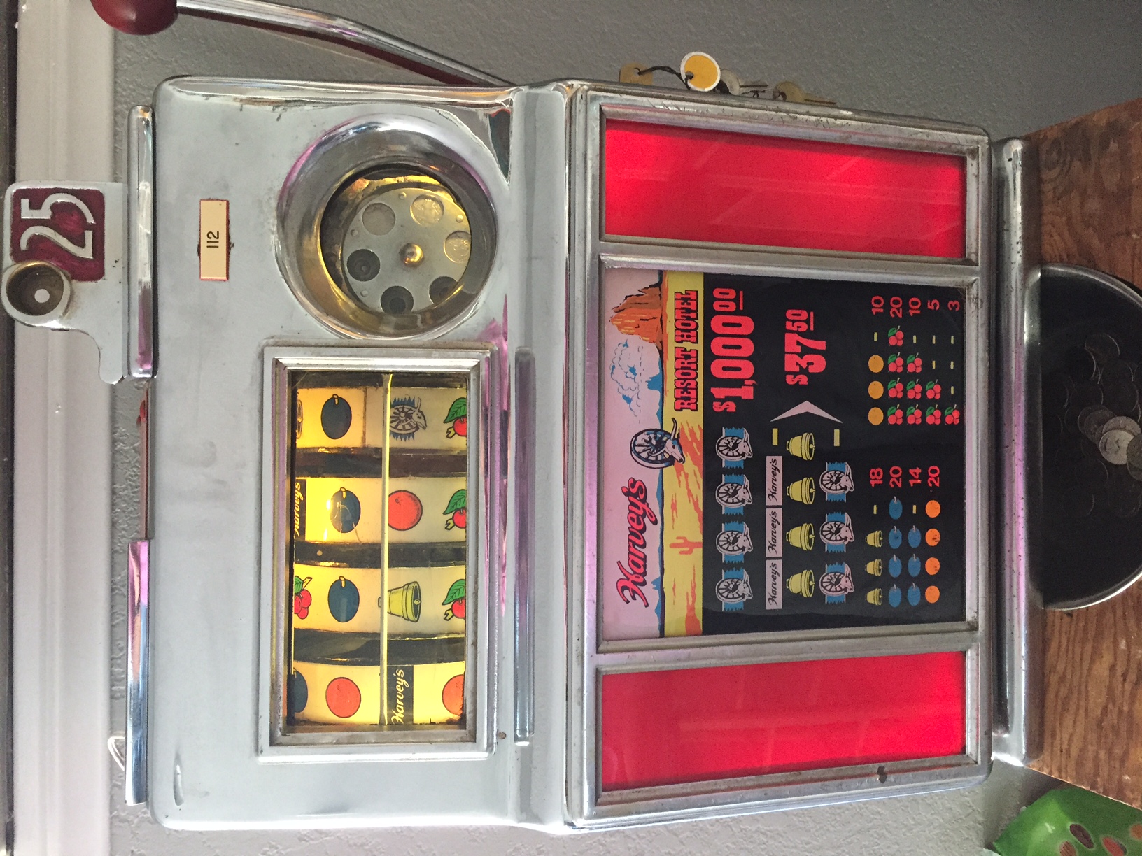

Not sure what I was thinking when I posted, but it's actually a Harvey's machine. Need to figure out how to post pictures. Not sure why this came out sideways.

Some times the photos (due to size ?) just show up like that but, click on it, it turns up right.

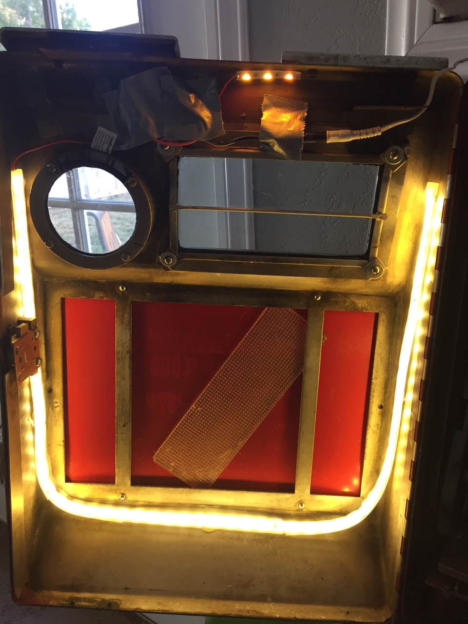

All the electronics were missing when I got and it definitely needed lights. Tried to figure out where the bulb(s) used to be located and found one mount in the upper right and a couple of broken rivets in the lower left looking at the inside as shown in the first photo. Too much work for me, so I installed a 3-foot white LED strip around the door.
The reels were still a bit dark, so I put in a 3-inch strip top center just above the reel window. The wiring and LEDs are temporary for now. Need to figure out how to run the power through the cast iron case, which will require removing the mechanism and drilling a hole. After that I'll solder all the connections and apply permanent glue to the strips and wires.

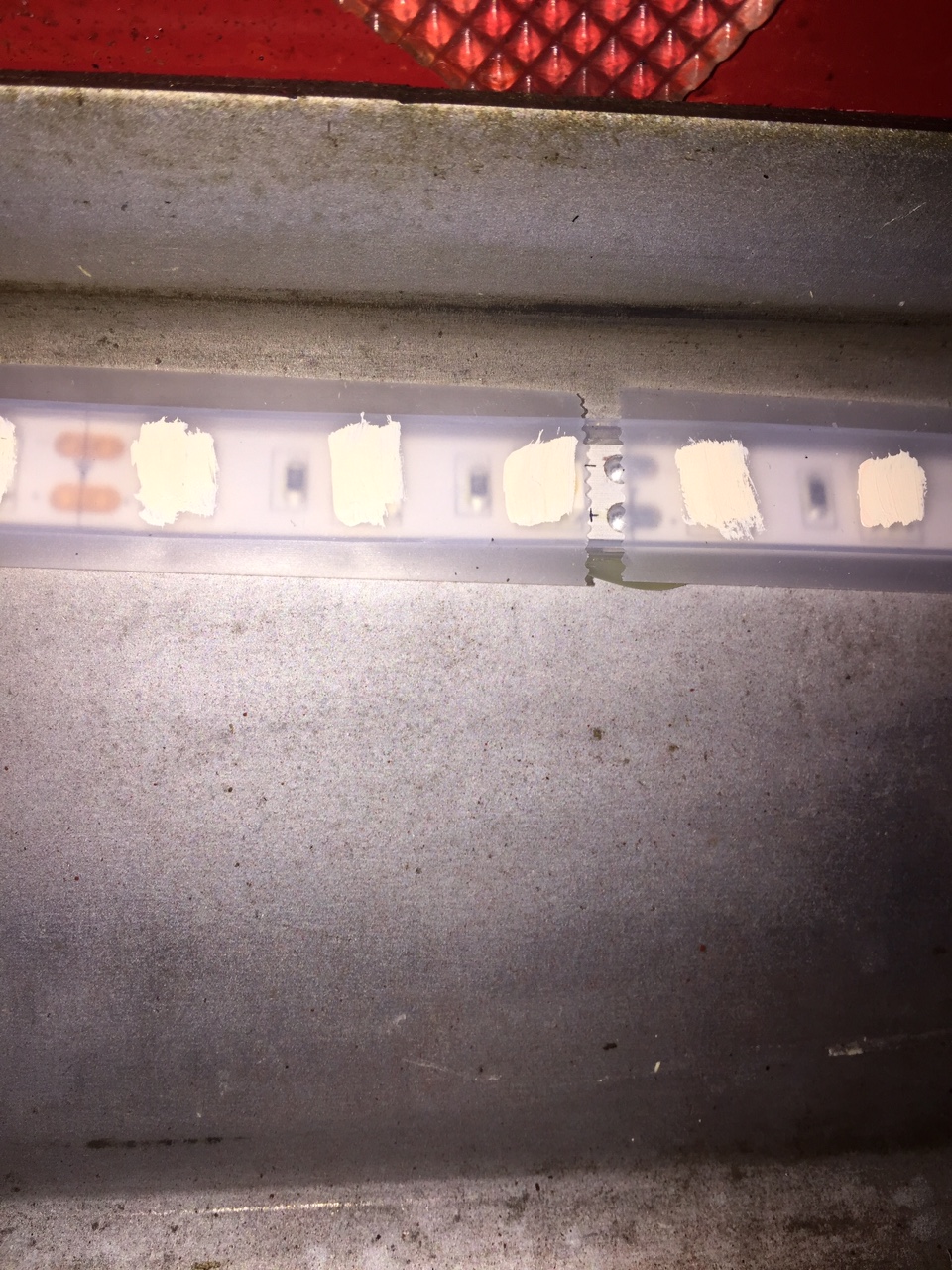

I used white 12-volt LEDs but they were too bright and too white. An artistic child of mine researched '60s-era incandescent lights and mixed up several batches of transparent paint. She covered the LED strips with scotch tape and painted each LED with the color mix. It took several tries to get it right, but peeling the tape off made it easy to experiment. Now that we have right color, she will remove the tape and paint directly on the LEDs. You can see the tape in the second photo. I used a flash so it's very white in this photo.
