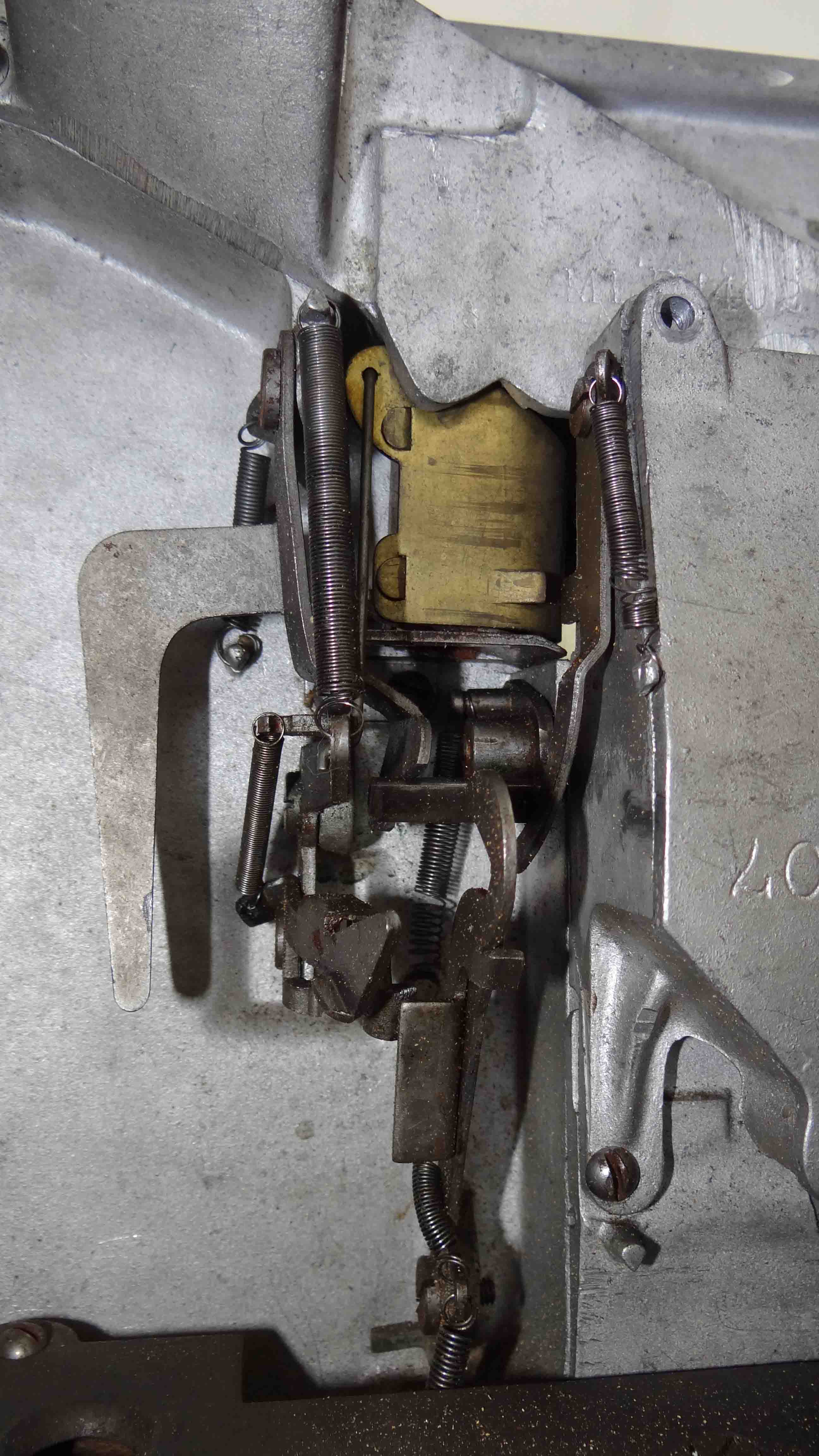

Hi

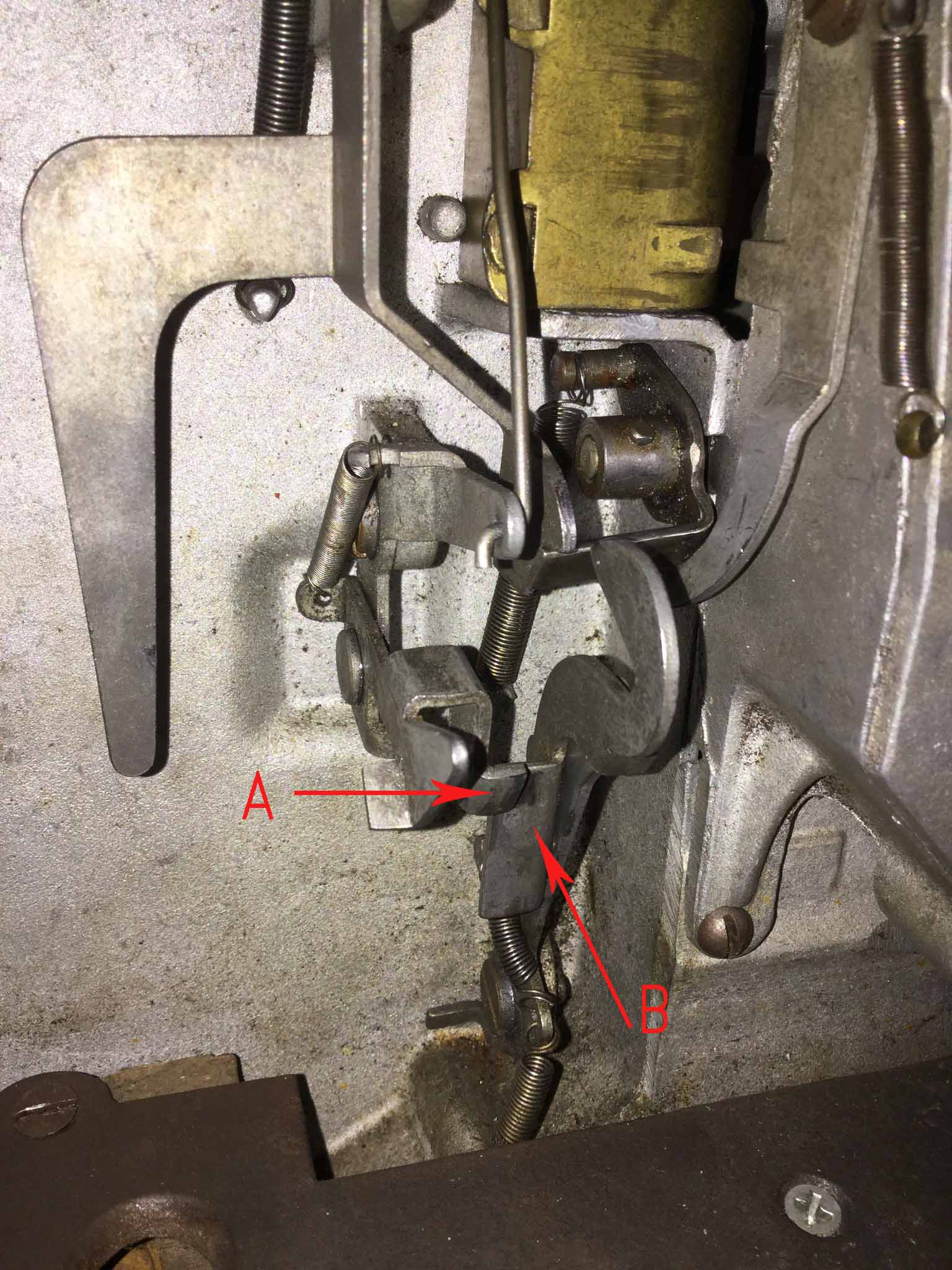

I think that the "A" part must to be on back of the "B"part.
Like mine:
For info , your jackpot model are uncommon on Poinsettia. It s more easy to find the other model .
But Don t worry it s original ,and are complet on your machine .
let me know , and if you have other trouble , let me know and I will check on mine !

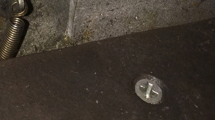

And PLEASE , remove this screw and use the good one !!
Stephane

Re: Poinsettia jackpot problem
Postby Major Kong » Sat Jul 08, 2017 2:46 pm
Thanks!!!
Removed top front piece and watched unit cycle.
Then took another piece of advice, removed a few of those bad screws (referenced above) and slid the bottom plate forward. Everything now works correctly (jackpot and reserve). Special thanks to the forum and those who responded :D
