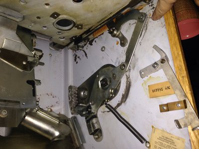

Postby aldiener » Fri Aug 04, 2017 8:28 am
Good day everyone,
I have identified an issue that I think is contributing to my problem.
In the photo, where I am pointing, the two pieces separated. There is no place
for a cotter pin and I am not sure why this is suddenly happening. It has only
become an issue since I installed the new operating fork spring which could
be entirely coincidental.
I would appreciate your thoughts and/or suggestions on this issue.
Thank you for your time and consideration.
Warmly,
Amy

Postby mechanic » Fri Aug 04, 2017 5:56 pm
Seems like you need to release the ratchet pawl so it can go back to zero. The inside handle starting lever pushes down on the part with the bearing on the end out in front. Follow the form of the part till you see the serrated curved top, the ratchet is just above that. You will need a screw driver and heavy duty needle nose pliers. Take the screw driver or if you have a starting lever handle push down on the bearing part and at the same time put the needle nose on the ratchet and turn it clockwise till it releases the starting lever. Let the lever come up till the ratchet is in front of the serrated top part. This should clear the problem you have at present. You will need to look for the cause which may be a coin jam in the slides or some other problem. Good Luck
