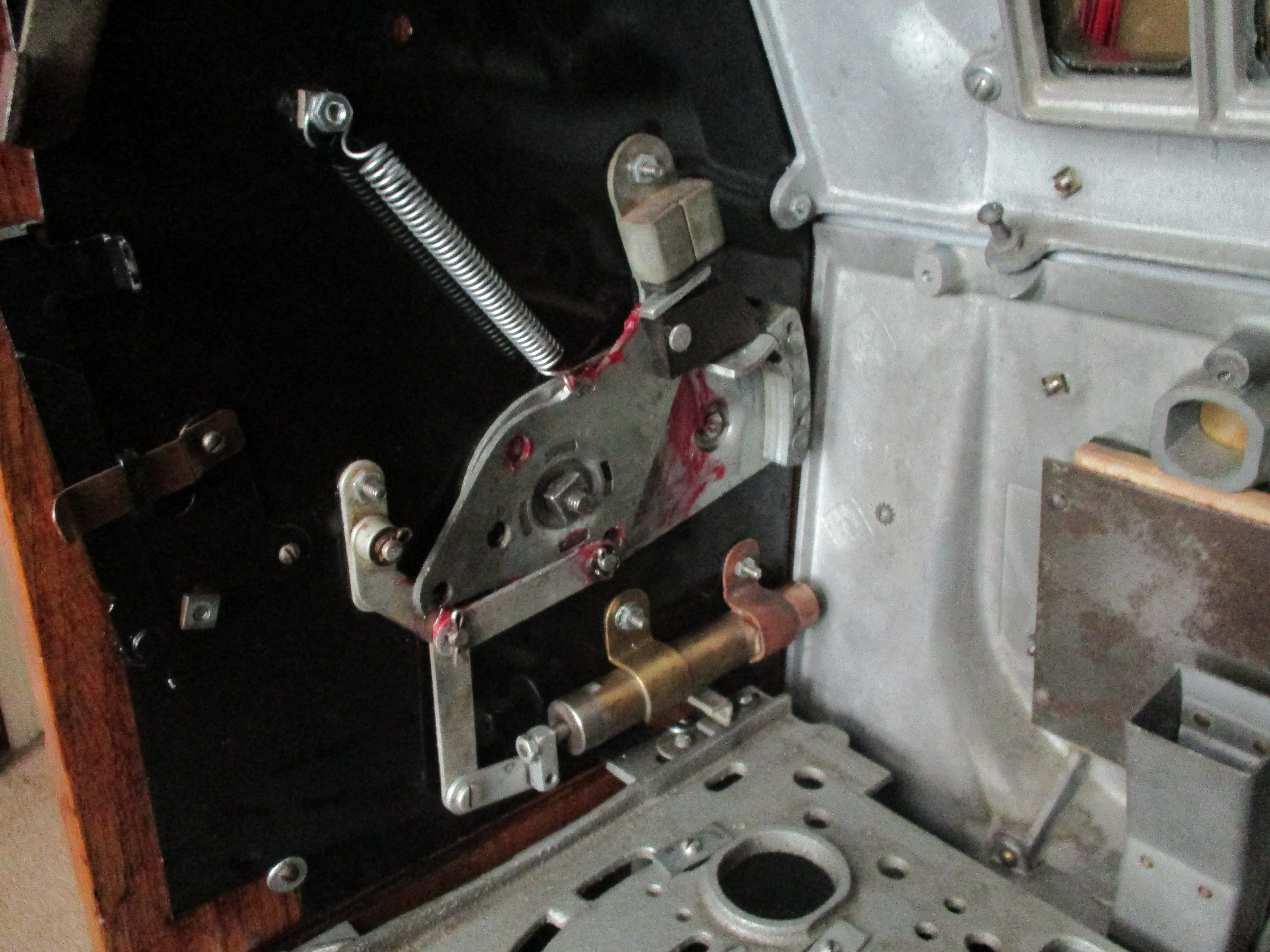

This is what I have tried so far, I unsolidiered one end and found that there was a small piece of gasket material which was worn and that the cylinder was out of oil. So I replaced the gasket piece with rubber of appropriate thickness, put some hydraulic oil in the cylinder, and resolidiered it. The handle worked properly for a while, but now it has quit working again.
Should I use leather or gasket material instead? Also, What type of oil os best to use in these small cylinders?
Thanks for any help anyone can offer!
