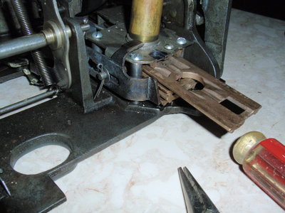

mechanic wrote:Looks like a Mills Poinsetta. If its a 2-4 pay then the thinner 2-pay slides go on the top and bottom of the stack with the remaining thicker 4-pay slides in the middle. To do it properly you need to remove the coin tube and slide cover first then reattach the slide springs to the bracket in back and replace the cover and tube. Be sure to get the rake off arm back into position. Its the flat piece that sticks through the top back of the tube. I almost always forget to do it myself. Jim
oldslotman wrote:mechanic wrote:Looks like a Mills Poinsetta. If its a 2-4 pay then the thinner 2-pay slides go on the top and bottom of the stack with the remaining thicker 4-pay slides in the middle. To do it properly you need to remove the coin tube and slide cover first then reattach the slide springs to the bracket in back and replace the cover and tube. Be sure to get the rake off arm back into position. Its the flat piece that sticks through the top back of the tube. I almost always forget to do it myself. Jim
If it is a 2/4 pay, the top four slides are the thicker ones. They should be from the bottom up 2 2 4 4 4 4 . The payouts are 2,4,4,8,8,12,12,16,16,20.
