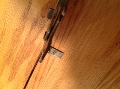

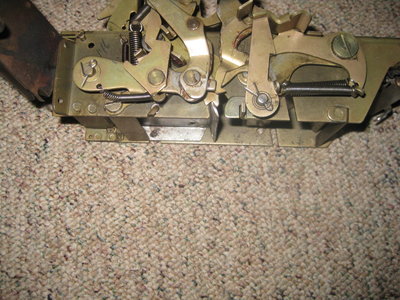

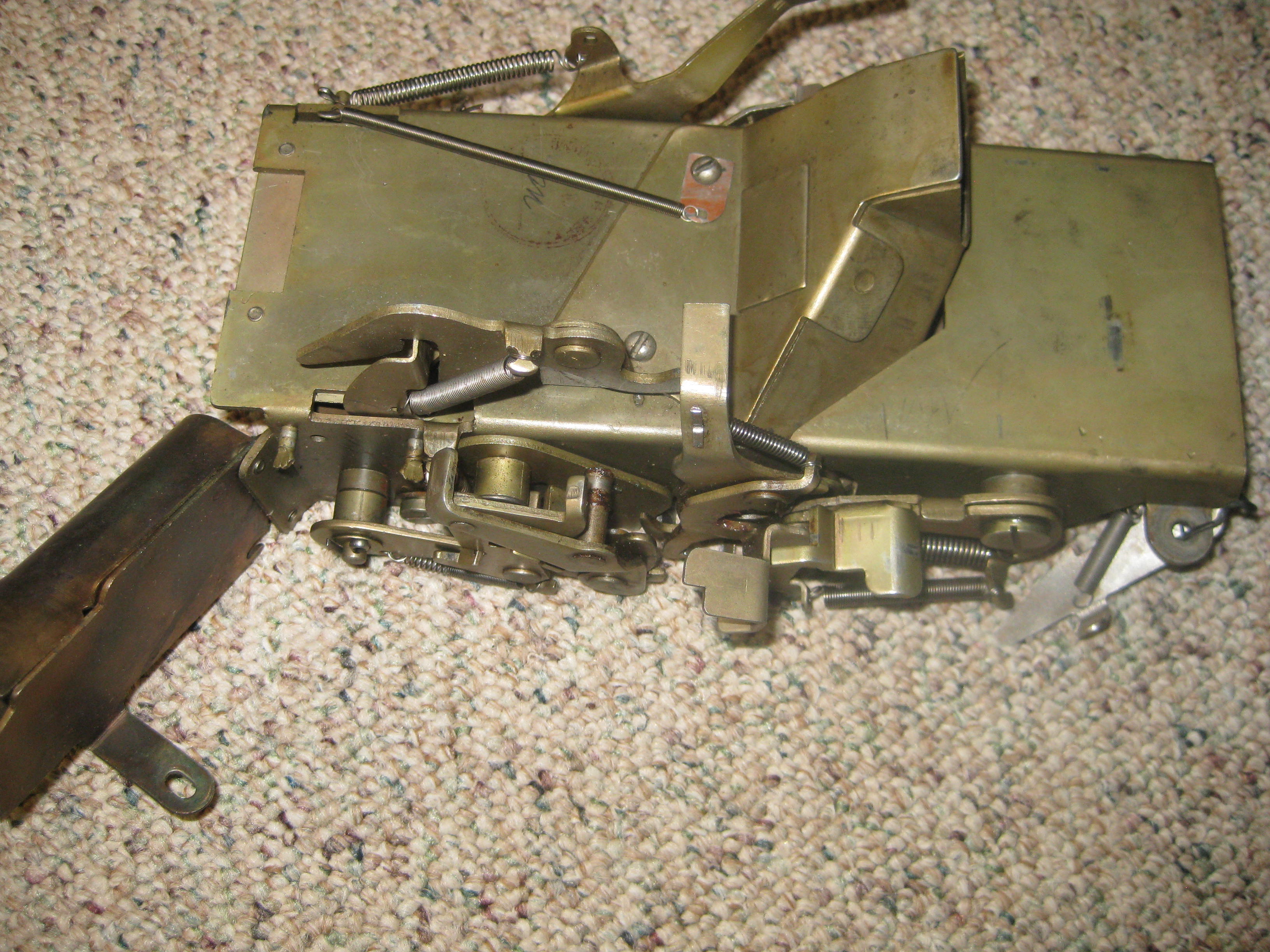

Can someone tell me if the photos i attached are normal. The mechanism appears to be bent. If it is i will purchase new one
Don't want to spend money needlessly. Thanks for any help. It is part of the jackpot ass'y on a Mills high top special award 777. The jackpot paid out but the reserve didn't drop. The rear chute has a bad lever, it needs replacing as well. Someone tried to weld it back together. Binds up

It is suppose to be bent. Looks like it maybe ok but hard to tell without seeing it mounted on the jackpot.

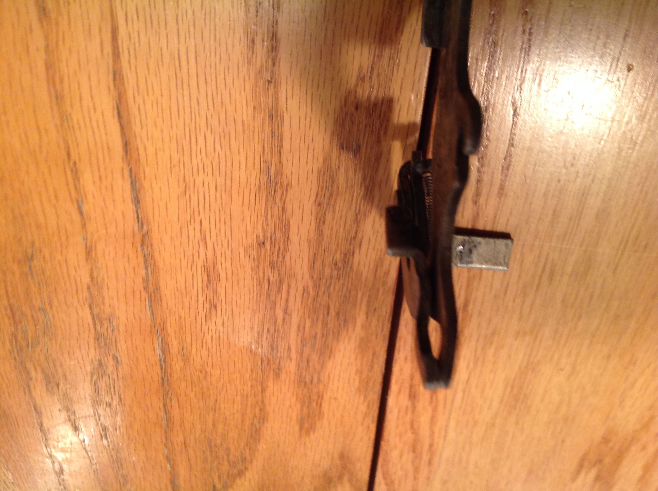

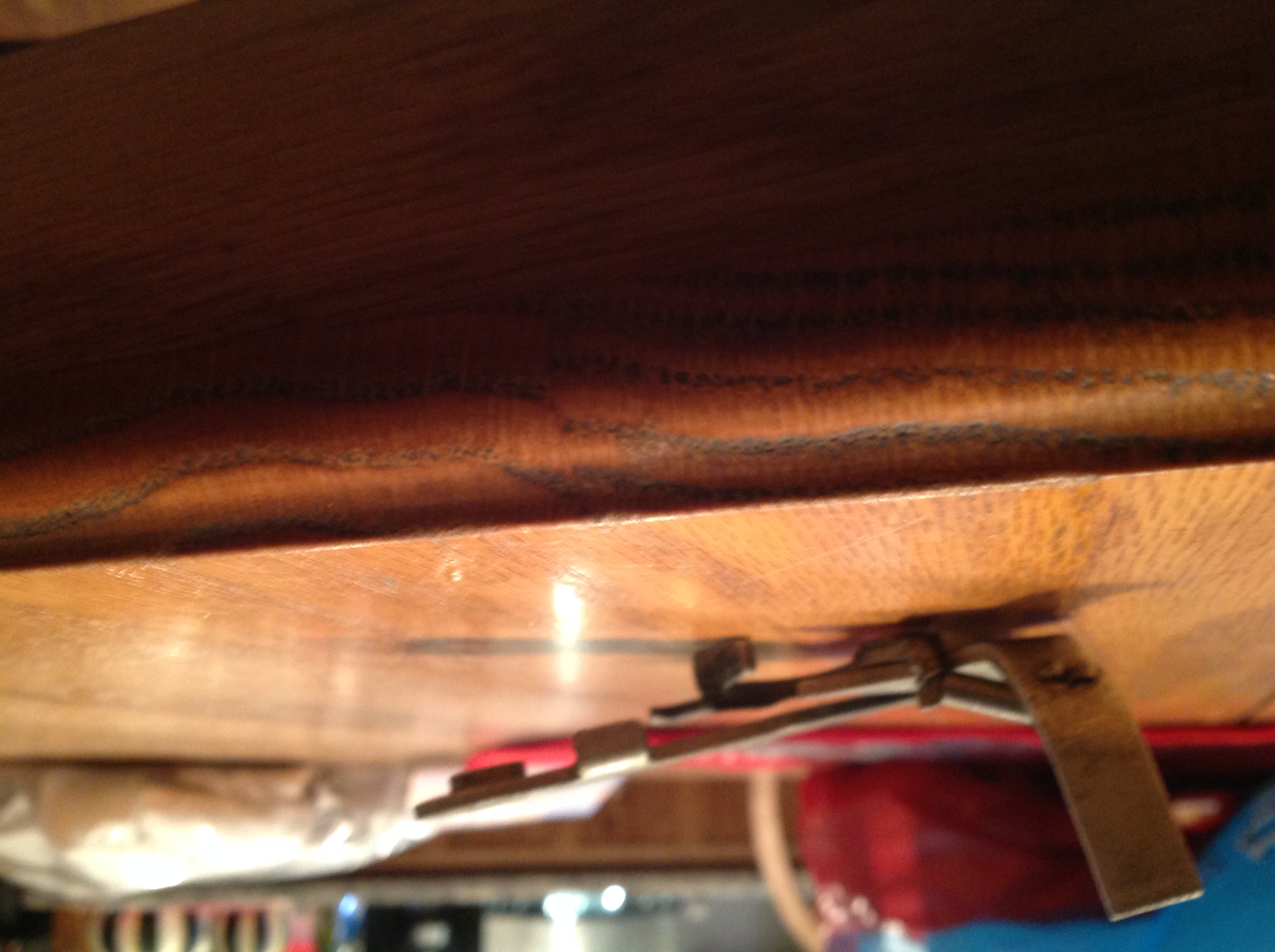

in the bottom photo, is the center suppose to be bent where the u shaped space is? the two ends go in opposite directions. that was one of my main concerns. i will have to upload another pic showing my other concern.

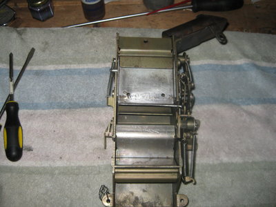

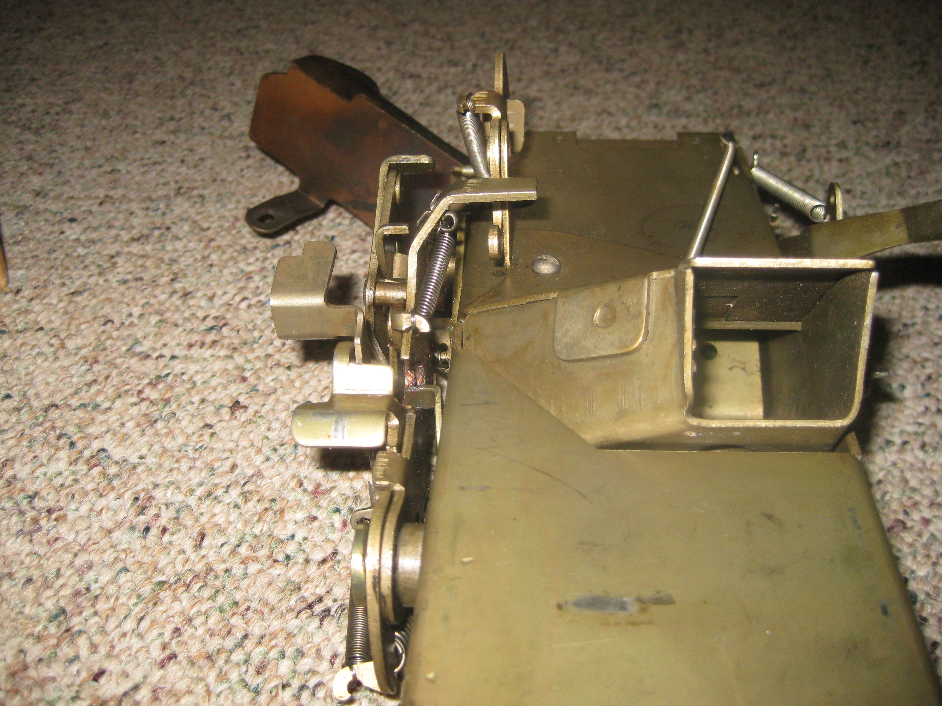

Here it what it should look like on the jackpot.
