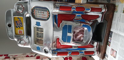

Almost new to this forum and now I need some help. I found a club chief and I know it is not a rare machine in the United states but since I live in sweden this is a very nice and scarce find.
Unfortnately it does not have matching numbers and the nickel plating does have more than wanted marks and imperfections.
But what to do when slots is very hard to found over here.

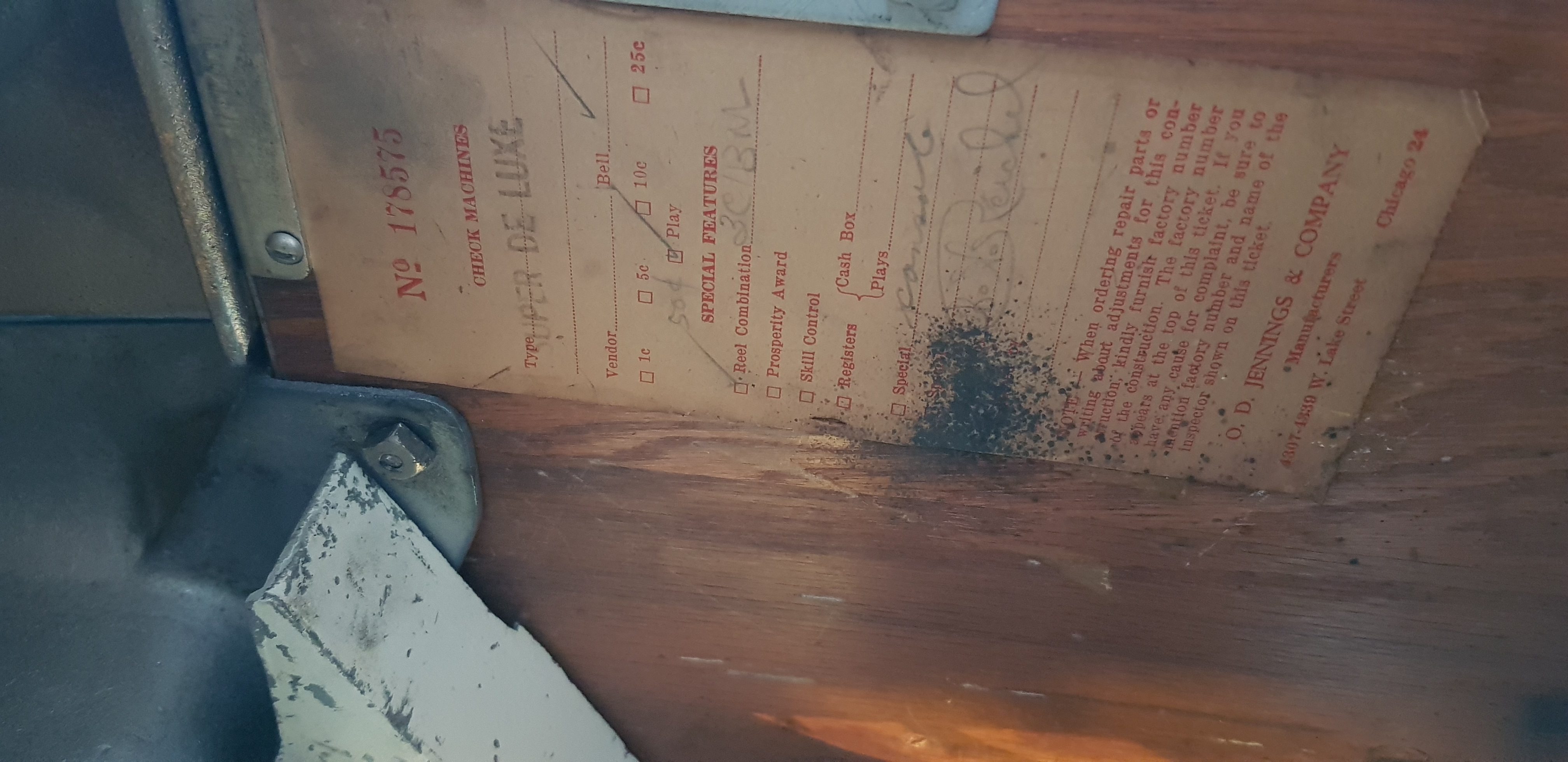

Anyway, serial number of cabinett is 178 575 and reel mechanism is 181793.
So my questions. What year can the cabinett be from and the reel mechanism acording to the serial numbers?

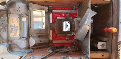

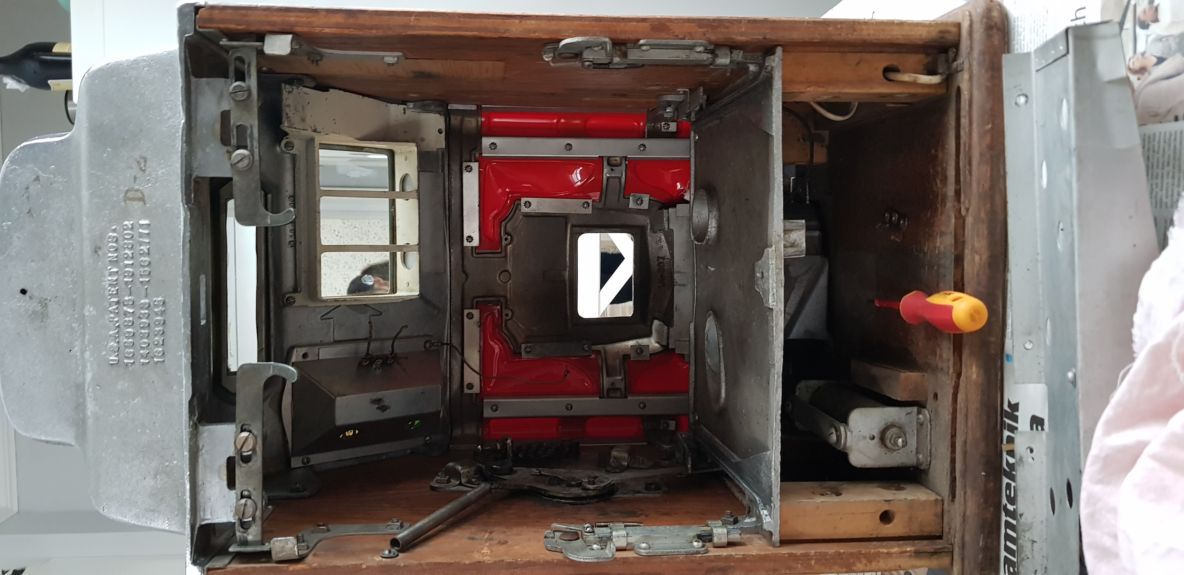

My biggest problem is that almost all the light parts are missing. The only part I have is the left "light gaurd" that the light bulbs are supposed to sit.
So transformator, all cable assembly, top bulbplate is missing and bulb holders for the reels. The main conection in the bottom is still there.
So, I would be very happy if someone have those parts for sale.
Further more I've not make up my mind if I'm going to re plate the fronts. Suggestions?
I will dissamble the cabinett and sand the wood and put on new laquer.
It seems to me that the escalotor and cointube and coinslides is for quarters. As the top sign says.
However on the tag it is handwritten 50 cent?
The machine have been running in swedish 1 krona coin and a american quarter and swedish krona is nearly identical so I guess thats why qaurter machines is most common here. No need for modification.
Hopefully someone have or can point me to someone thats have the missing parts to sale.
Sorry for bad english.
Best regards
Christian
Edit: The funel at the award card is still there and the"funel" for the reel lights.
So transformator, right frontgaurd, top "funel" and most cable connections, cable assembly and lightbulbs is missing.
See pictures.

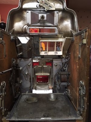

If someone could take a good picture of the inside of the cabinett of a club chief or sun chief with lights I would be very gratefull. as you can see a lot of stuff regarding the electric is missing and I would like to see how the original cables where routed and also where the fuse holders where located.
Would also be nice to see how the cables where routed from and to the transformer.
Thanks
Bingobelle
Posts: 12
Joined: Wed Jan 17, 2018 11:21 am
Re: Jennings club chief super delux
Postby oldslotman » Mon Feb 05, 2018 7:56 am
Hope this helps. Same machine you have
Postby Bingobelle » Mon Feb 05, 2018 11:39 am
Thank you very much old slot man.

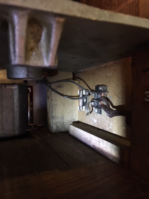

The only thing I do not see clearly is if it is a fuse holder above the transformer. I gues the thicker black cables goes into a fuse holder and a ground point. If possible a picture of that area would be very apreciated.
Other wise I guess I have a clear picture of how it should look to be as factory as possible.
Of course I could just make it work ( I work as a electrician ) but it is the look of "factory made" I´m after.
Thanks
Bingobelle
Posts: 12
Postby oldslotman » Mon Feb 05, 2018 12:36 pm
The fuse is down in the cash box area. Fuse is before the transformer
