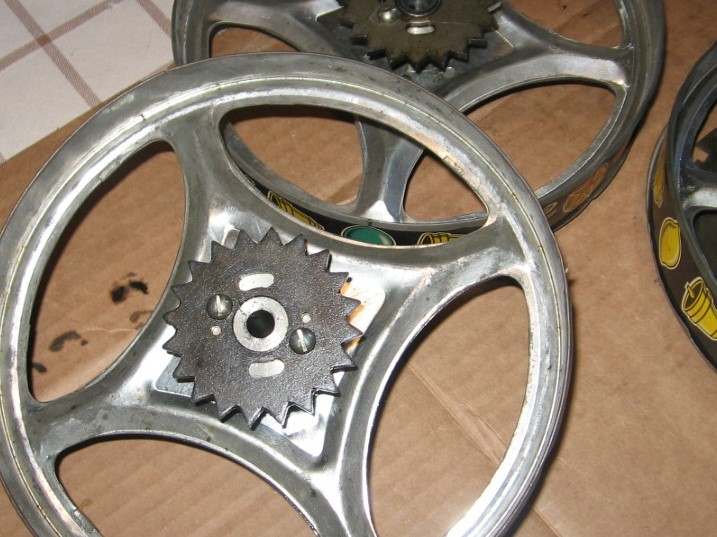

Makes sense . . . so here are reels one and two. How would you go about make the adjustments?

Re: Payline alignment
Postby oldslotman » Wed Mar 14, 2018 9:39 am
You make adjustment when the reel bundle is all together. The adjustment on those two is done with the 2 bolts that hold it on the reel shaft. Leave the bolts loose then hold the reel where you want it and then you can line up the reel disc then tighten the bolts. Those two reels rotate on the shaft and are pretty easy to line up once you figure it out. You have to line up those two reel disc with the third one. These adjustments are done with reel bundle installed on the machine.

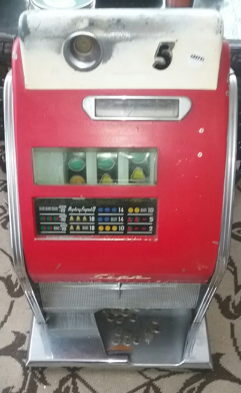

Postby marsonion » Wed Mar 14, 2018 9:50 am
I'm seriously doubting this notion that the first two reels somehow went "off" while the third somehow stayed "on." Look at the payout-line picture again: it is shot at an unnaturally low angle. You can hardly see into the escalator window, for instance.
Added note: Here is a picture of the same machine, shot from a too-high but nevertheless more natural viewing angle. Do you still want to line everything up with the third-reel symbol--? [BTW slots are often photographed from weird angles to avoid a blinding back-flash reflected off the reel window, or worse, recording a goofy image of some guy holding a smartphone.]
Postby edgeCity » Wed Mar 14, 2018 1:50 pm
oldslotman wrote:You make adjustment when the reel bundle is all together. The adjustment on those two is done with the 2 bolts that hold it on the reel shaft. Leave the bolts loose then hold the reel where you want it and then you can line up the reel disc then tighten the bolts. Those two reels rotate on the shaft and are pretty easy to line up once you figure it out. You have to line up those two reel disc with the third one. These adjustments are done with reel bundle installed on the machine.
OK -- I'll give this a shot. Before I reassemble the bundle I'm going to clean off the (very) old grease from the disks, starwheels, and axle/axle housings. What lubricant should I use when I put the bundle back together?
