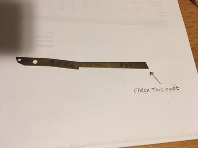

Your problem most likely is the bottom payout finger which holds or releases the master slide which is the three coin pay. It is most likely rounded off on the end where it contacts the masterslide. This will cause the masterslide to slide by the payout finger and release the three coin payout. May not do it all the time. You should also check the spring on that payout finger and make sure it is being pull back into position to hold the slide back. Sometime that bottom finger can get hung up and not get back into position the hold the slide back.

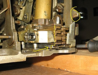

OK -- back to this problem. I can see how the condition you describe with the bottom horizontal payout lever (finger) could develop over time, as the master slide is involved in ALL payouts! Moreover, I observed that when my mech is "cocked", the master slide doesn't come forward with the other slides as it should:
Reading in my "Owner's Pictorial Guide . . . " (Geddes) it looks like I pretty much have to take the mech apart to get to (or even see) the bottom payout lever -- is there an easier approach? If not, I may defer the resolution of this problem until I do a restoration on this machine!

Postby oldslotman » Wed Apr 11, 2018 9:11 pm
The master slide pushes all the other slides forward. It also appears that you have 3/5 payout slides.
