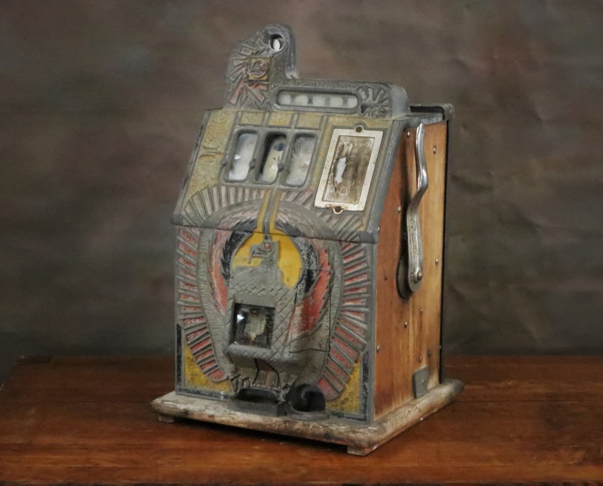

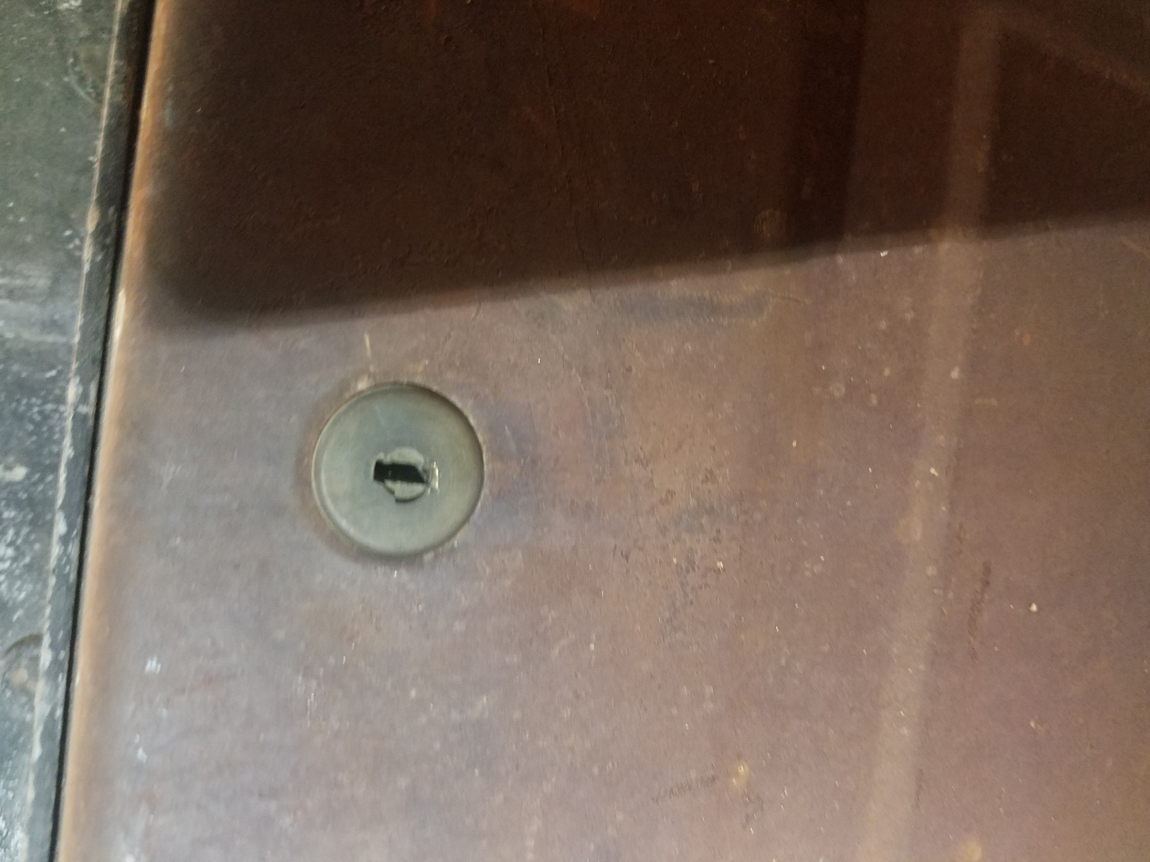

Just purchased my first antique slot 1931 25 cent War Eagle. I can't access the cabinet to assess the internal components. My first instinct to to drill out the lock. However, some more seasoned collectors have encouraged me not to do it. From my research here are my options:
1. Break the escalator glass hope the lock is accessible to unscrew
2. Somehow access through the cabinet
3. Locksmith (if you have recommendations I am In the Kansas City area)
4. Drill out the lock buy a replacement
Attached are photos. Your feedback helped me tremendously on my last restoration. I look forward to your input.

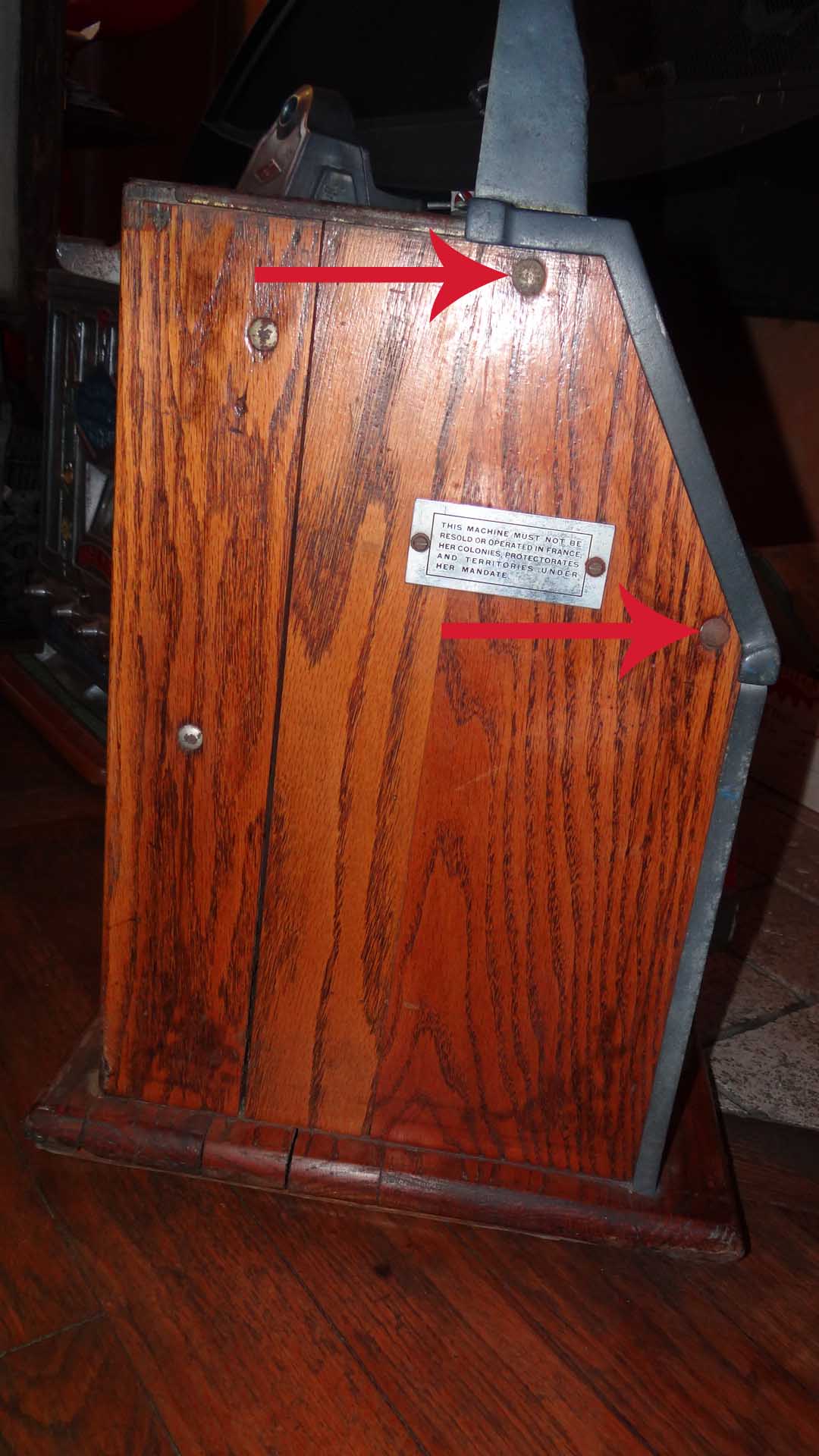

On back of the front casting , you have this screw ,for keep the two casting together .
Sometime the screw is too tight but sometime it s loose !!
So ,As I say ,if you are Lucky , you can drill the 4 screw head of the top casting on each side ,and when the head go away , just push the screw Inside .
As this and only if the screw Inside is loose , you can remove the front casting , and magic , you can remove the lock screw also !!
Or maybe just be able to move the front casting for have acces to the lock screws !
Whatever, You can test, it s just 4 screws to destroy !
:D
Be careful and Let me know if you are Lucky !
