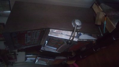

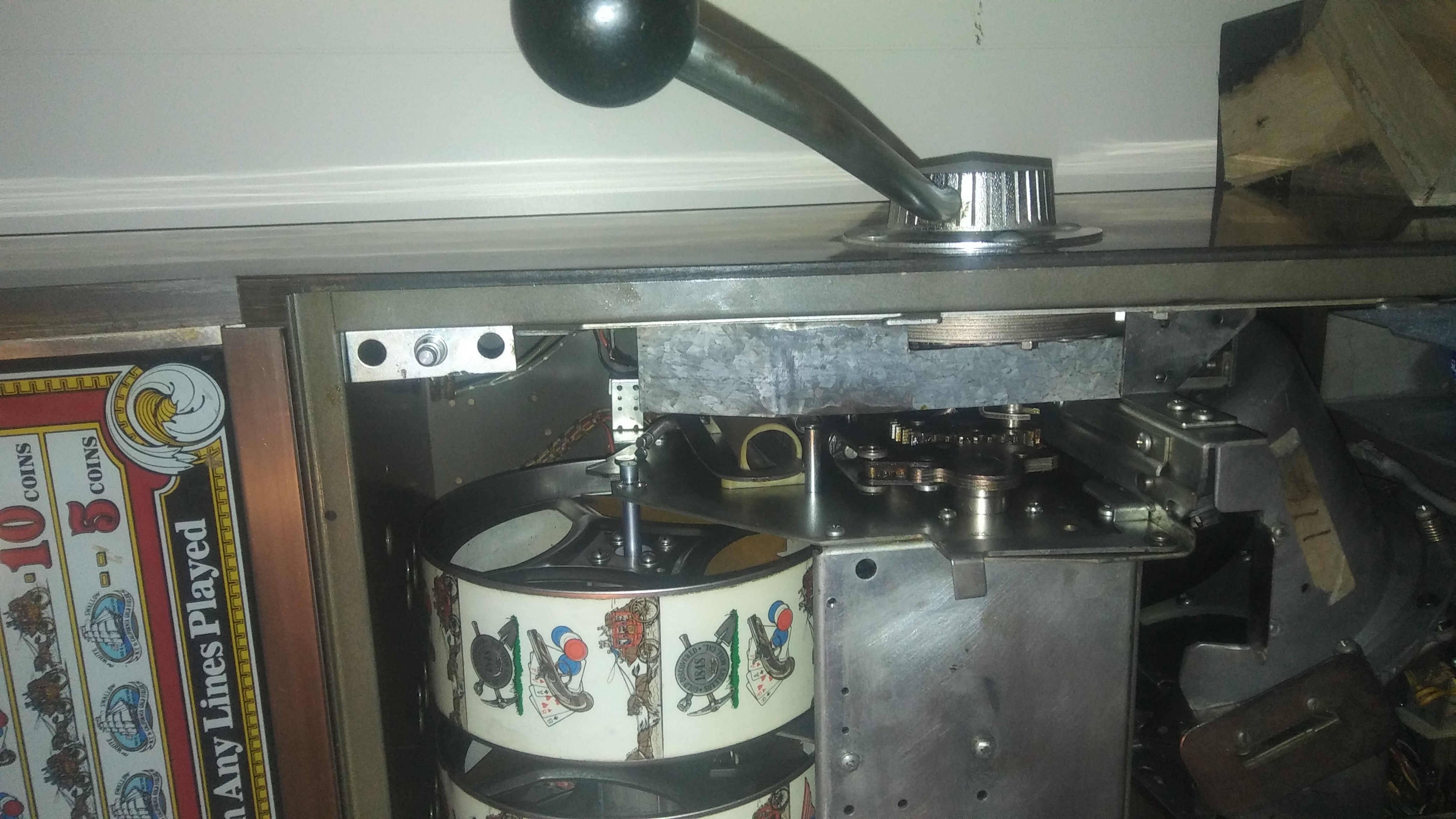

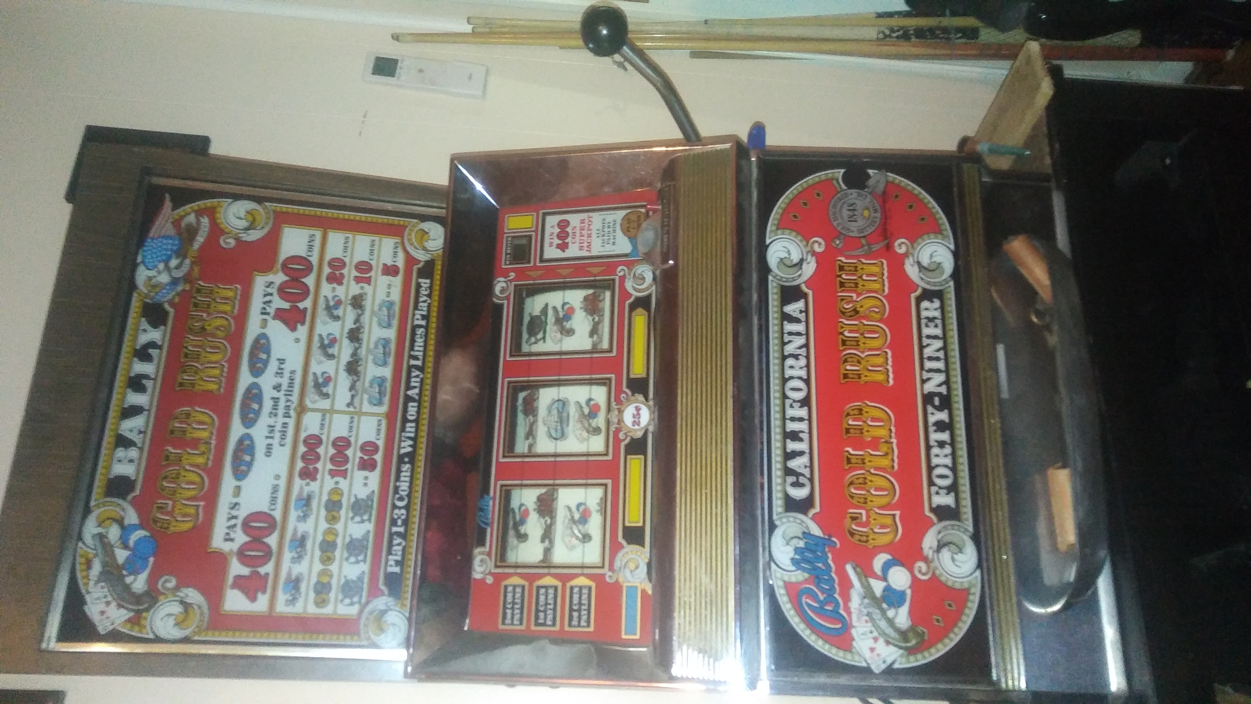

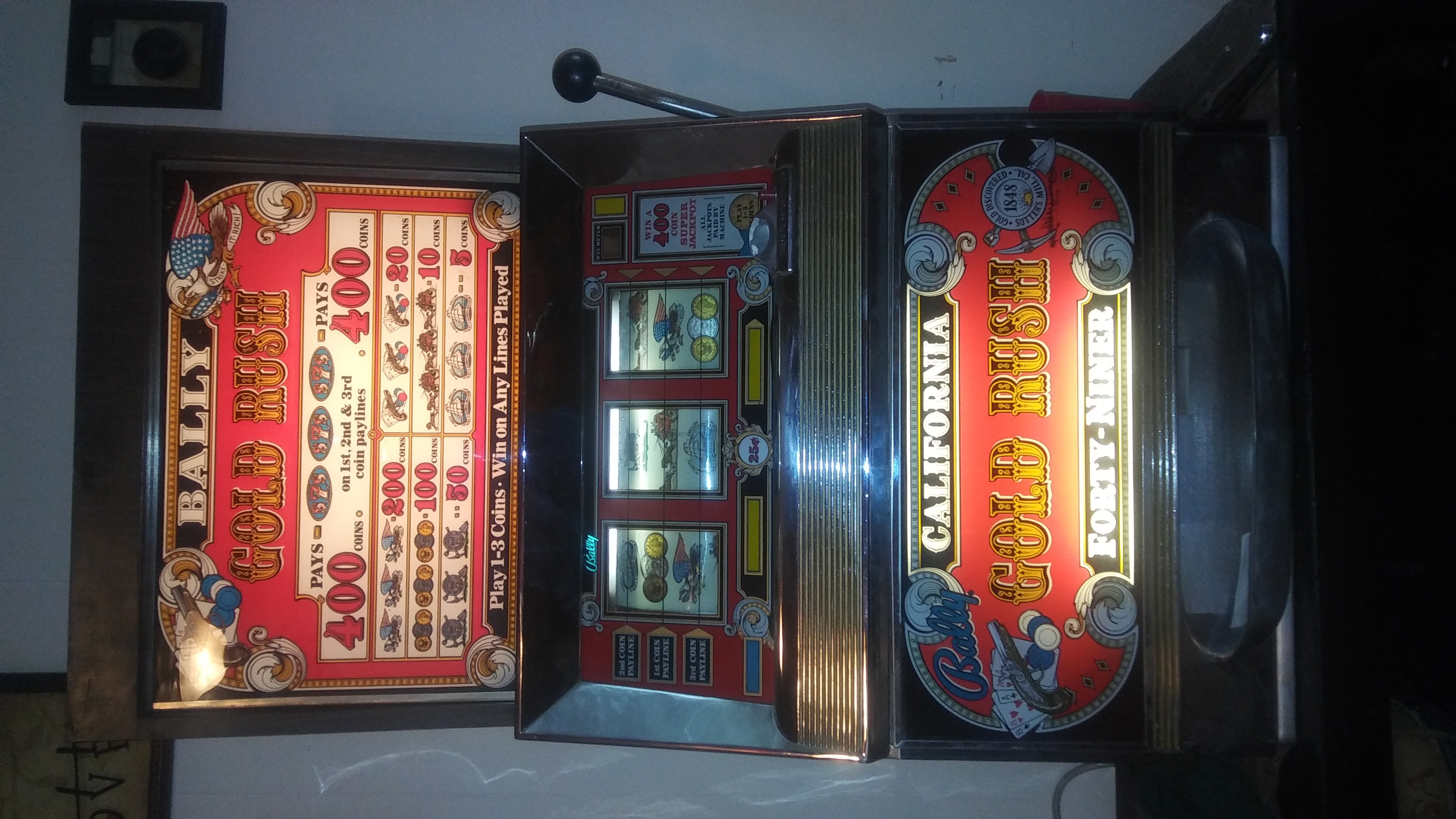

Hello all...I have a ballys. 49'er GOLD RUSH...my problem is...the handle is in the almost forward position...its jammed....I dont wanna loose a finger by poking around inside with all that potential energy in the mechanisms...please help...if this works out I have a nickel machine that has a minor issue as well...I look forward to hearing from you all.

What u need to do is remove the inspection cover on the handle mech what u will see is a fast play dog pull down on the handle and release the dog from the teeth and the handle will go back to the rest position that way you can pull the mech out and try to determine whether your problem is in the handle assembly or the mech.

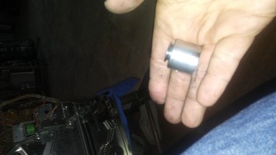

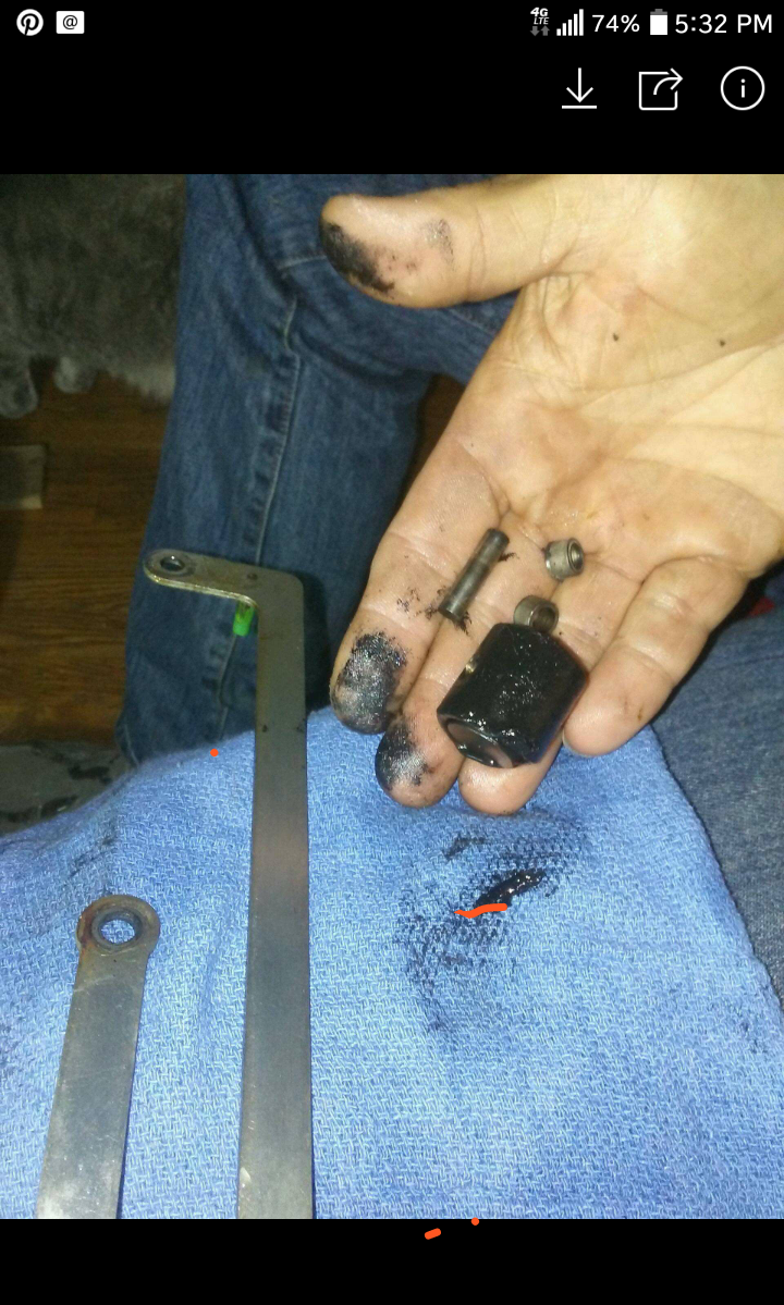

BIKERJRM....YOUR THE MAN!!!.....I DID WHAT YOU SUGGESTED...the piston was filthy...cleaned it ...reassembled it....and played $60 just to test it....runs like a clock..
