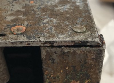

Postby d12bn » Tue Aug 14, 2018 9:13 am
Anyone have experience with these type of fasteners? I'm assuming I would have to drill them. But what would I use to go back together?

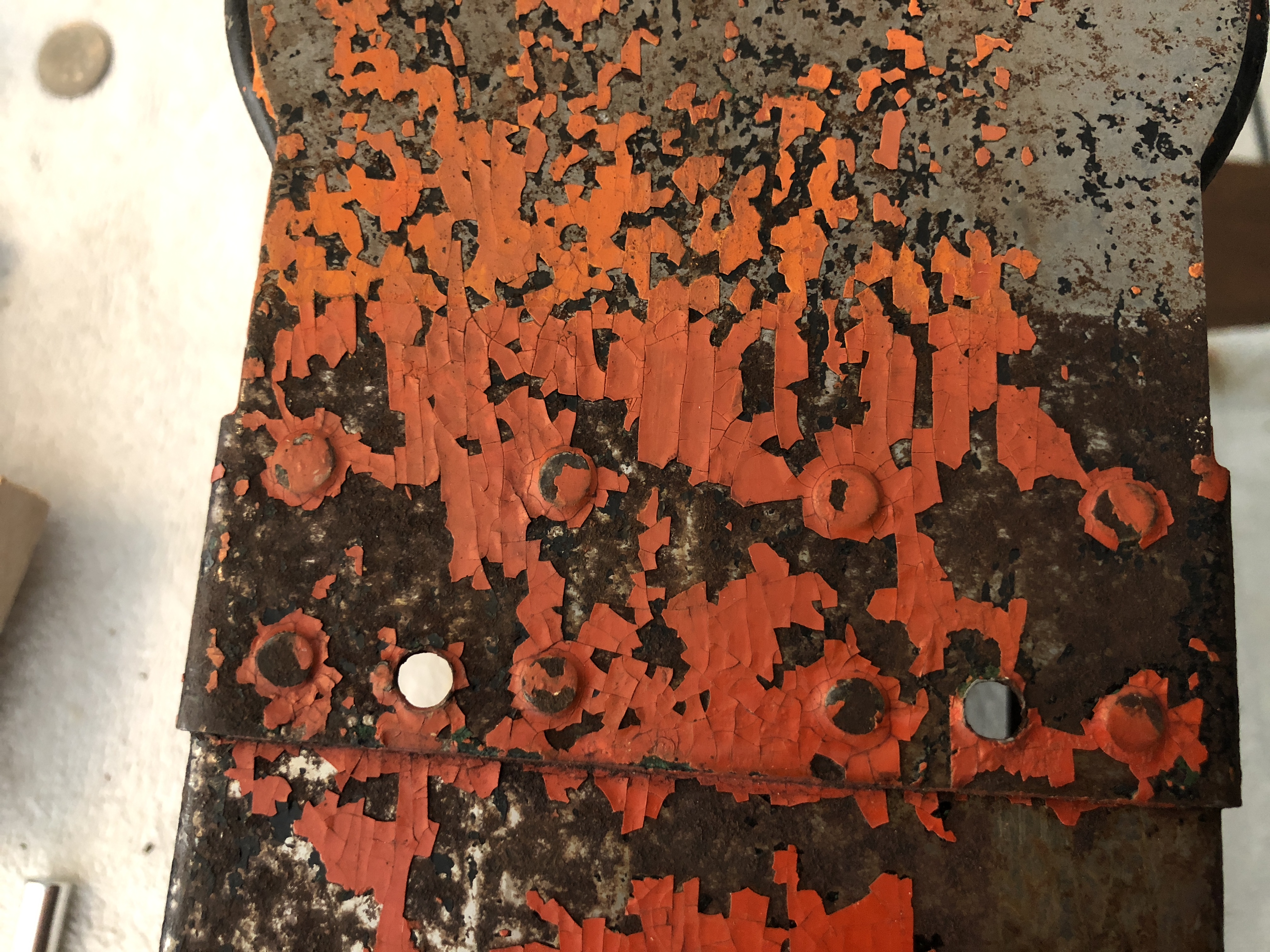

Postby d12bn » Tue Aug 14, 2018 9:54 am
Another picture. I could drill them out and replace with rivets however they are not flush on both sides which would block the matchbox from vending

Re: Help with fasteners
Postby RameGoom » Tue Aug 14, 2018 4:28 pm
I believe those are called Leather Rivets or Solid Rivets. They make them in brass, steel, aluminum and stainless steel.Brass would be your best bet as it is ductile and flattens on the back end easily.
Here's a source:
https://www.rivetsonline.com/rivets/solid-rivets
