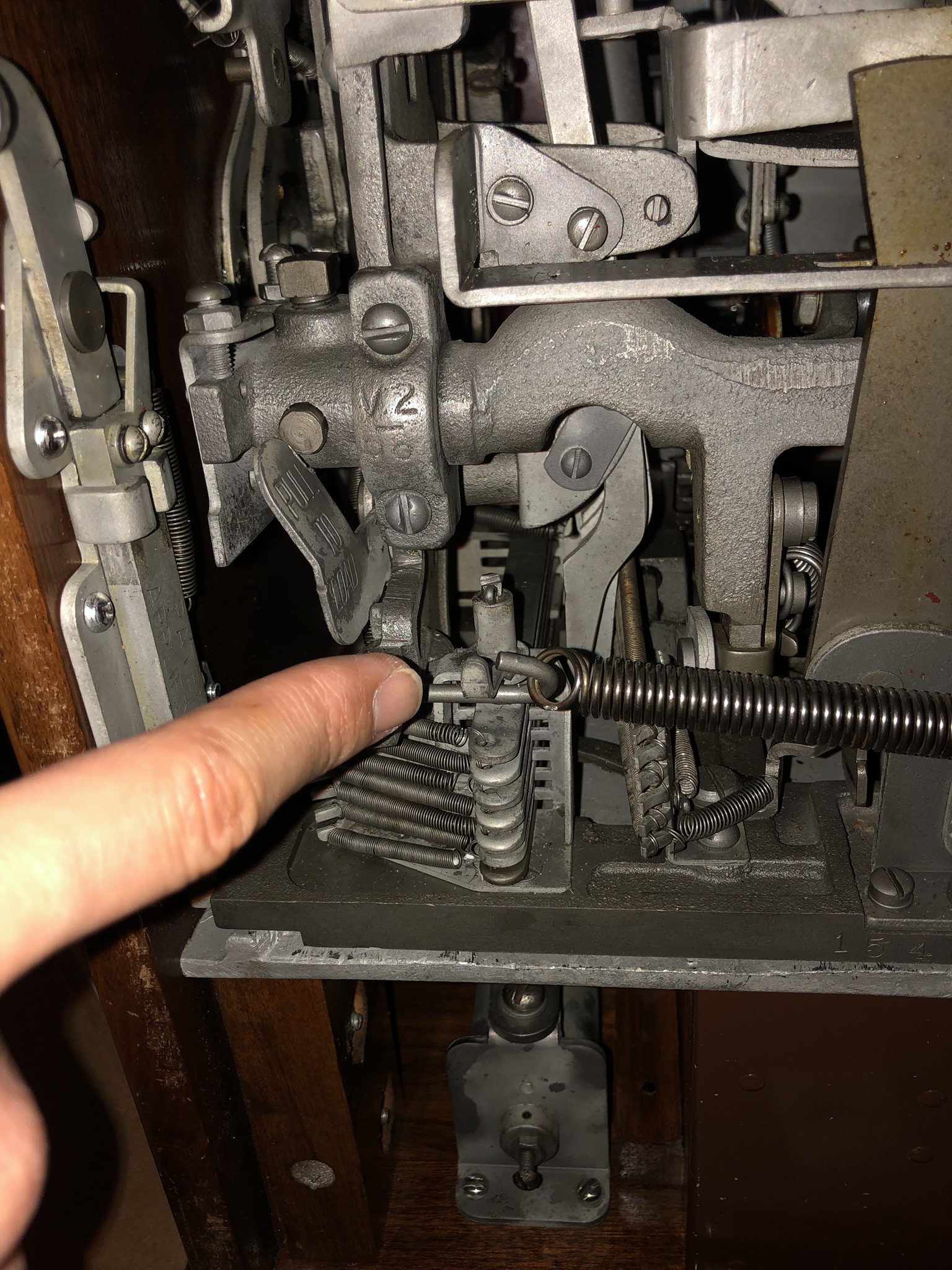

Postby MLStrauss » Wed Dec 26, 2018 1:30 pm
Thanks for the helpful suggestions, @mechanic! Something was definitely off on the clicks and plates. The good news is that it will payout - but not the right amount and not necessarily when it’s supppsed to. I’ve attached a couple of pictures — the only thing we can figure out is that it pays out somewhat randomly when the little lever shown is to the right, and not at all when it’s to the left.
Would love any further assistance — again, many thank!
MLStrauss
Posts: 3
Joined: Sat Dec 22, 2018 1:42 pm
Re: Jennings Sun Chief - not paying out
Postby mechanic » Wed Dec 26, 2018 9:56 pm
That part is the check (coin) tube unloading arm. When engaged it keeps the horiz. fingers from resetting. This allows the coins to drop on every pull of the handle unloading the tube. The other position allows the tube to fill and releases the fingers so they pay out as they are supposed to. That may also be the problem your having. Flip in each position and watch the operation of the horiz fingers.
