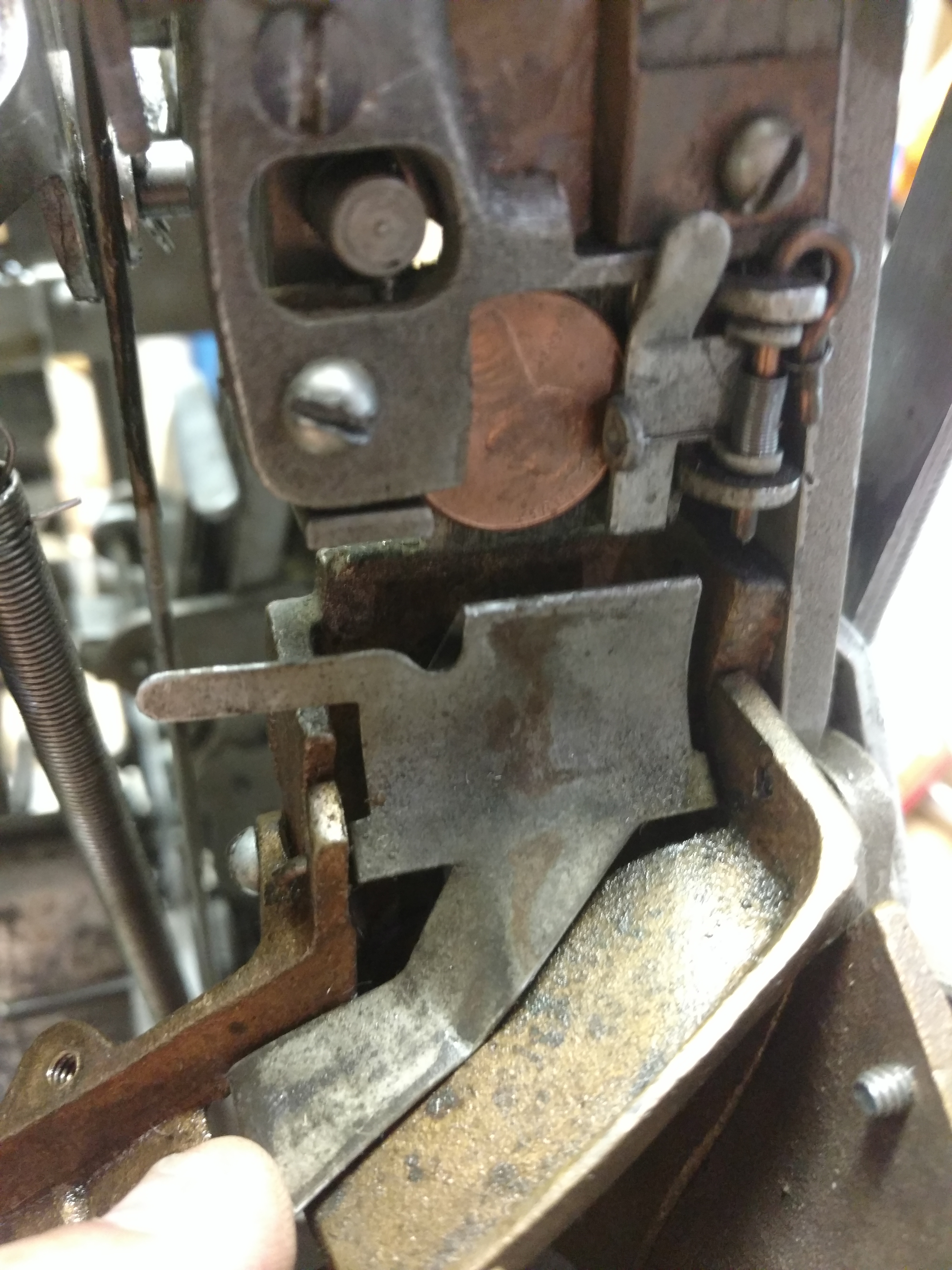

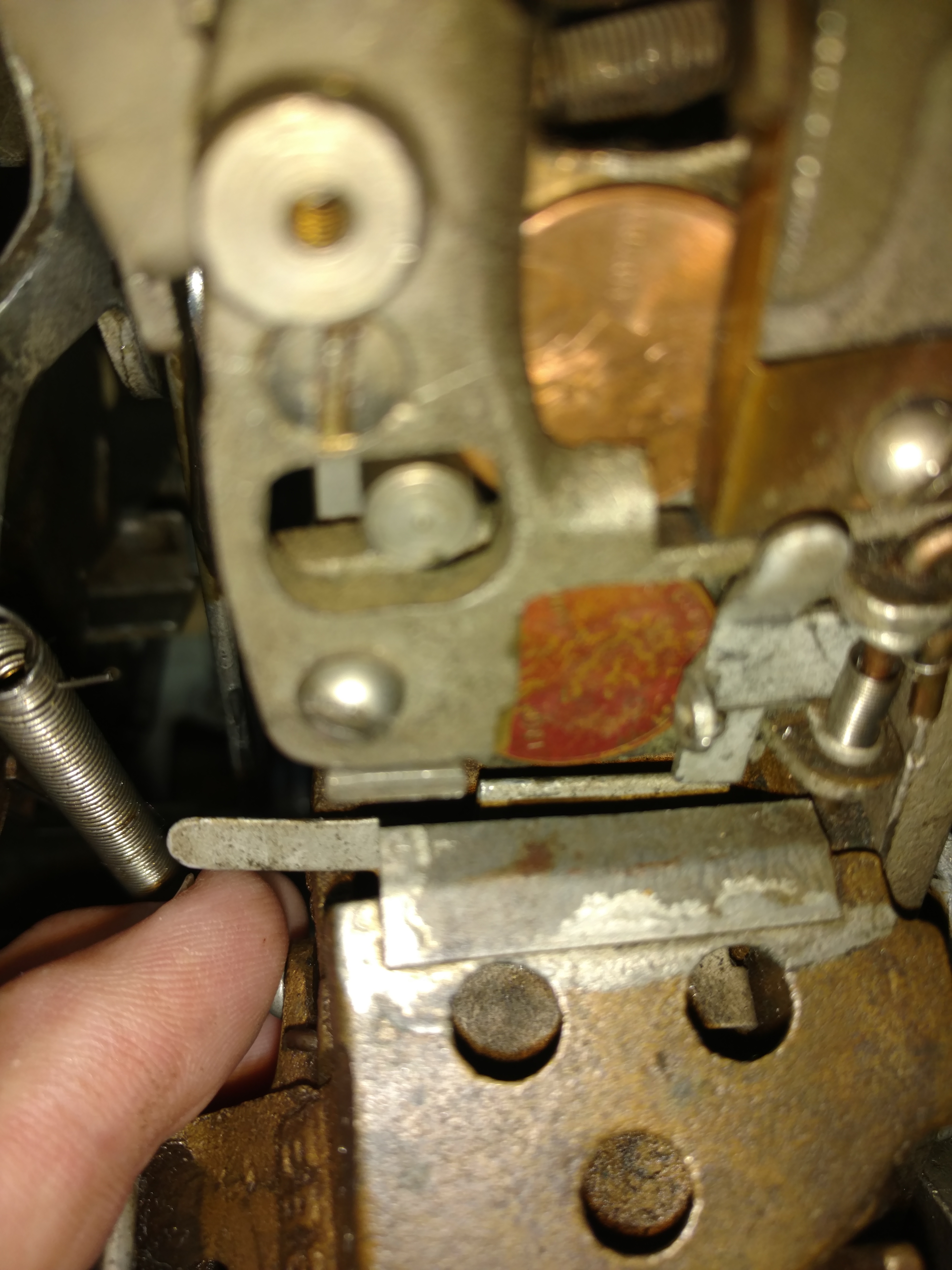

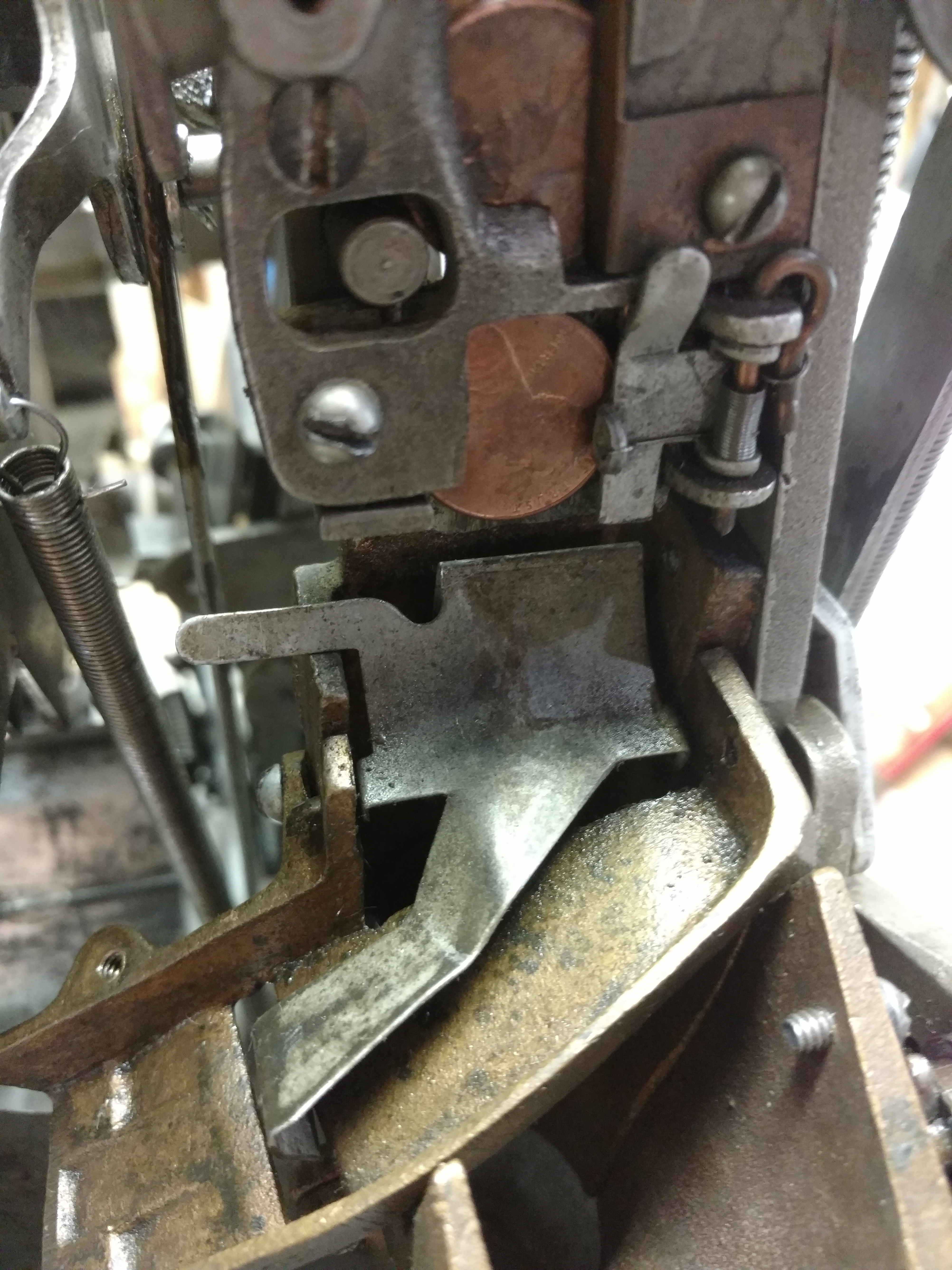

I have been working on several Little Dukes this summer and have a problem with an early machine. Serial 3347, small coin head, pre timing rod mech. There is a weighted tin flap (in front bronze area) that either deflects the penny into the coin tube or to the coin box. On this machine it is only sending coins to the coin box. It has several bends so if someone has a similar machine I would appreciate a photo or two to see if this one is bent incorrectly. I've included a few photos for reference and photo #2 is where it rests all of the time (photo #1 would send the coins to the coin tube). Thanks!
