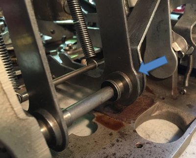

Found the problem but not the solution. However, see attached photo. The #2 reel stop flares out at the bottom (see arrow) while the #1 reel stop does not. Wondering if the #1 and #2 got swapped at some point - does anyone know if the flared reel stop should actually be in the #1 position?
Shane
