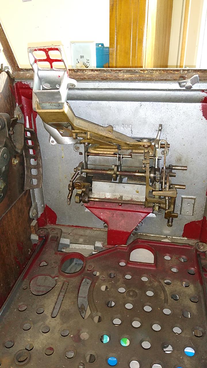

I'm working on a Watling Blue Seal Torch Front for a new friend.
Please take a look at the pictures and tell me what's missing?
I don't see how that coin divert tube gets attached to the mech on the upper end. I see where it attaches to the mech base but can't figure out how to secure it on the other end.

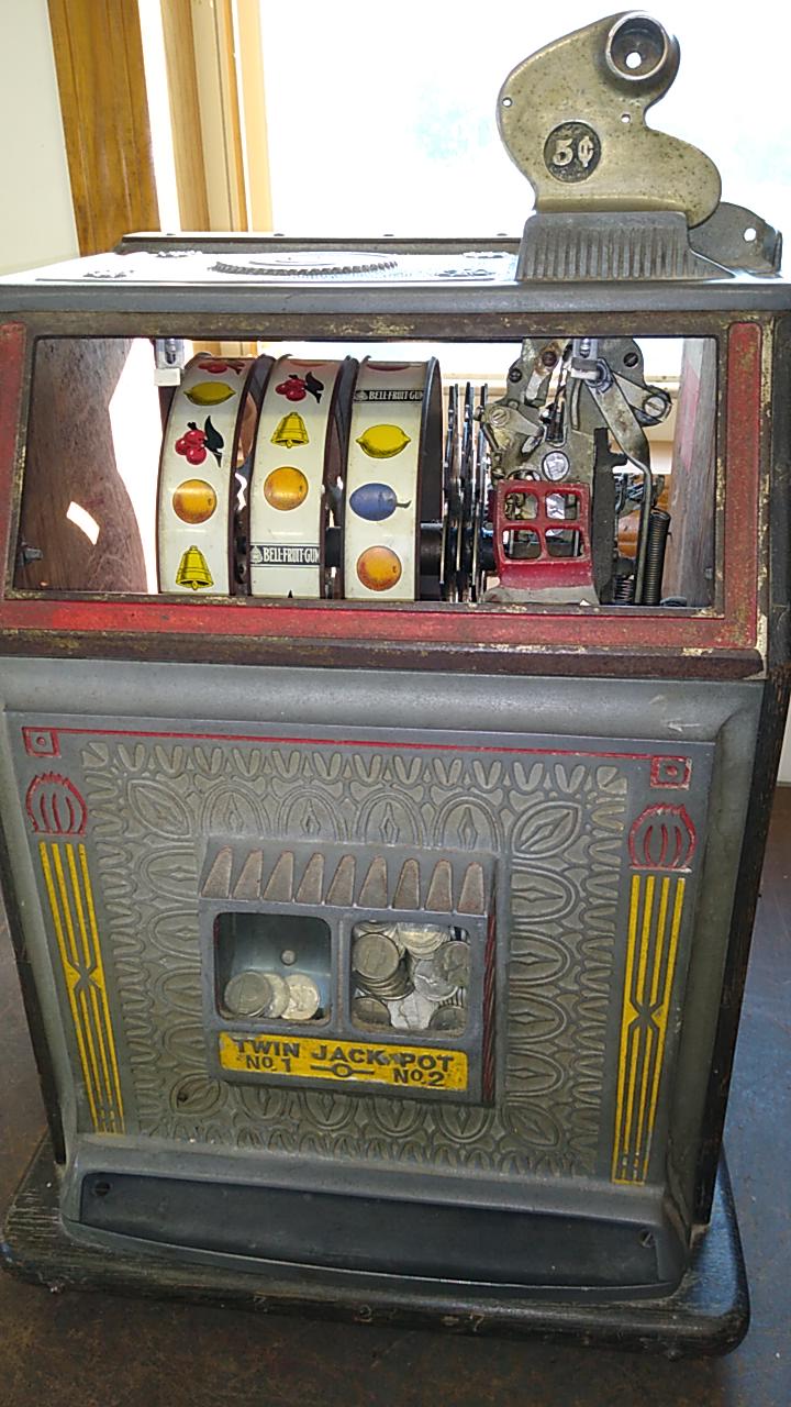

Not sure but it could be the wrong coin ramp assembly?
The photo below is from a recent Blue Seal that came thru my shop!

Re: Watling Blue Seal Torch Front mech question
Postby Rick-okc » Wed Nov 06, 2019 9:43 am
Thanks Monti. I'm starting to think the same thing.
I may have to come up with a modification to make this part work.

Rick-
I have an original chute if you need it. Robert

Postby Rick-okc » Wed Nov 06, 2019 11:53 am
Thanks Robert. I think I'll take it. I also am looking for the cash box and cover that goes behind the coin entry.
