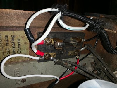

Postby kepmr » Sun Dec 08, 2019 4:22 pm
Can anyone post a picture of how the 110 power gets hooked up to the terminals.
Thanks Ken

The machine I got was not safely wired, so I redid it with new wire and used the following flow. Bring the hot side of 110 to the top of the fuse. From the bottom of the fuse, go to the master on/off switch. From the other side of this go to the base of the lamps and the play microswitch. The other side of the microswitch then goes back to the terminal block to the hot side of the motor. The neutral sides of both the motor and the lamps go to the left over terminal, which in turn is connected to the neutral side of the 110 line. Picture attached. Jim
Jennings Terminal Block
