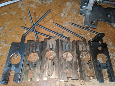

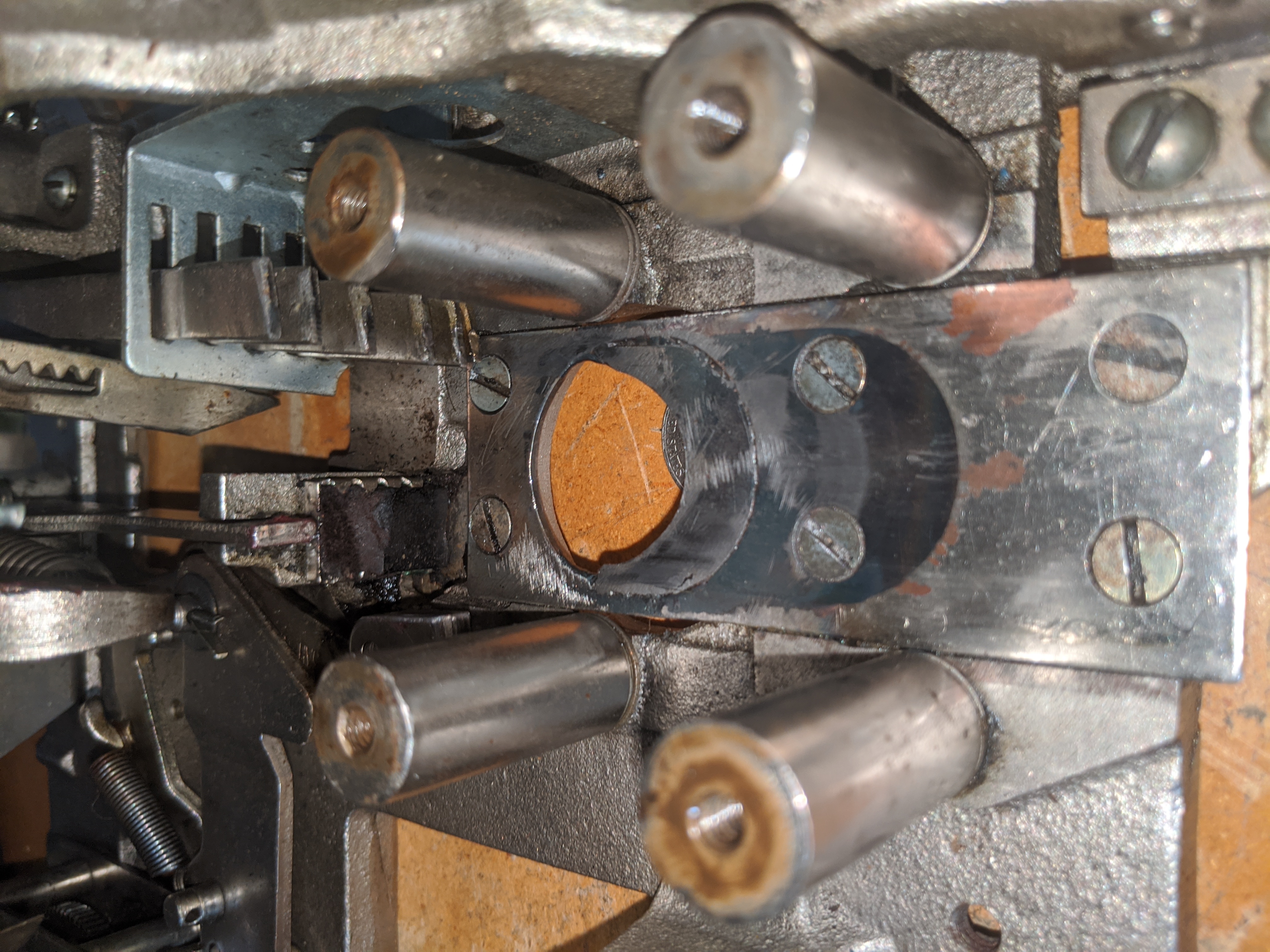

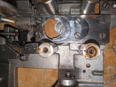

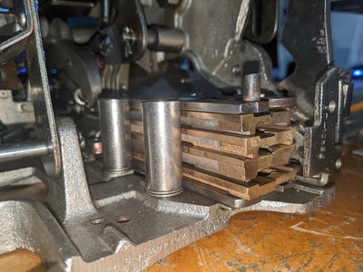

Thanks for your reply. The leather piece is pretty warn so I will look into that also. I have attached some pics of the slides. This is a Frankenstein mech I am afraid. There is no safety slide. If possible, check out my photos and let me know what you think of the slide situation or if you think it stil is the leather piece.

I believe you have to clean up that hole and make it round to match the payout slides. The coin are most likely not dropping out cleanly like they should. That piece that is screwed in there is taking the place of the safety slide.
Re: Mills hightop payout issues
Postby mechanic » Fri Jan 17, 2020 10:49 am
Just putting my 2 cents in on this. It looked weird that the slide posts were oversize so checked the rest of the pics and noticed a part with Sega numbers on it. This could be another problem someone tried to convert it from foreign coin to american which would explain the shims on the bottom of the posts. If there is a stationary plate attached to the bottom of the casting that the slides sit on then it's the safety slide alternative. Check for more parts with the part numbers stamped on them, it will help determining if it just happened to have a Sega part added or it is a modified Sega mech.
