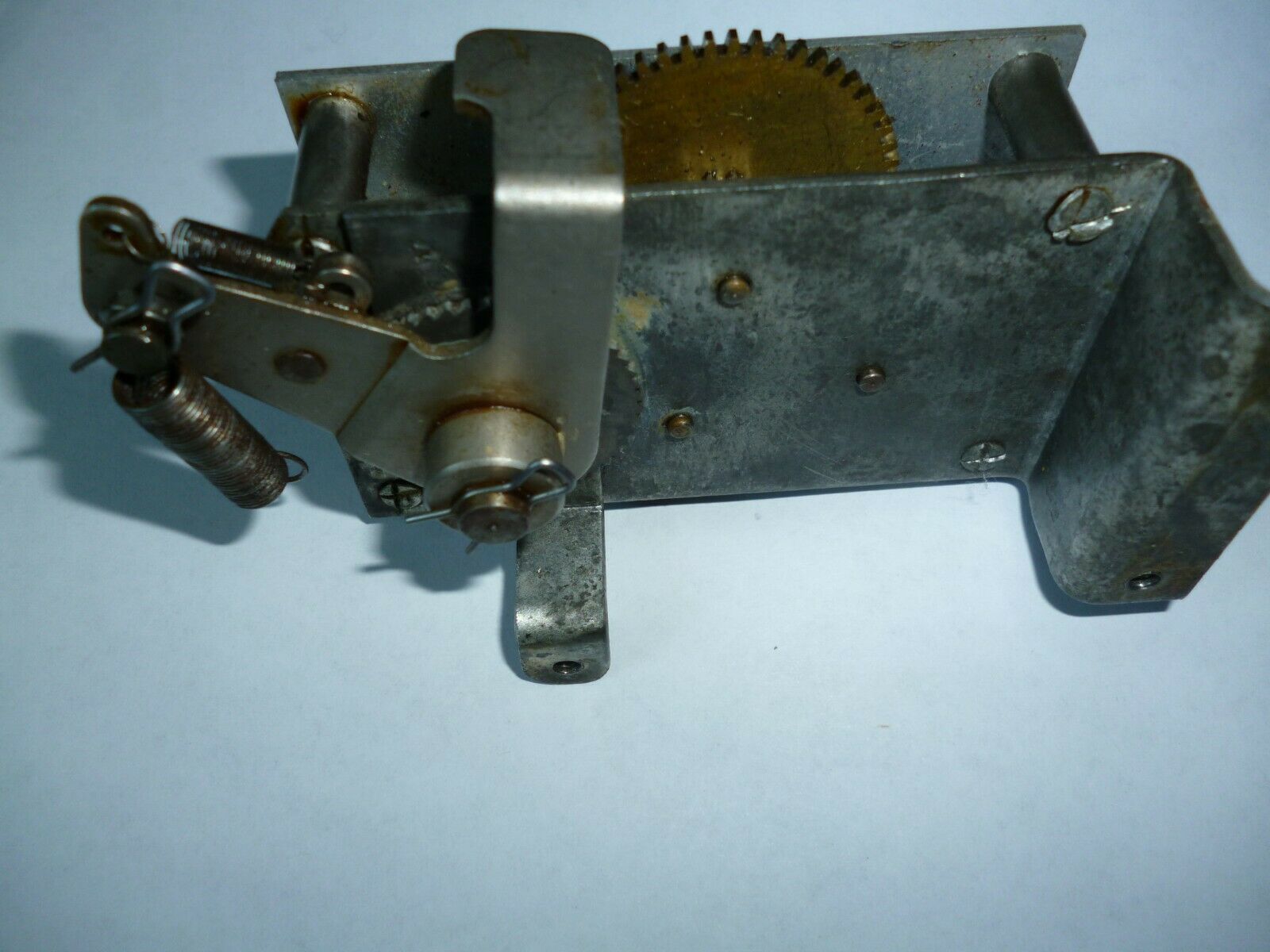

I am re-installing the clock on this machine and for the life of me I cannot find the spot to which the spring shown in the pic attaches. I thought I had taken a pic prior to removal but.... Any help would be greatly appreciated. Thanks Wayne

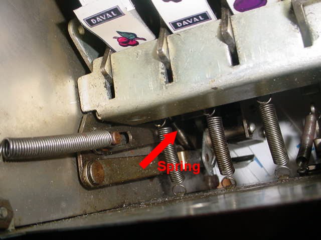

Here is a picture of my my spring hook up. It isn't an easy place to get a very good picture but I hope that this helps you some.

Many thanks Jerry-I think I can now see the connecting culprit! It certainly is in a tight spot-I will attempt the connection tomorrow.

Your pic Jerry gave me a sighting of approximately where the spring from the clock was to be connected. I then realised that with the clock installed it would be nay impossible (for me at least) to connect that spring at the mech end. So I removed the clock and got a clear sighting of the connecting point and after probably 15 mins using a long spring hook kindly sent to me by Dave Berten bingo Gusher is now fully working after, as I understand, about 30 years in limbo. Although the reels spin cleanly it seems that the brake in each case is a bit harsh and I assume that means the machine could do with a good internal clean, service and lube. I am very happy to get Gusher working Jerry so again thanks so much for providing that inspirational pic. Kind rgds Wayne :D
