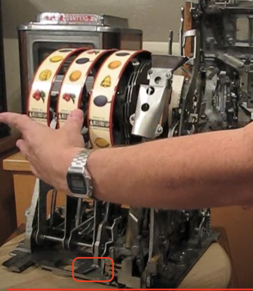

Postby oceanwolf » Tue Apr 28, 2020 5:43 pm
One end of the spring is attached to the base of the mechanics and the other end is free. I couldn't find a place to attach the end.
What is it for? Extra parts?

Postby oldslotman » Tue Apr 28, 2020 8:09 pm
It is for a fan stop lever which is most likely on your machine. Many were removed . They are not necessary for the operation of the machine.

Postby mechanic » Wed Apr 29, 2020 8:35 pm
YOUR FAN STOP LEVER IS MISSING. THERE ARE 3 OF THEM LISTED ON EBAY THIS WEEK.
