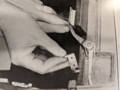

Postby flipper77 » Fri Jan 22, 2021 8:59 am
What is the function of this lever on top casting of Mills QT? Have had a number of QTs all with this lever but looking this morning and wondering - what does it do. Any comments much appreciated. Flip

Postby rtmccurdy » Fri Jan 22, 2021 9:52 am
It's a secondary lock lever to prevent prying into the front casting. Latches into a locking plate affixed to the casting. Activated by the lever on the front lock (if you have an original Mills front lock).

Postby flipper77 » Fri Jan 22, 2021 11:26 am
Thanks, you solved my mystery. Had to hold the lock up to see how it works. Appreciate the expertise.
