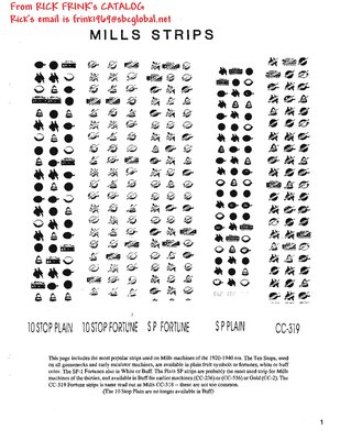

First I would assume that you have a ten stop reel bundle with ten stop discs and if not the reel bundle or discs have been changed which would make the process a little harder!
The "SP" usually stipulates Special Percentage as in your designation above!
If you do have a ten stop bundle then more than likely you would need a set similar to what is shown below on a page from Rick Frink's catalog!
Worst case if you know how to read your reel discs for proper comparison to the reel strips either used or needed that may be needed to do as well!
I would start by contacting Rick Frink at frink1969@sbcglobal.net

OK,
Yes, I have a 10 stop machine, the reel bundle on it has 20-symbols.
I am assuming (I hate assumptions) that I have a standard percentage machine.
No, I don't know how to read the payout disks, not with any precision.
I can't get Frink to respond to any of my emails.
And Dave Berten always seems to be a week or two behind in answering any inquiries.
So I feel stuck at this point.

Walter,
To determine the correct symbols for your reel strips, you should rotate each disc of the three 3 reel discs and see which upper payout fingers go through which holes, meaning does the first payout finger go through a hole in the disc (cherry) or the second payout finger (orange), or the 3rd payout finger (plum) or the 4th (bell) or the 5th (bar). Remember that a bar is winner for orange through bar (example: orange-orange-bar, etc.) You'll do one stop at a time. Obviously, since you have a 20 symbol, 10 stop machine, every other symbol is a non-winner, so could be any symbol, but hopefully, based on the winners (10 of the 20 stops), you'll be able to determine which of the reel strips that Dave or Rick sells is the correct one for you. It takes a little time, but then you write down each symbol for each reel strip for each of the 3 discs. Hope that makes sense.
mazzeosa17
Posts: 150
Re: Which reel strips?
Postby Walter Newton » Mon Apr 19, 2021 4:31 pm
mazzeosa17 wrote:Walter,
Yes it does.
I was hoping it was simpler, but I had an idea that's what I was going to have to do.
Thanks a bunch.
