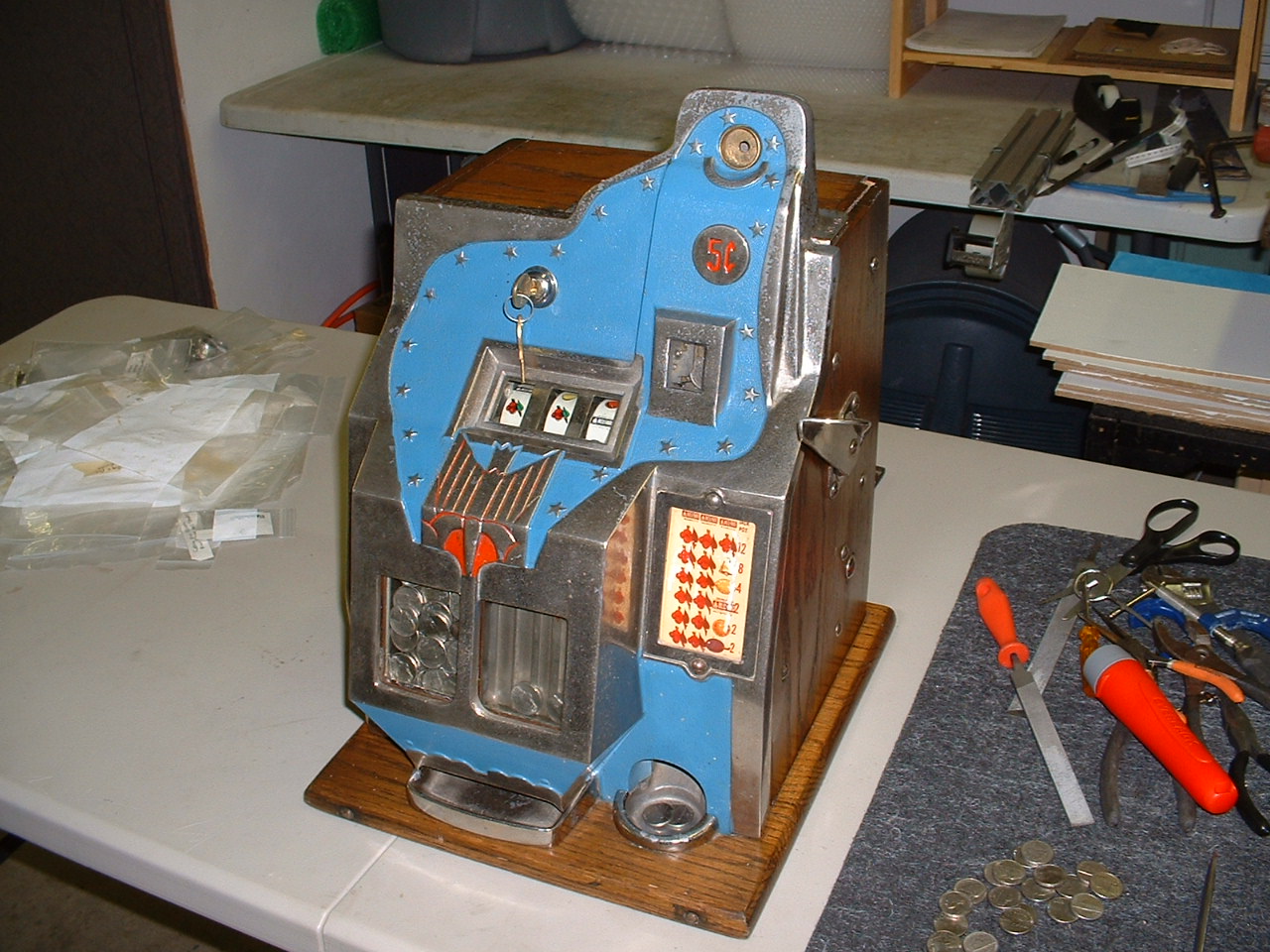

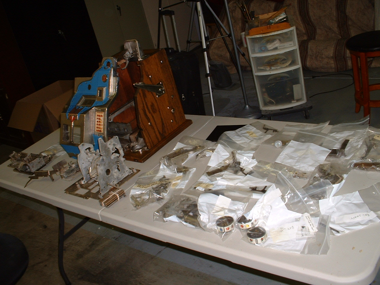

Trying to put together a Mills QT Firebird for a friend. Apparently it was completely dismantled many years ago and the parts were gathered into plastic bags, some labeled, some not. Never worked on one of these before so I'm way out of my depth putting this puzzle together... Will some kind soul with a QT in his collection remove the mech and post pictures of top, front, back and L-R sides to show as many parts in proper position as possible? I really need some clues! #-o Thanks in advance. [-o<

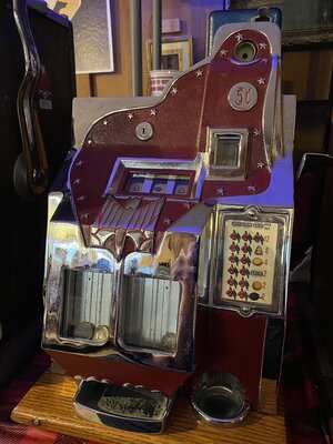

(Picture is just to "show off" the machine. I can post mech pics if needed)

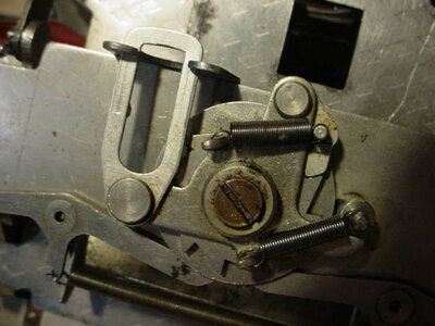

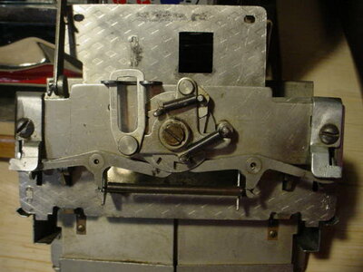

The jackpot opening sequence is dependent on a few things. First make sure the racket mechanism behind the jackpot has both springs as they occasionally pop off and the long spring as pictured. Second, make sure the ratchet mechanism functions as it should, rotating and engaging as it should (will necessitate removing the jackpot assembly) as this area is prone to be greased to the point that it eventually sticks. On occasion the jackpot base is bent also impeding the movement of the door that isn't releasing the coins. After cleaning you can easily manipulate the rectangular ring on top that is raised to release the jackpots making sure you close them after opening. After reinstalling make sure the jackpot activation lever is inside the rectangular ring. As always the Geddes and Saul Guide for the QT is a must if you are working on these.
