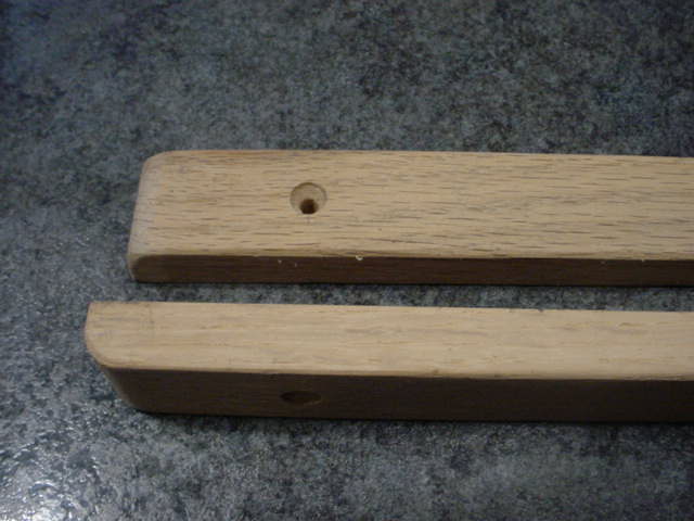

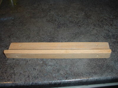

I don't have one to get the dimensions but if it's like this one I would make them 3/8"x 3/4" and about 1/2" shorter than the depth of the base. That way they are about 1/4" back from the edge of the base.

The set I have is 1 1/4 wide, 1/2 thick, and 14 1/2 long. Front setback from the base is 1/2 on my Hightop and same on a Gooseneck base. Made of Oak.
