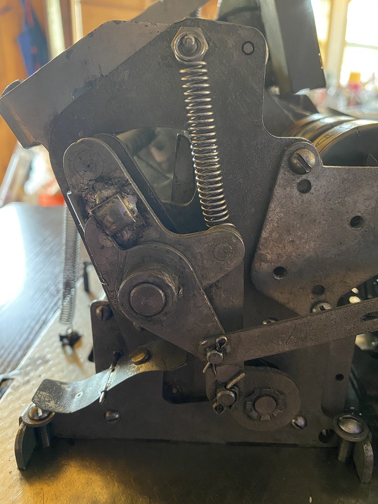

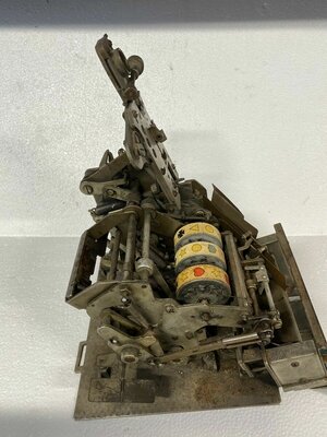

I have a nice Mills QT "Firebird" which works fine, except in one area. The jackpots do not fill evenly.
It appears (see picture below), that someone, in trying to replace what should be just a pin, welded a bolt head onto the linkage.
This is the linkage that advances the jackpot fill chute, from right to left, and so on.
Because this bolt head is 1/16 to 1/8 different than the pin that should be in that place, it moves the jackpot fill ratchet only about 2/3 of the distance that it should be moving.
So, I need the part (see below) that has the small pin on it.
I need just the part, but any other linkage is OK, as long as that one part is part of the set.
Pictures show what's going on and you can see the linkage part I need.
I'm willing to pay a good price.

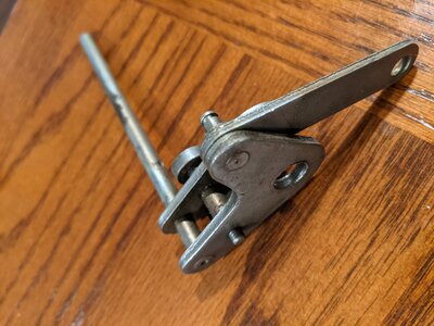

Is this what you need? $35 plus $4.95 shipping. Message me for email, etc. Thanks, Robert
